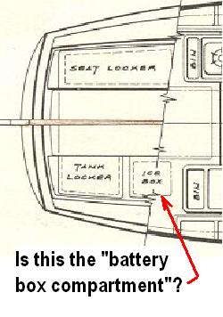

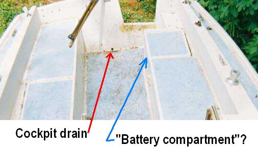

There were 3 different 23' O'DAYs built during the 1970s, the TEMPEST (1970) ,the original O'DAY 23 (1971-74) and the second O'DAY 23 (1977-85). Only the Tempest had a "stern deck" under which was the outboard well. That deck was flush with the top of the hull so any water on that deck would just run off over the side of the boat and not puddle.
The 1st version of the O'DAY 23 (1971-74) sort-of sounds closest to your description, so I will assume that is what you have.
The cockpit drain appears to have been just a tube through the transom, perhaps the owner of a 1971-74 23 can elaborate on that. There was no flapper over it originally, but it looks too small to really need one to prevent water from surging in. Even if there was a flapper, that will not stop water from flowing in if the drain were to be below the waterline for any reason. A flapper would also interfere with the lower rudder gudgeon. It is possible that there is a crack in that tube allowing water to leak into the bilge, or if the tube was metal it may have corroded through over the years.
If water is leaking in through that tube, it could find it's way forward to the cabin depending on how level the boat is on the trailer. There is no drain in the cabin, it would be below the waterline when the boat is in the water and so would not drain out, only in. There is no forward anchor locker, so that drain isn't causing your leak (anchor well was only on 1977-85 models).
If you boat is an early (1971-72) pop-top, rain can/will leak in around the mast, since your boat is hauled out and I assume the mast is unstepped, if your boat is that model, there is presently a big hole in the cabin top that will be letting in rain.

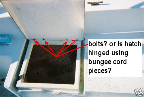

As Indysailer mentions, I'd check all deck fittings for leaks, the only way water could be getting into that compartment near the stern that apparently holds your battery would be either a crack in the area around the hatch or if the hinges are leaking through their boltholes.
One more thing, looking at a pic of that hatch, does it have hinges? Or did O'DAY use a pair of bungee cords threaded thru holes in the hatch (and deck) to hinge the hatch? My DS II has a built-in "ice-box in the cockpit and the "hinge" for the hatch is made of bungee cords, it used to leak in a heavy rain until I added a strip of gasket-tape (self-adhesive weather strip) above the holes. Anyway, see pics below.

My O'Day has a sunken stern deck, there is a drain hole at the bottom and it used to drain, now the water just gathers on the deck and stands there. There are seats on either side with storage units, ice box, etc. The one storage area was used by the previous owner as a battery storage area.
The hinges are brass note bungee cords to the storage units.

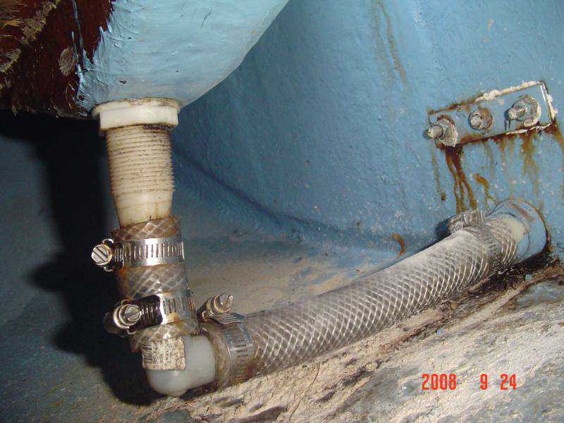

I''m still not sure what year your boat is, but am not sure it makes a difference for the drain. The drain on mine (a 1980) was clogged today and I ran a bottle cleaner into it and pushed out a bunch of leaves. If you really want to make sure that drain is all right, climb under the cockpit, remove the hose and check it. Inspect the hose and the through hull fitting that connects it to the basin.

Robert, do you mean to say that water is collecting at the aft end of your cockpit footwell? I think you said your boat was a 1978 or 79?
The only drain for the cockpit is at the aft end of the footwell and as Indysailer advises, is that isn't draining.....it will need to be cleaned out, but first make sure that nothing is split or cracked (hose and 2 thru-hulls).

The diagram and the pictures look about right. The battery box or ice box is in the right place as in the drawing. Even with hatch closed; it has metal hinges not bungee cord, it fills up with water. The aft deck fills up with water when it rains and won't drain. I will try and remove the hoses and see if that is the problem. One local boat owner suggested using a shop vac and suck it out.
