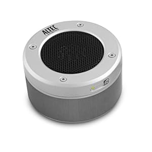

I agree with GWilliston, we have an Altec Lansing that comes in a zipper case, a strap that could secure it to something up by the mast and it is inexpensive... $25 and less.
It uses 3 AAA batteries and last 24 hours with excellent sound. It is capable of being very loud without any distortion that I noticed. It compares in sound quality to my Bose DS, it is that good.
