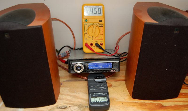

Walt,
I know you're an EE and I respect that. My only credentials are that I have been an audiophile for years and done a fair amount of recording and live sound stuff as well. I also spent a couple of winters, while at college, installing car audio systems (well before "thumpin' bass"). I know none of this makes me an EE but what you said is counter intuitive to what I've both seen, read and understood about power amplifications and 4/8 ohm loads.
Rather than argue the point I performed a very "real world" test because what you said, 8 ohm speakers will consume less battery power, has always been the opposite of what I have known to be true.
I used a Trojan deep cycle battery on a charger connected through my multimeter to the stereo set to monitor DC amps. For the test I used two different pairs of speakers a set of KEF 8 Ohm and a set of Symphony 4 ohm speakers. KEF's have always been notorious for being inefficient in terms of SPL ratings and that shows to be true and you can find more efficient 8 ohm speakers but it still does not change the outcome a whole lot. Both speakers were bookshelf type speakers I had kicking around the barn. If I had to guess I'd say the KEF's are about an 87db efficient rated speaker and the Symphony's are about a 92db efficient speaker. Regardless of efficiency the 8 ohm speakers use more power at the same exact volume setting and the meter is impartial.
The source audio, to be fair and consistent, was a white noise audio test CD that puts out a constant volume and is used to set up home or professional audio systems. Because this is a fixed frequency test CD the power output requirements remain level and constant, unlike a music CD where the volume and amp requirements are constantly changing. Along with measuring DC amps I also measured the sound pressure level with my SPL meter that I use to set up and balance my home theater system.

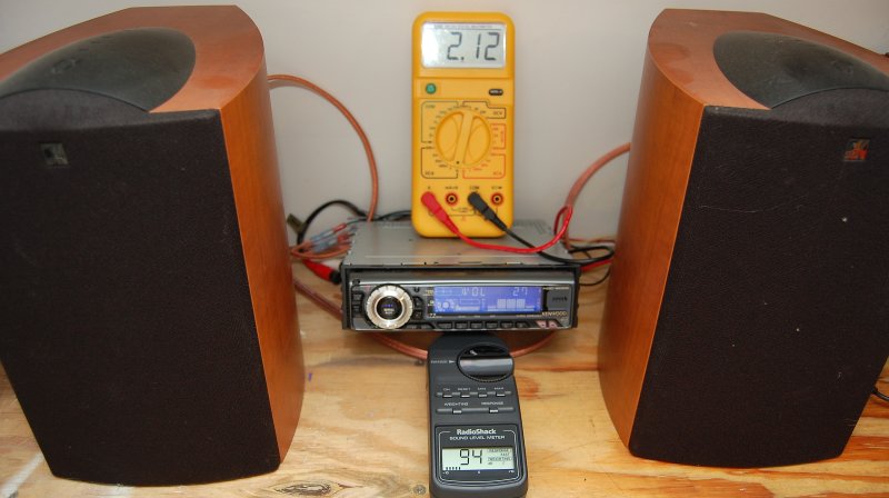

Below are two very simple photos.
In this first photo the Kenwood stereo is powering the set or 4 ohm rated speakers and the volume is set to 27 the power consumed at volume 27 is 1.62 amps and the SPL meter reads 103db. The SPL was hoovering between 103 & 102 (mostly 102) so to be fair I'll call it 102db not 103db..
In this second photo the Kenwood stereo is powering the set of KEF 8 ohm rated speakers and the volume is also set to 27. The power consumed at volume 27 is 2.12 amps. The SPL meter reads 94 db but to be fair it was hoovering between 95 and 94 (mostly 95) and I happened to catch it at 94. I think it is fair to call it 95db. It should be noted that this is NOT an ideal location for an SPL meter but it was in the same location for both sets of speakers. Unfortunately to catch it all with the camera it needed to be where it was..
At the same volume setting the 8 ohm speakers produced less volume output and consumed roughly 131% more current than the 4 ohm speakers did. While all speakers will be slightly different it is safe to say that 8 ohm speakers will draw more current than a comparable set of 4 ohm speakers.
The meters are 100% impartial (that's why I used an SPL meter because my ears, while fairly good, can't determine a 1db difference in output volume. All things were tested exactly equal at a steady voltage input and the same stereo volume setting and test tone CD....
As I said before, and I stand by it, car stereos on boats will consume less power using 4 ohm rated speakers and will also play a little louder.
Lets assume that your personal volume comfort volume level is 102db. With the Symphony 4 ohm speakers I used you would consume 1.62 amps to achieve 102db, as in the photo above. If you wanted to achieve the same listening level of 102db with the 8 ohm KEF speakers it would require 4.58 amps (I caught it at 101 but it was bouncing between 101 & 102 the meter is very sensitive) !!!!!!!!!!!!!!!!!!!!:doh::doh::doh:
Is it safe to use 8 ohm speakers with a car stereo? It probably won't hurt it any but it certainly won't save any amp hours..
