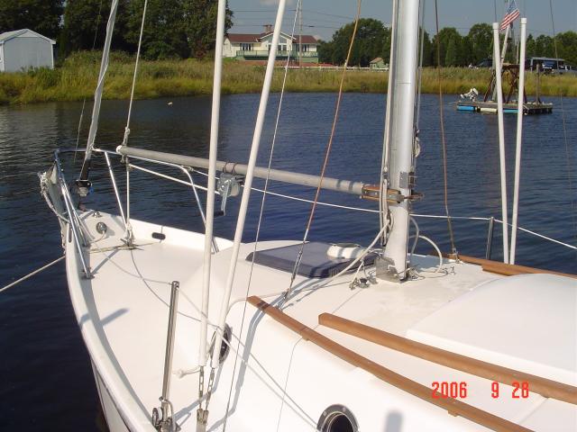

I have an ODay 25 and would like to know how to prevent the boom from flopping over to the side while raising and lowering the mast. I saw a picture in the manual that shows two plates attached to the shrouds but I do not have those. Does anyone have a better way? I would like to do this with my wife helping me. I would appreciate any input.
Hi Steve,
I would suggest that you install two pad eyes on your deck, one on each side for pivot bridles as I have done. One side of the pivot bridles can hook on to these pad eyes, and you'll need to put a small stainless steel shackle in between the toggles of your side stay turnbuckles on each side of your boat for the second connection of the pivot bridles.
Pivot bridles are "Y" shaped and they consist of 1/4" braid with a large stainless steel ring in the center, and snap hooks. These items can be purchased at any hardware store or Lowe's.
The stainless steel ring wants to come even with the pivot point of your mast Tabernacle. Then you need to make up two even bridles to go from the end of your boom to the rings on the pivot bridles. This is what keeps the boom straight. I would even go a step further and build a mast yoke out of wood that can be clamped to your mast within reaching distance, and run a set of temporary stays(baby stays) from small eye bolts on each side of the mast yoke, to the pivot bridle rings.
As far as installing the pad eyes go; it going to take some careful planning to get them in the right place. When I first installed my pad eyes to my deck, I screwed up and didn't place them far enough out from the centerline of my mast in relation to the small shackles connected to my turnbuckle toggles on both sides. Consequently what happened was, one side of my pivot bridles is longer than the other side. It still worked, but I had to remember that the short ropes on my pivot bridles needed to go on the pad eyes in order for the rings to come right. I relocated my pad eyes last year and even though I had to re drill holes and fill the other holes, I feel it was worth it because I want it to be right. You want the pivot bridles to be even. That way, there's never any guess work about which way they have to go.
What you can probably do right now is make up a set of bridles out of rope to go from the end of your boom to connect into the top of your turnbuckles on each side which are closest to the bow of your boat and more in line aftwartships to your mast. Jeff, one of our yacht club members who has an O'Day 25 without triangular plates on his stays, does this and it seems to work for him. You may need to loosen or disconnect the other two stays, I'm not certain. Check your mast raising directions for more info on that. What really complicates this whole procedure is the furler. You need someone to hold and guide it with the mast as it goes up or down. Always have the wind coming directly from the bow when you raise/lower from the bow and make sure that the boat is level. A wind coming from the side could blow the mast over.
Personally, I don't like raising a mast from the bow. I've been raising my mast from the stern for many years now. Today I use a stainless steel Gin Pole to raise the mast with my furler connected, and I do this all by myself. A temporary mast crutch is needed on the stern rail in order to support the mast and allow you to pin the Tabernacle. The wind needs to be coming directly from the stern and the boat needs to be level.
If you need pics and info on this, send me an email and I'll be glad to get them to you. sailtrinkka1986@verizon.net All I know is, Jeff is able to raise/lower his mast on his OD 25 by connecting the boom bridles to the tops of his turnbuckles. I've seen him do it last year. He says that the mast kind of binds a little when it goes up and he needs to lift it a little by hand to get it started. This is probably because the pivot point at the turnbuckles is a little off center, but it works.
The mast yoke that you can build to hold your temporary stays can be a very simple construction of wood to fit the mast nice and snug using a bolt and wing nut to make it tighter. It doesn't have to be as fancy as mine.

If you have these triangular plates on your boat, you're in like Flynn. It's true that when you connect your main sheet to the boom and put some tension on it, the boom will straighten out, but the bridles that attach to your plates from the end of the boom will give your mast a little more lateral stability when it's being raised/lowered. I would suggest that if you want more lateral stability in your mast raising, that you build a mast yoke with eye bolts attached to it, and add a bridle to each of the eye bolts to your triangular plates. This would really make that mast stable. The MacGregor people have been setting their boats up with baby stay attachments for years. Only, the decks on the Macs are flat and are even with the mast Tabernacle. So consequently they can get by with just one attachment plate on each side of the boat for the baby stays. Pivot bridles are not needed. For the mast attachment, the Mac people are using a bent tang on each side of the mast held in place with a 3/8" bolt which is within reaching distance. Not something I'd want to install on my mast, but it works for their boats. I have internal halyards on my mast and I think I'll stick with my mast yoke for attaching the baby stays. Here's a site that will give you fellows a better understanding of mast raising and pivot bridle set up. Check it out.
http://slowflight.net/upgrades/tips-GinPole.html This fellow's mast attachment for his baby stays involves using the Main Halyard and a quick link in the sail track. I used this idea up to this year and it works, but it's too much of a hassle to mess with halyards. I used a regular metal bail type sail slide in place of the quick link. My friend Wayne on the other hand, built his mast yoke out of a combination of wood and metal with a bolt with a round knob to make it tighter, and it works just great. These are pics I took of Wayne's mast raising rig compliments of my friend Wayne. When I first saw him raise his mast at the club dock with the furler attached to the Gin Pole, all by himself, it just blew my mind. I made up my mind right then and there that now I can have a roller furler on my boat and be able to raise my mast by myself too. Wayne uses a small boat winch to raise his mast and I use my boom vang with a longer line on it.

If you decide to go with the pad eyes, take your time and test out your theories before you drill any holes in your deck. What I did was make up my bridles first by making the ropes of equal length to the rings, and making sure that the Rings came even with the pivot point in the mast. Then I clipped one of the snaps into the small shackle that I inserted between the lowest toggle in my turnbuckle. I took the other snap and connected it to the pad eye and stretched it out the way it would be with the bridle tension on it. Then I marked the deck with a pencil where the pad eye needed to go. It's a matter of just eye balling it and readjusting the ropes to get it right. In theory, if you were to stand athwartships to the centerline of the Port side of your boat with a plumb bob eying where the pivot point on your mast is in relation to your side deck, you'll come up with a centerline. If the distance from the centerline to the small shackle in the toggles is 12" toward the stern, the distance of your pad eye should be 12" from the centerline toward the bow.
I installed some small stainless steel back-up plates in the cabin for these pad eyes, but we really aren't talking about any real heavy strain that will be on them. The strain on the baby stays and the mast yoke wouldn't be any greater than having two of your crew grabbing hold of your mast to steady it as it goes up. These are just some of my thoughts and hopefully you'll get a better understanding of what is involved. Good luck with that and I look forward to seeing the pics when it's done.
