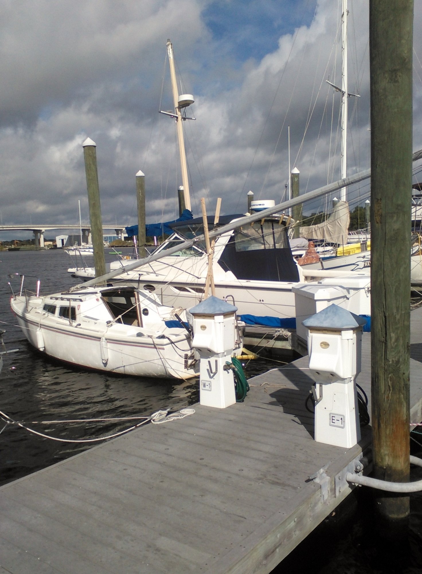

Took my mast down at dock to work on steaming light and mount a block on spreader for flag hoist, simple a frame style crutch made it easy to drop and raise
singlehanded ( I am 71 at time).
