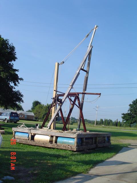

If the mast goes through the cabin and steps down below, I don't know if there is an easy way to step it without a few guys man handling it or to use some kind of a makeshift hoisting apparatus on a raft like we use at our yacht club for setting the pipes that hold our docks and lifting mooring blocks. The only other alternative is to have a crane at the boatyard lift and set it which probably goes anywhere between $75 and $100.
You may be able to Mickey Mouse something out of wood that is "U" shaped and be able to secure it temporarily on top of the cabin at the hole. Then have two guys standing on top of the cabin ready guide the mast up against the wood, while the other two guys are raising it from the cockpit. Someone could be pulling on the Jib Halyard on the ground, in line with the bow of the boat. These are just ideas and I'm sure you can come up with your own. Some guys are fortunate enough to get their boat anchored near a local bridge and be able to lower it down into the hole with one guy on board to guide it.
I set a mast years ago for a Bristol 22 that went through the cabin. I was using the A frame on our club raft. I used a short rope with a Bowline around the mast just under the spreaders with the other end tied to the winch hook. I didn't have quite enough height to get the mast straight into the hole, so we moved the boat ahead a couple of feet and got the mast started into the hole and we moved it back to get it the rest of the way. If you know of someone on the water who owns a similar rig, you can probably have them set the mast for you cheap.

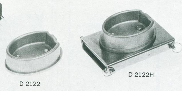

This sounds strange to me, the 23 had a hinged mast base of one type or other (I think there were 2 versions?). I think a previous owner may have changed this, perhaps he kept the boat on a mooring or in a slip and had the yard step/unstep the mast?
I'm wondering though whether the hinge is there? is that "egg-shaped" casting (a standard maststep) on top of a stainless-steel plate? Perhaps the you are missing the screws/rivets that secured the mast to the hinge base? Picture might help. But, whatever..... Rudy at D&R can set you up with the parts to replace the hinged mast base, or you could check with a local sparmaker. On the Web, check out DWYER Masts. I've added a picture from their catalog, it shows a maststep alone and the same part attached to the hinge plate.
