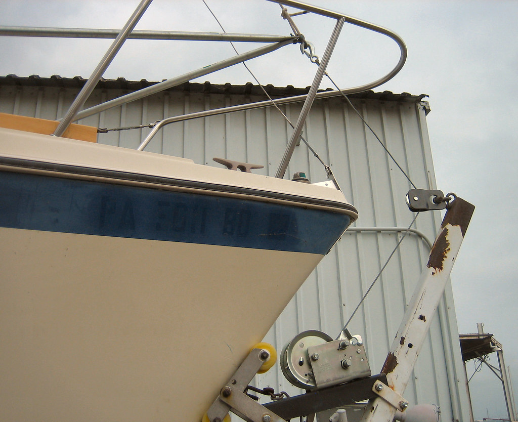

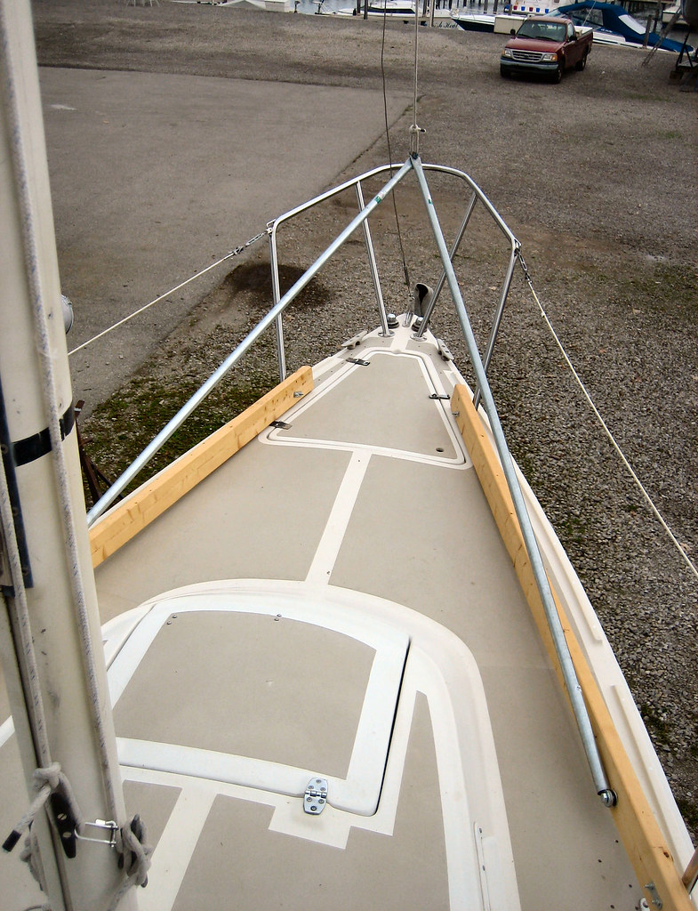

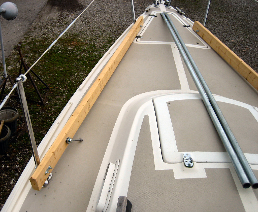

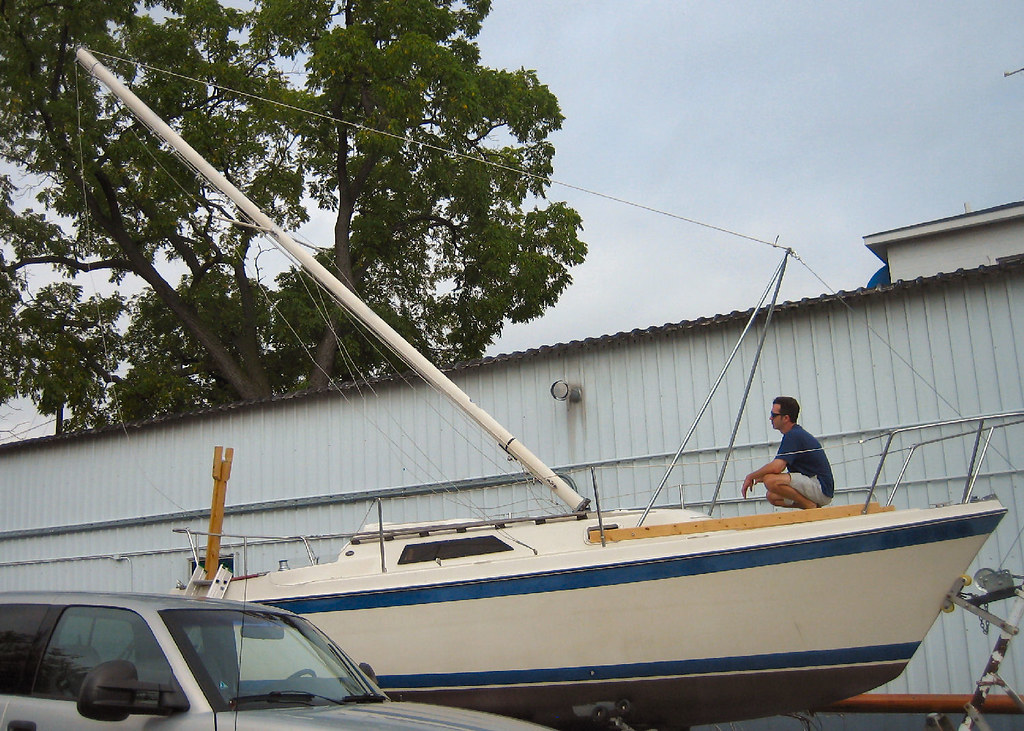

Here's what I do. Not fancy or finished but it works.
Tomorrow I'm going to see how it works with the boat in the water, using the primary winches.
