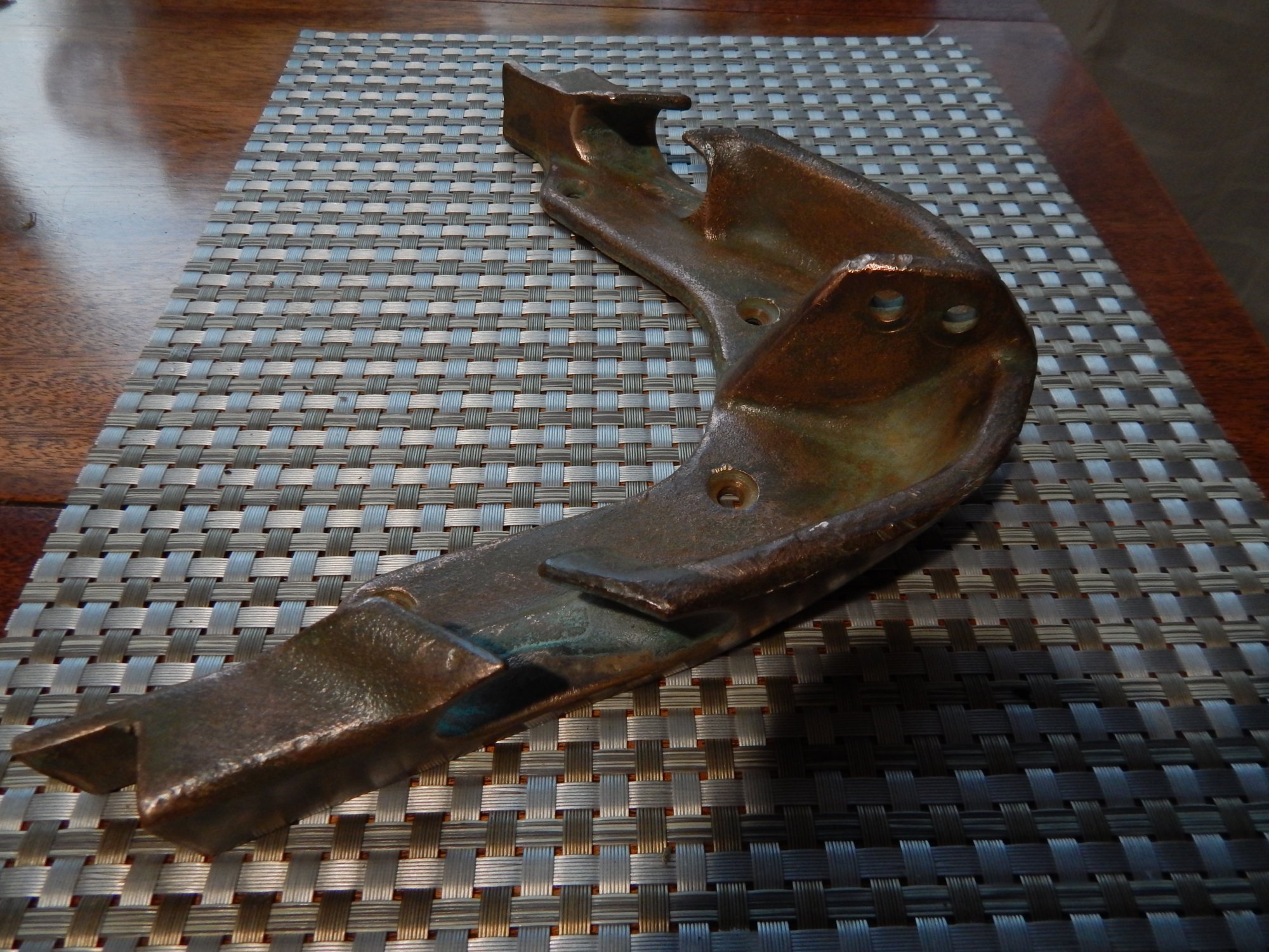

Recently I purchased the fittings shown in the pictures with this post. The first is surely a fitting for a Cape Dory Typhoon. I plan to use it to replace the worn stem fitting on the Typhoon we restored during the winter of 2020-2021. That fitting weighs about 4 pounds and is built just like the fitting on the 1972 CD Typhoon. The first fitting is about 10 inches wide and 3 inches along the centerline where the forestay attaches.

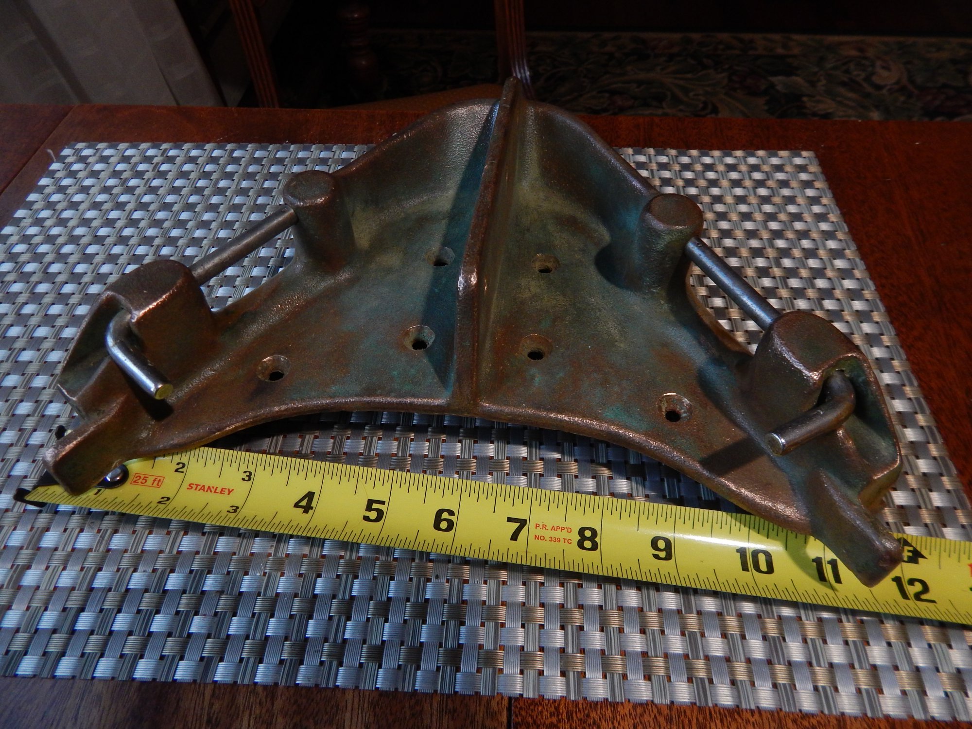

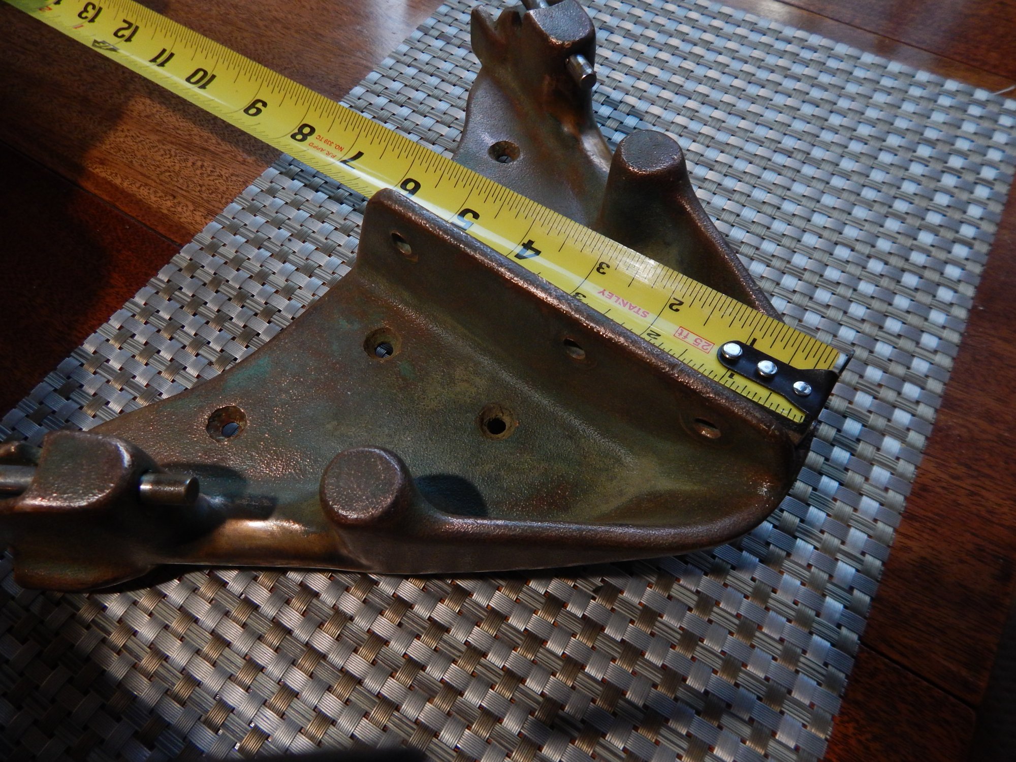

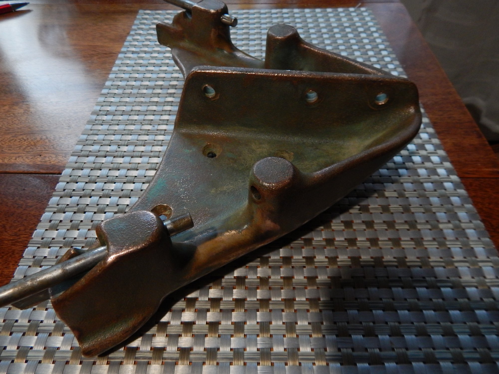

The second fitting is very robust (sort of built like a brick outhouse) and weighs about 9 pounds. I was told it also came from a Cape Dory Typhoon, but I would more easily believe it came from a different model Cape Dory (perhaps 22, 25, or larger) or from a different brand of sailboat. You can notice the sliding bars that capture the bow lines; you can see 6 holes for fasteners rather than 4 holes; there are 3 holes rather than 2 in the center attachment for the forestay; and the forward part of the fitting will extend down over the bow by about 3/4 of an inch.
Questions: (1) What brand and model sailboat would have a stem fitting like the second, more robust one? (2) Would it be likely that the stem fitting design for a Typhoon would have been changed to more robust over time? Our boat is HIN 345. (3) Do you think an owner-installed adaptation would account for the use of the second fitting on a CD Typhoon even though it was originally designed for a different boat?
