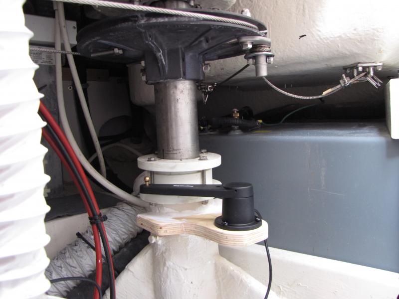

Hull 147 went through 3 iterations of rudder restraint over the first summer.
First was a central eyebolt/cable a padeye each side... pretty lame and the cable had too much slack and snagged. I never let the wheel go in reverse but anyone who might have would have caused severe damage
Second was a variation of this with repositioned padeyes and less slack.
Finally they did the glassed in wood blocks and central post.
One thing that I love about the 310 and 320 for that matter is the range of motion of the rudder. It was a pain working out the ratios so that the rudder position sensor didn't overtravel, but doing donuts in your own length is so worth it
