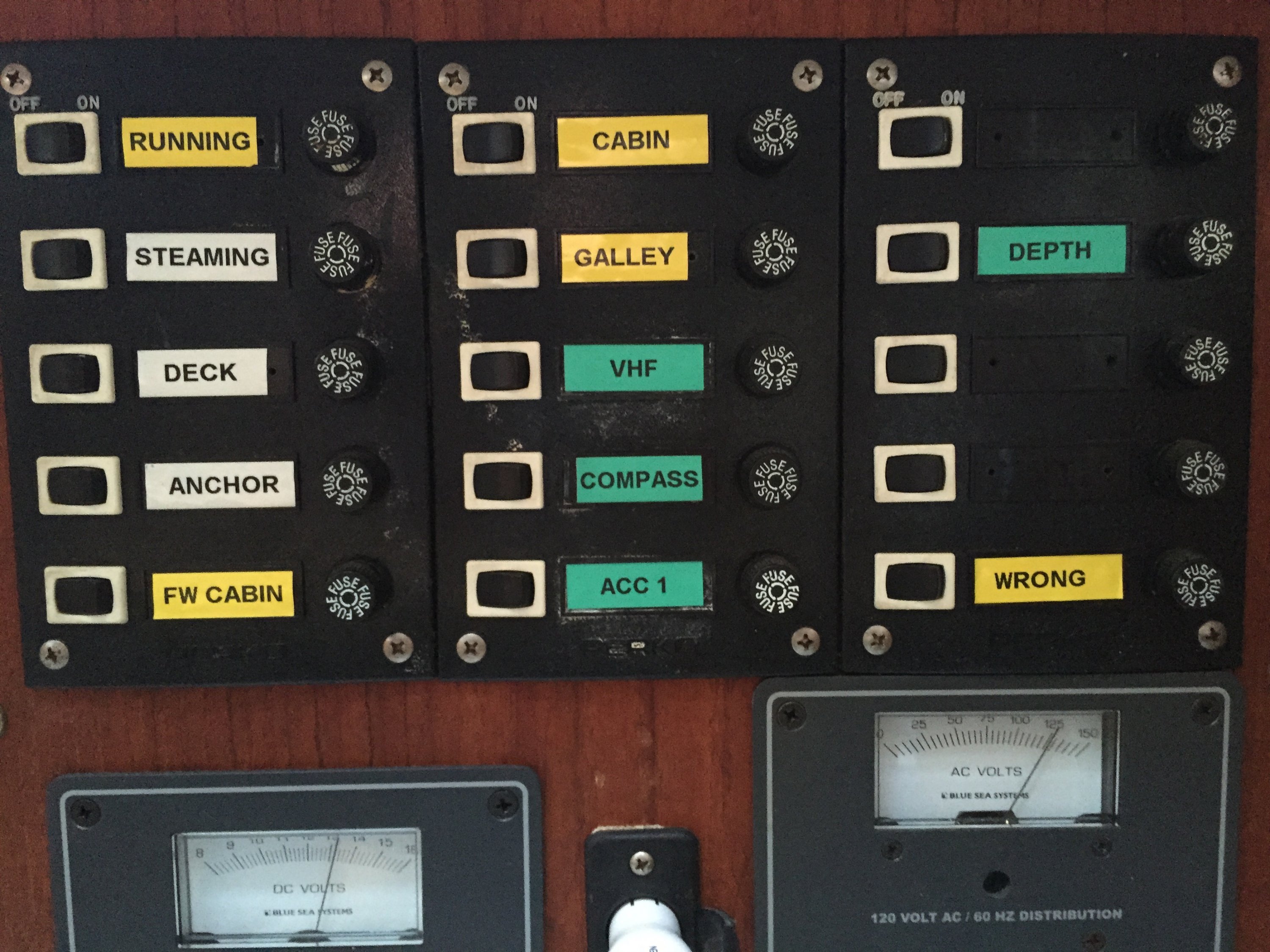

@Wes Gardner colour coding is a great idea. I'll steal that idea thank you very much. :)
I'm also very tempted to hit that "Wrong" switch.... hehe
A mischievous person would hook it up to a loud siren and wait for the unsuspecting "victim" to try it. :D So.... What's does it do ?
