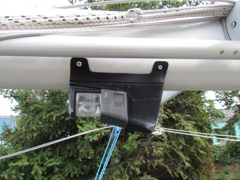

Is the Steaming Light/Deck Light combo unit standard on Catalina 310's?
Does anyone have the info on what light bulbs are needed so I can get the right bulbs before I head up that Bosun's Chair for the first time ever?
Any tips or things to know before I head up there to replace these two bulbs? Deck light has been out for a long time. Steaming light stopped working Saturday night?

Pretty common across the Catalina line, it's either a Perko or Hella depending on vintage, newer boats like the 310 use Hellas (mostly). The paperwork for the lights may be buried in your "Owners Manuals" (blue notebooks, really), if the PO didn't lose them.

I just replaced my deck and steaming bulbs with LEDs from Marinebeam and have the originals at hand. Albanach's links to the HELLA series 8505 specs are what I used to find the LED replacements.
The steaming incandescent is a 12V/10W 42mm festoon, Philips K25673. The replacement LED is Marinebeam, FS-42-30C CW, LED Festoon 42mm 30SMD Cool White 10-30VDC.
The deck incandescent is a Osram Decostar 51 S, 12V/20W 38 degree. The replacement LED is Marinebeam AL-MR16-03F WW, LED MR16 6SMD Warm WHite 120 Deg.
I also replaced the masthead anchor bulb. The incandescent is an Osram 5008 12V R10W 37R. The LED replacement is Bayonet BA 15 LED 15-SMD LED Bayonet mini-tower, base type BA15S single-contact, Cool White.
