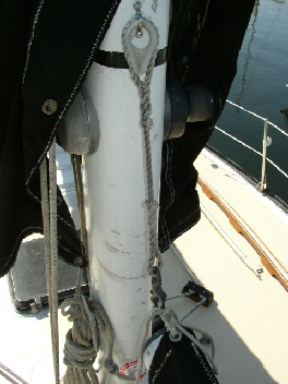

ed
you saw mine in the pix
I have the roller furling staysail on a cdi i can release the halyard lower it and use it to top up the staysail boom
