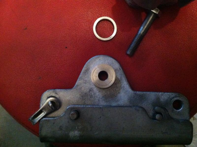

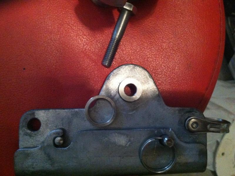

My staysail gooseneck had this play and it cause the hole in the part the attaches to the inner forestay to elongate. I had a machinist open the hole round again and create a stainless steel pressed in spacer to fix the elongation and the play between the parts.
I am in the process of repainting all these parts, along with booms and mast but I like the idea of nylon washers if the bolt hole hasn't elongated on your gooseneck.
I've attached some pictures of what I did.

I thought there was already a bushing in that hole. If not then adding one as mentioned above is a good idea. Plus the nylon washers.
