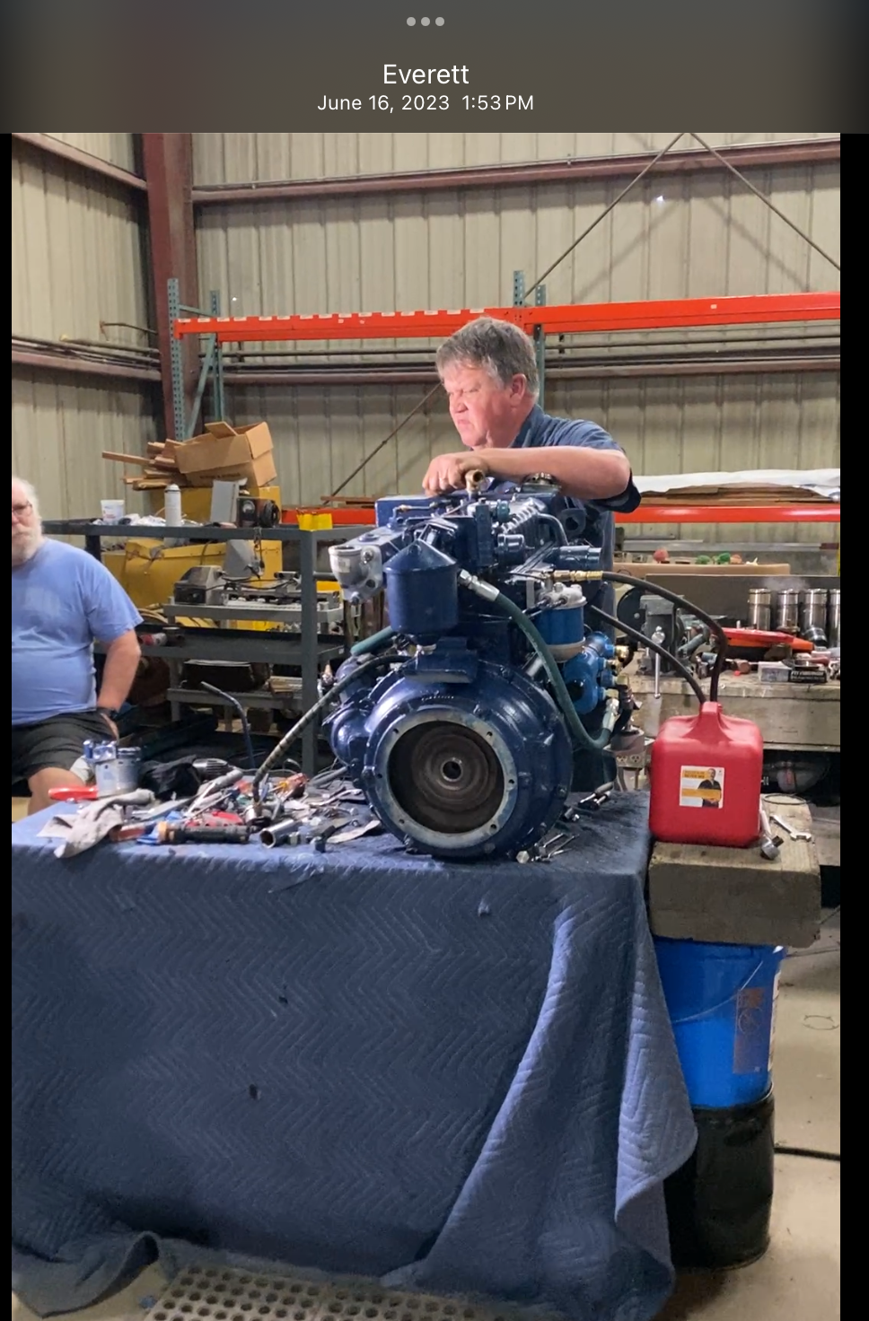

Here is the first fire of our rebuilt 1973 Perkins in the shop.
Battery connected: Positive to the Starter and negative to the engine block
Fuel hose into a gallon of diesel on the floor.
Took awhile to get the timing set. Once that was right there was a few puffs then Varoom.
Ran for less than 3 minutes.
Here is a picture of the engine sitting on the shop table.
Oil in the block. No coolant. Fuel tank attached. Engine started.

I have only one belt. I did not use coolant in the engine. Not run longe enough to create any heat.
We drained the oil before we installed the engine into the boat.
When we installed the engine in the boat is when we poured in the coolant and fresh oil into the engine. We also connected the alternator and installed the fan belt making sure we had a good alignment of the belt to the alternator. This took us about 30 minutes to assure.
I would check the raw water pump before you install engine. That was a hiccup in my install. The water pump failed as we drove the boat back to the slip. We had to replace the draw water pump.
