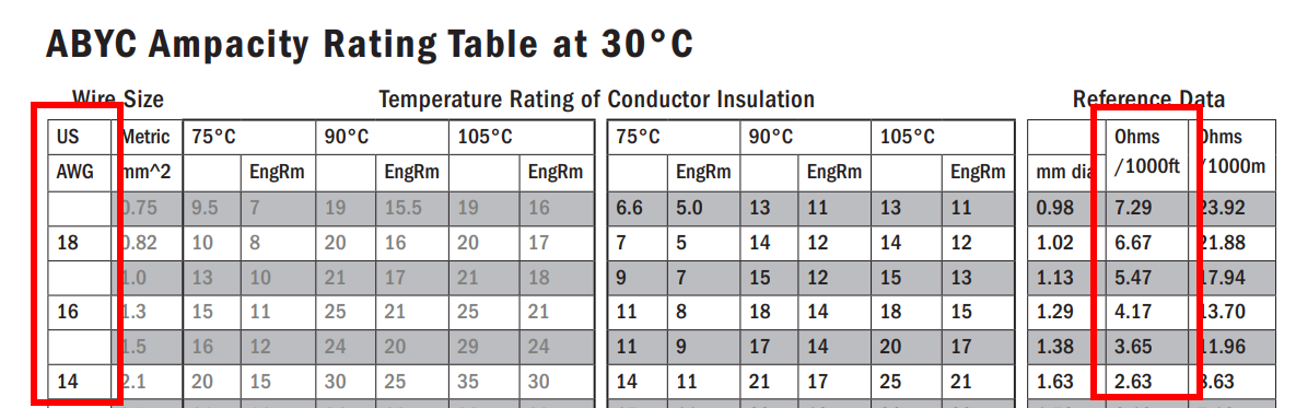

Do a calculation from the start using the length of wire to the starter motor (do not confuse this with the starter relay. That's a whole different story) from the battery and most important of all, the gauge of the wire. From that info, you can calculate the theoretical voltage drop and compare it to the actual voltage drop you are seeing. You DO NOT want to make a bunch of expensive alterations and finally find out you were barking up the wrong tree.
So far all you've got is "sort of, yeah abit, maybe dirty contacts, kinda pretty close" which doesn't tell you a thing which you can use.
Use these columns only for the resistance. Your wire to the starter motor should be down in the AWG #2 or lower :

it’s a good idea to calculate the wire resistance! The Victron can measure the starter current for me. Then I can calculate the expected voltage drop.

I did the math on the wiring loss. It should amount to about 1V. The wiring in the 356 is 00 according to the manual. I guess about 60’ of wire total + and ground. And a ballpark of 250A starting current. So, 6V drop is excessive. I’ll run through and check voltage drop at each access point along the cables. The boat is 23 years old, so there may be some corrosion or loose connection.
