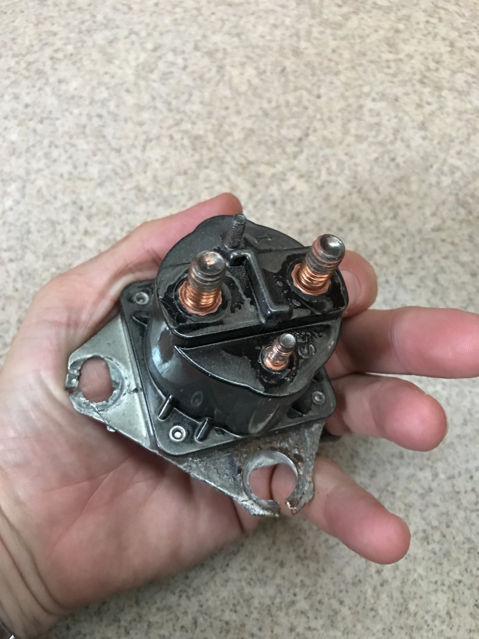

Can anyone help me work out what I should be purchasing to replace this. No visible markings on it. Trying to work out what sort of amperage capacity I should be looking for
4JH2E
I did speak to Mastry but they could not identify it and weren’t sure what to use instead.

So you have a yanmar engine. Do you have an engine manual? Does it show the starter motor? Is there a part number associated with the starter motor solenoid in the diagram? That’s how I found parts for my 1973 made Perkins engine.
That does not seem like an OEM part; it looks like an auxiliary relay installed by a PO. You may try something like this or look for an automobile relay. The Starter Solenoid For Yanmar 4jh2e is Part # 171008-77530 Magnetic Switch which mounts directly to the starter casing. The one shown is rated for 100 Amps.
