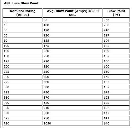

You are fusing for short circuit protection, not overload. ABYC actually allows fusing for short circuit to be 150% of the wires ampacity. In addition ANL fuses will handle a larger amount of current for their rating. See table below.
Knowing wire size would help. If you are using 2/0, which should be the smallest on a large starter I would think, it can handle 280 amps in engine spaces - 330 outside. A 275 amp ANL will handle 420 amps for 500 seconds (over 8 minutes) and a starter is only run for 10 or 15 seconds at a time. It will handle more than 420 amps for very short periods of time.

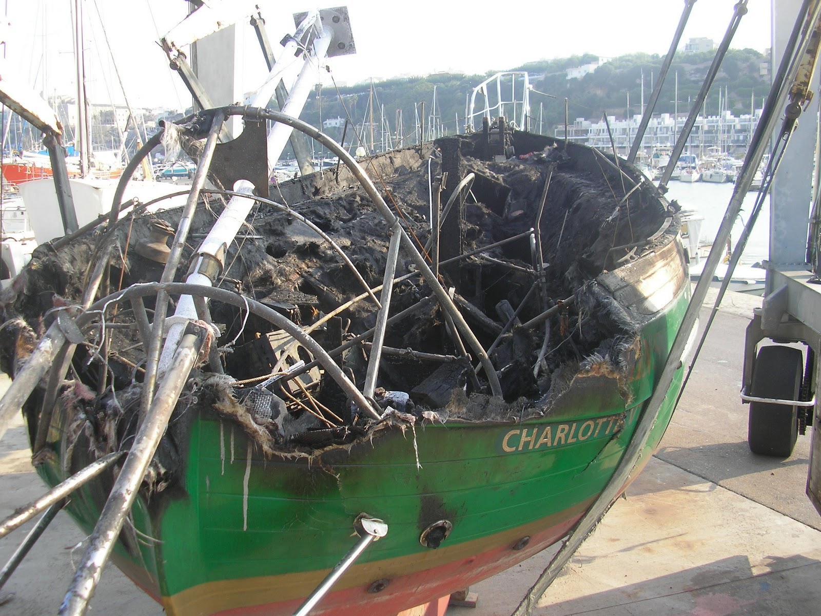

Starter wire that was not fused (just two minutes before this fire erupted there were a number of 8 & 9 year old junior sailors on this boat):
No fusing on the battery cables, deemed electrical fire:
