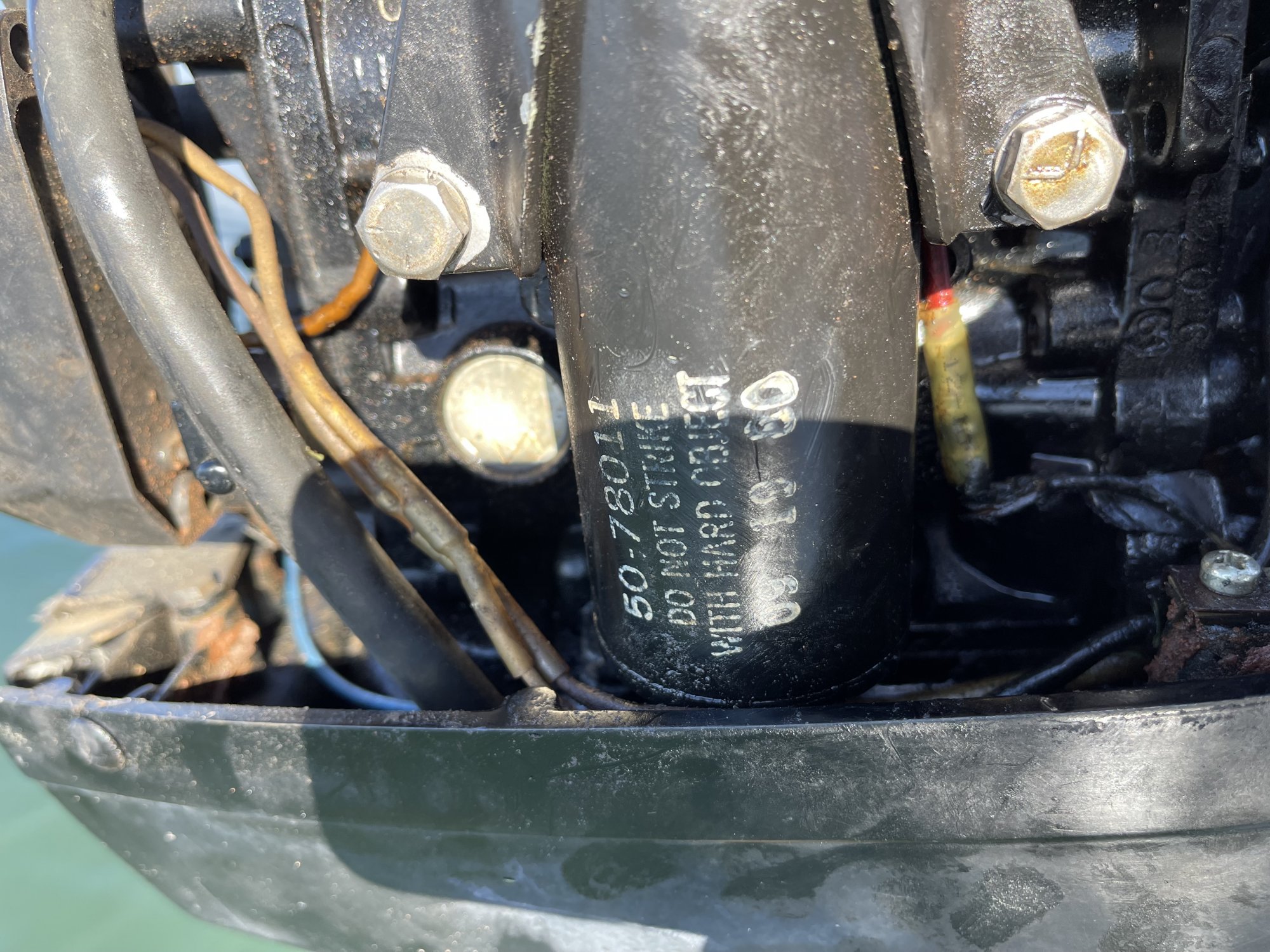

I've narrowed down my starting problem on my Mercury 7.5 1982. I believe it is either the battery or the starter. What is happening is that the starter clicks on and the Bendix spins but does not raise high enough to engage the flywheel. The battery was my neighbor's that he bought new a few years ago but never used. I charged it up and put it on the boat. Started the motor a few times with no issues until the last time I tried it. The gear on the starter does not look worn at all. Starter or Battery?

I looked up the part number for the starter (50 78011) and it is no longer made or available anywhere. DB Electronics does not have a rebuilt starter for it either. If it turns out to be the starter, I will have to pull the old one and find a place to have that one rebuilt. Fingers crossed that it is the battery.

Benny, the battery I used on Sunday was brand new. I put my money on it being the battery also, but it is the starter. I took the starter to a repair shop this morning and should have it back tomorrow or Wednesday.
