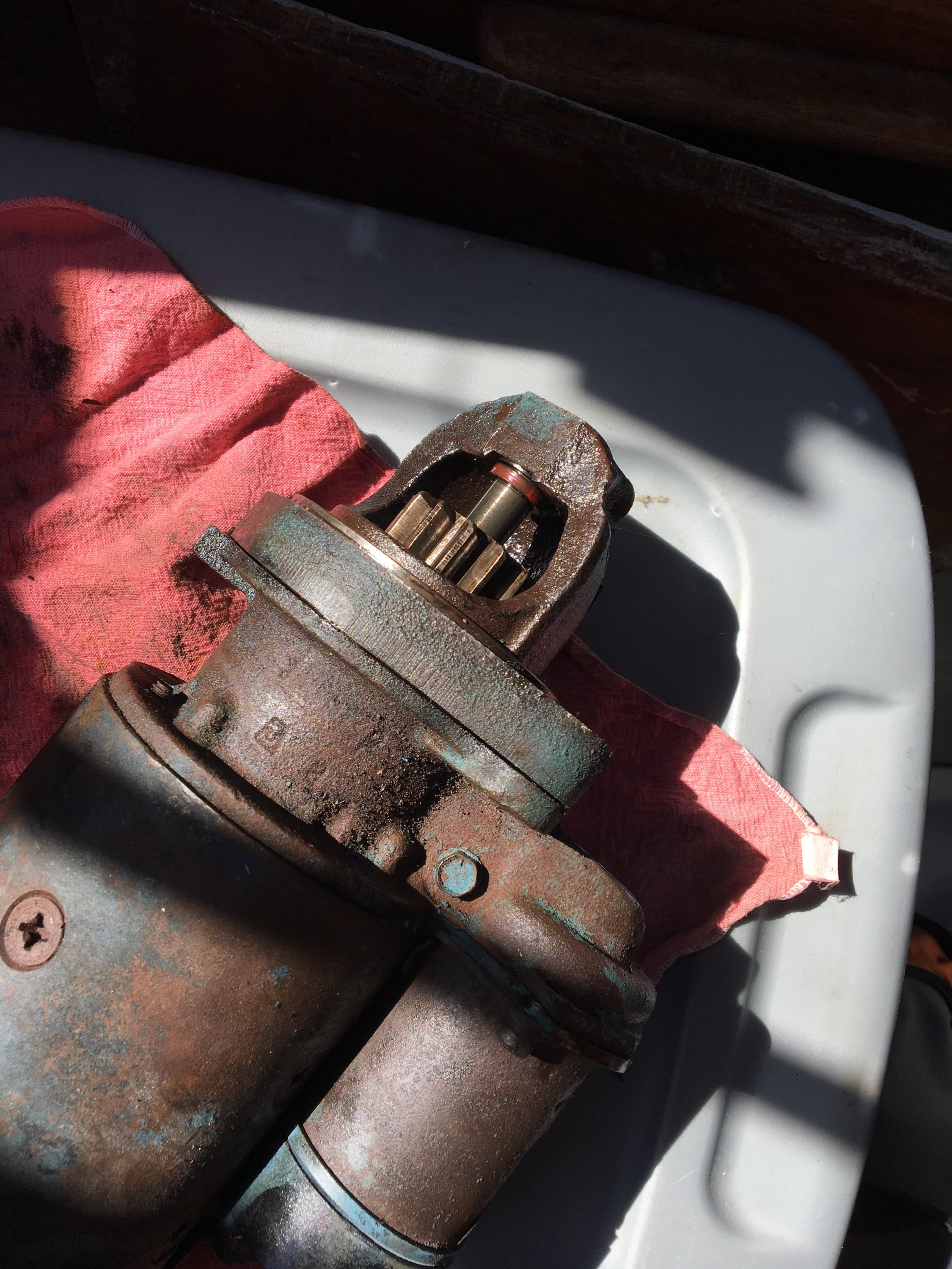

Pleased to say the starter ectomy was a success. It has 12 teeth, #1105874 and it’s toast.
Born in 1973. Died 2018.
