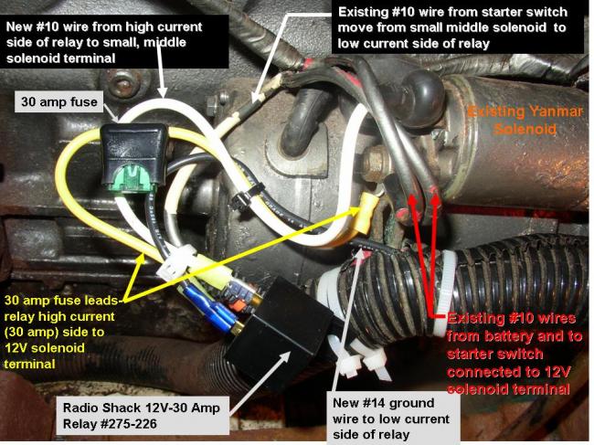

In addition to Warren's write-up, here's a pix to help. First one is for a Radio Shack relay and the second, a drawing, is for a typical car starter solenoid (ala Ford).
When we first bought our boat three years ago, we had this problem The previous owner actually started the engine by shorting across the solenoid with a screwdriver. He actually had a dedicated engine starting screwdriver at the nav station - thought it was no big deal. That's the type of guy he was. You can imagine some of the other issues I've uncovered and fixed since.
We originally used this diagram and bought the solenoid from Radio Shack. It lasted for two engine starts and then blew out. The only way to truly fix this problem is to run a new number ten wire from the starter button to the solenoid. Not only does it solve the problem, it's actually a cheaper fix. Twelve feet of #10 , a butt connector and a ring connector. Anything else is just hiding the problem with a work around.
Your boat your choice.
