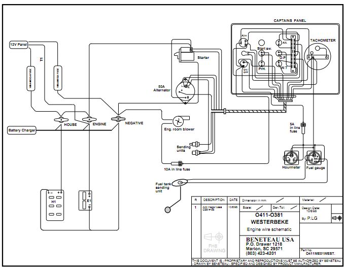

Sure it did, that is the way your system is wired. See that little jumper between your House and Starter disconnects? Don't blame your technician. Doubt you really do have 4 battery switches.
23,496
Gunni's right because Beneteau wires their boats as he shows. Here's another. It takes some exploration and understanding.

When we got out boat 10 years ago I spent a lot of time trying to figure out optimal configuration of house and start switches, then I saw same as Gunni picture where it made no difference since they were wired together anyways with a jumper. I just decided to rewire to something I knew how worked using various sources I trusted, I recommend if you really want to dig into this look for a solution and rewire it yourself, make sure you don't make it worse though :eek:)
A couple of things I did were: replace jumper between house to starter with a Yandina combiner, I then rewired the alternator to go directly to house ONLY battery, not using the yanmar harness for charging, starter still wired to start battery.
One note about switching to charge house over start batteries: Stu's schema is good as it shows what I think is the "lamp" from alternator that goes into harness and to start battery, if I remember right that is connected internally in alternator and would provide a connection between house and starter batteries, outside the combiner, so I rewired that as well.
So... was it worth it? I doubt it, honestly I'd just go sailing and keep eye on batteries charge state, fluid levels and so on, which I do anyways. I still have the Beneteau jumper cable and backup battery for emergency but knowing more about this does give some peace of mind...
