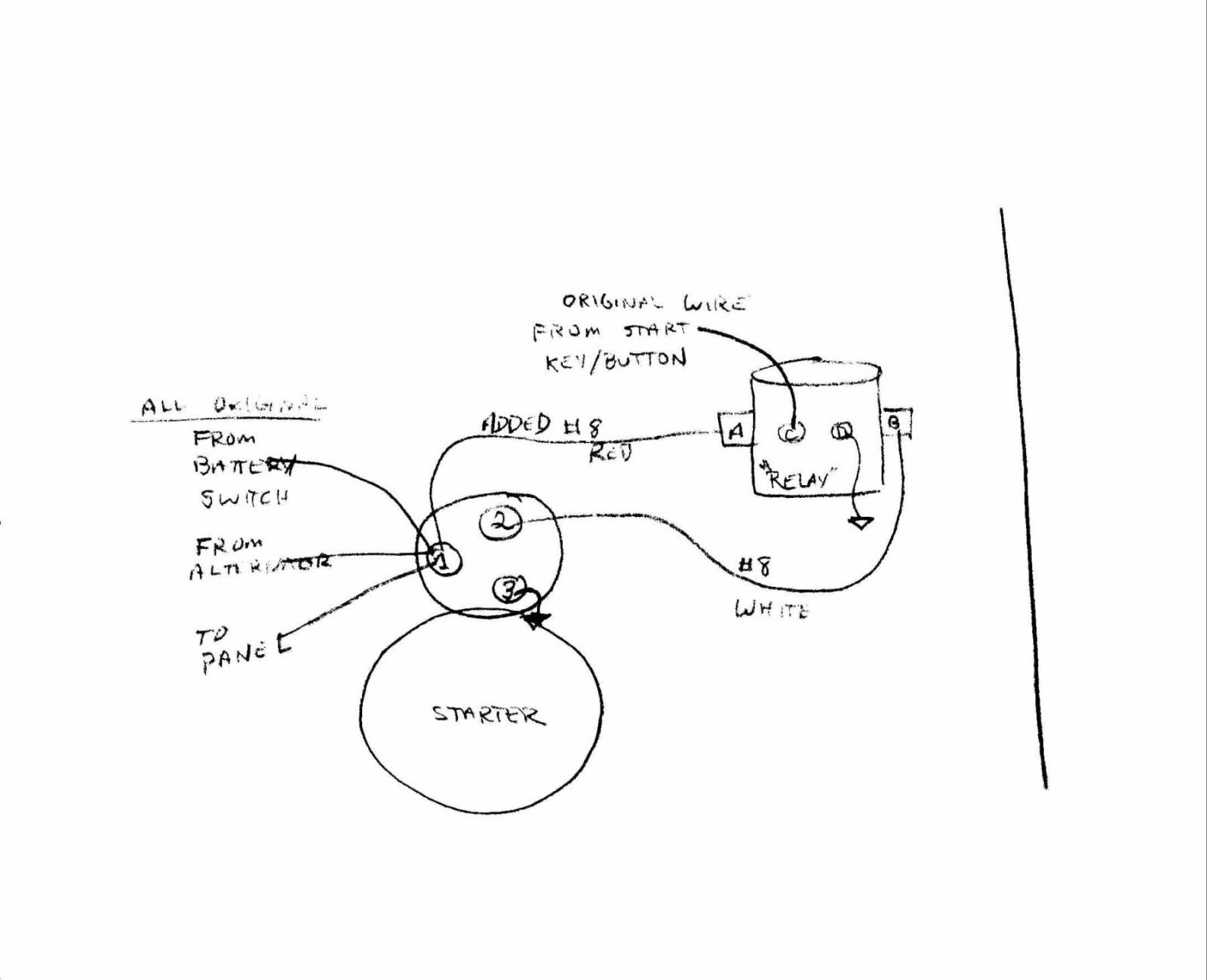

This question has been asked and answered at least fifty times. Some have even threatened to sue Yanmar. It is simply a matter of too many connection points with too light wire between the battery and the solenoid. A second solenoid was the permanent solution after changing every other component and wire including a new 900CCA starter battery. See the attached wiring diagram.

is more expensive. But it is also different from automotive and worth the investment. The "relay" in my wiring diagram is part #289407(pg. 717) in the WM catalog. Cole-Hersee(sp?) makes them and you might find it cheaper through Google. It is actually a solenoid. Sometimes called a relay because of the way it is being used, to make/break another solenoid. If you studied my wiring diagram you see that it is taking the 12v directly from a #4 cable. Then it is using one short piece of #8 wire directly to the starter solenoid. On my boat that eliminated about eight feet of #12 wire and eight connections between the battery and the starter solenoid(picture).

Mine was more ornery then most I think. Once after several attempts I put my head close to the starter and had my wife try it. Not even the normal faint click. It was that fuse on the back of the Yanmar(see the picture in my last post). When that goes you have no chance, not even with the "relay". The cheap way out was my trusty rubber-handled pliers. Simply jumped directly between the two solenoid posts. Did that for a season. :)

Not trying to start a relay match here, but to answer D. Prior's question of what a relay is. A DC relay from Radio Shack that I have installed is a small plastic box about 1"x1". It has high side and low side current connectors. To install you disconnect from the solenoid's small middle terminal the wire from the starter switch. This starter switch wire is then connected to the low current side of the relay box. A second low current side wire is sent to ground making a circuit - when the starter button is pushed. Then add a new wire from the solenoid's terminal (the one wired to the battery). Connect this new wire to the high current side of the relay. The other high current side of the relay is then connected to the small middle terminal on the solenoid. When the starter button is pushed the relay triggers the high current to flow to the solenoid, which in turn sends current to the engine's starter. I have used this relay for over two years and it works every time. Regarding the starter wire fuse. Mine also went out. Replace it with a simple inline housed fuse of the same rating. Ed's solution will also work. It is just a matter of what you choose to do.
