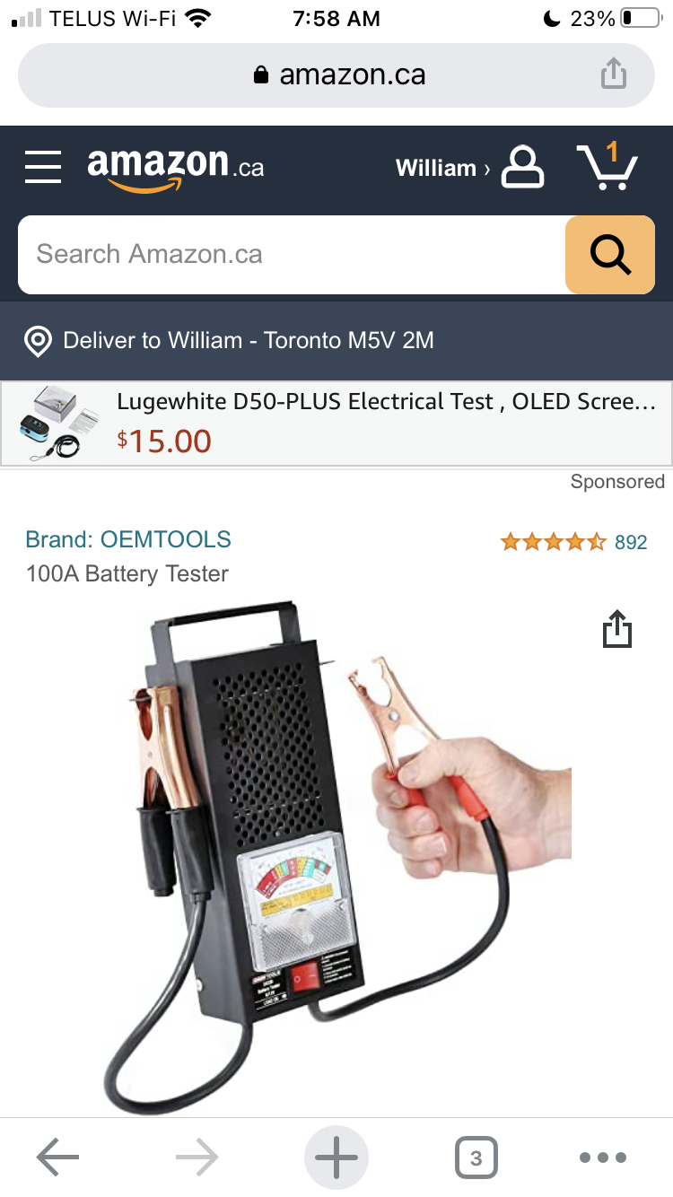

Thanks, put it under load with a battery tester and then saw the amps go to 200 under load.

With that type of tester the voltage was not 12.7 when the load was applied but that's a different story. You are correct about the battery needing replacement.

How are you determining 200A.? That tester only does 100A?

I
Can you share your thoughts as to why you think he needs a new battery. If the tester indicates 12.7V at 200A, isn't the battery pretty much 100% SOC and ready to rock ?
I'm very familiar with that tester. With the load (100 amps give or take) applied the voltage is a lot less than 12.7 if its indicating 200 CCA. Unless that battery is very small or very very cold 200 CCA is a failed test.
