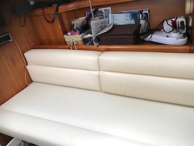

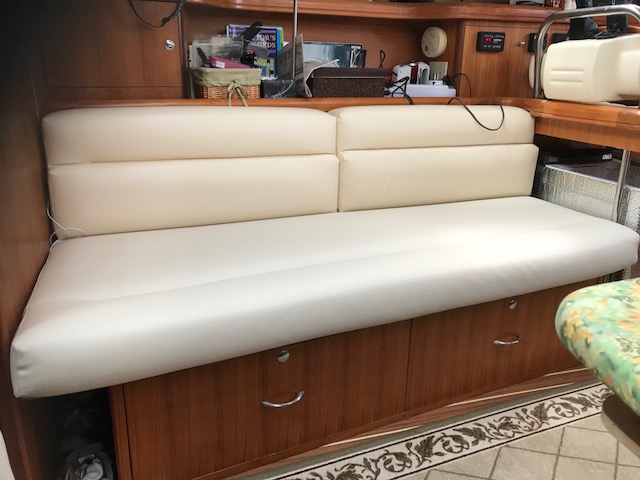

No I don't have any pics of the area behind where the couch was..
the teak paneling behind the couch had openings already in it for storage..

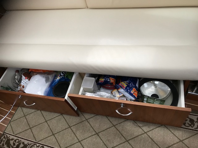

I used teak 3/4 in ply to build the finished part of the drawers regular 3/4 plywood for the rest of the draw cabinet The foam was the best quality high density foam so you dont "bottom out " when you sit down Also changed the foam in the dinning area seats to the high density foam got tired of hitting bottom at the table..
Did not salvage the covering off the couch chucked it all

no pictures but the wall went down to where the seat is on the new settee holes where already in it for storage

I will look at putting a roller/slide on the bottom of the couch for a short term fix. I know the bottom drawer completely comes out as I have removed it before to fetch things that have fallen behind it. The couch should be able to slide towards the center line allowing access to the area behind, then slide back and lock in place. Soon!
