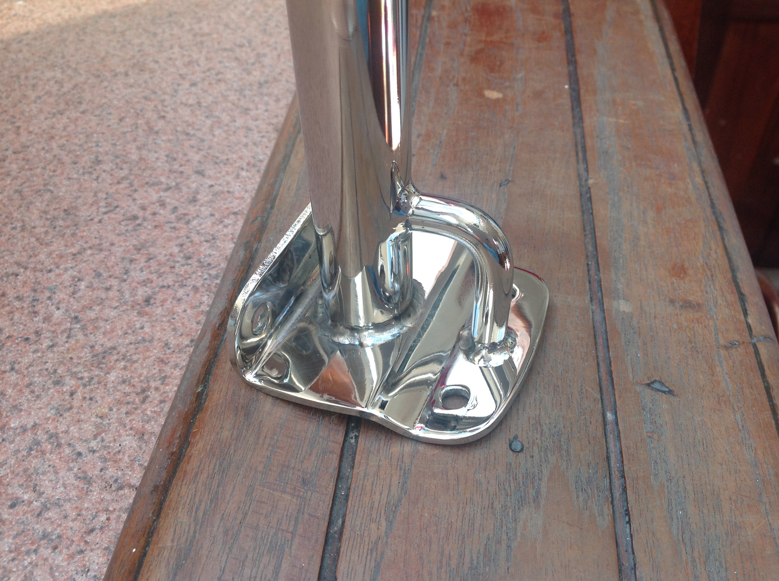

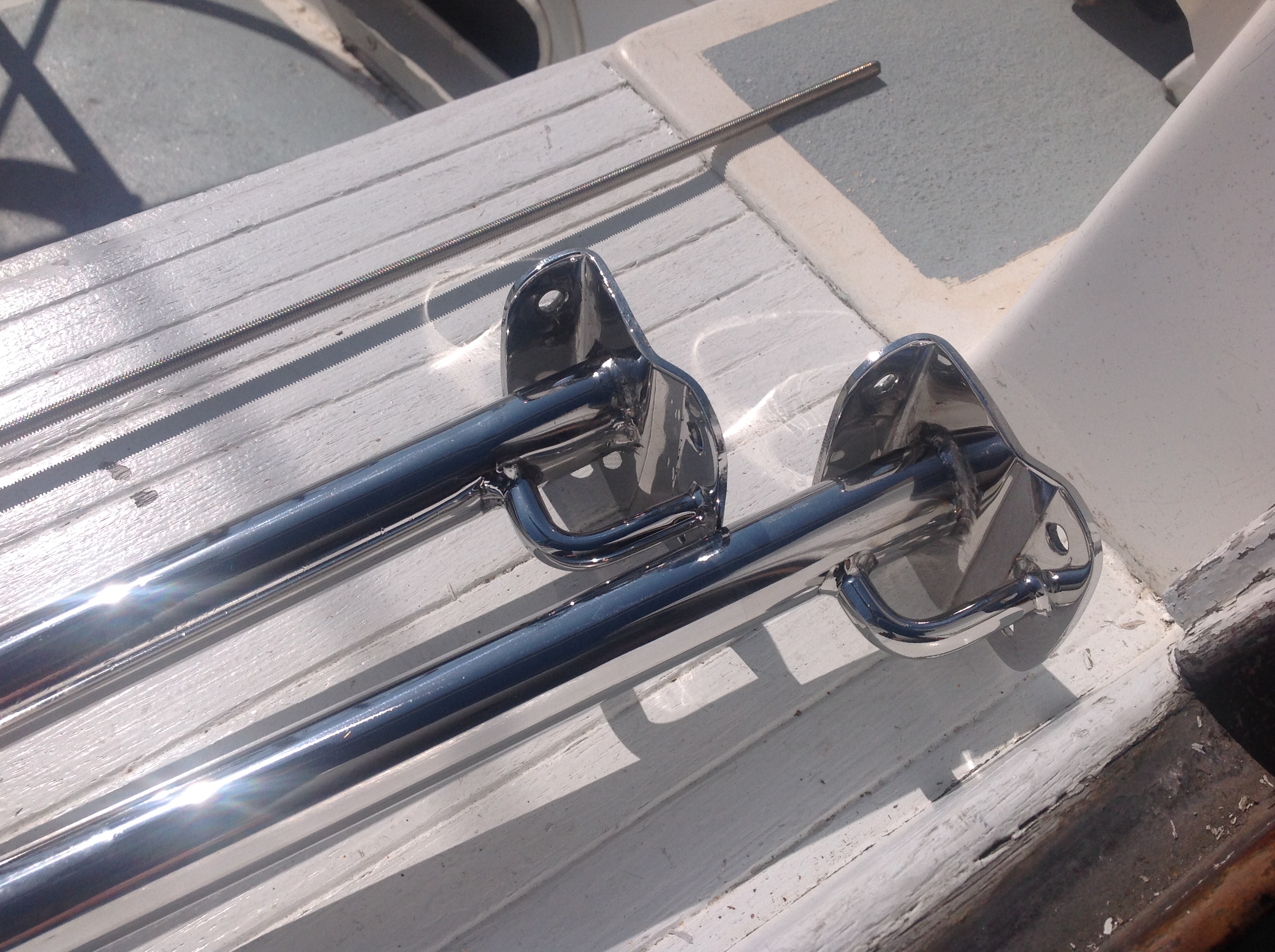

My vote is to at least investigate repair, especially if you have some place to take it to. Cost can be lower, will fit back on the boat etc. Attached are pictures of two stanchions that were broken off at the base. That was 5 years ago and there is no sign of corrosion problems.

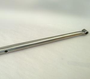

I have replaced a couple of stantions on my Hunter 34. You may find that your old stanchions are glued in with 5300, so allow extra time for removal. I bought new stanchions off the site, but they need to be bent to be more upright. Any shop that does custom boat towers can bend these to match the bend of the removed stanchions for a reasonable fee. I would not try to bend these using any normal hand tools.
Jun 27, 2004
113
Hunter 34 New Bern, NC
The H34 does not use a standard stanchion. The H34 uses a tapered stanchion that is available on this site.
