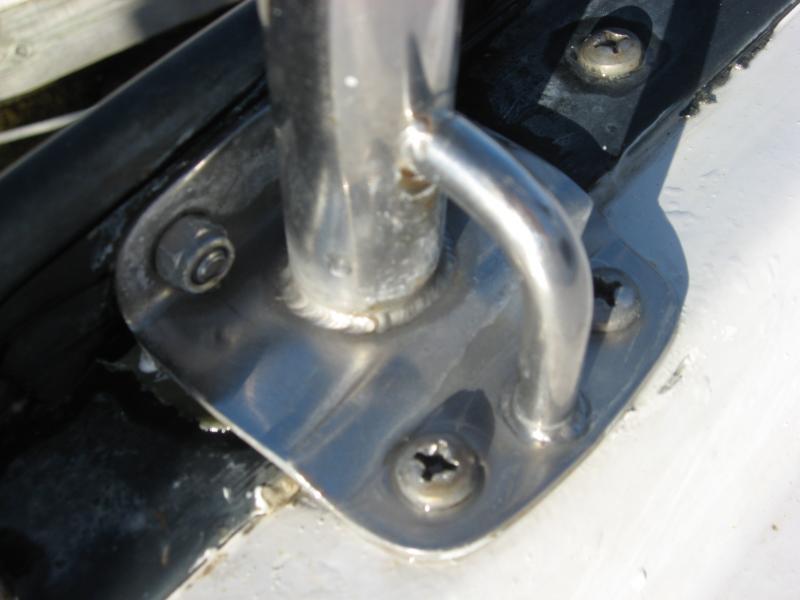

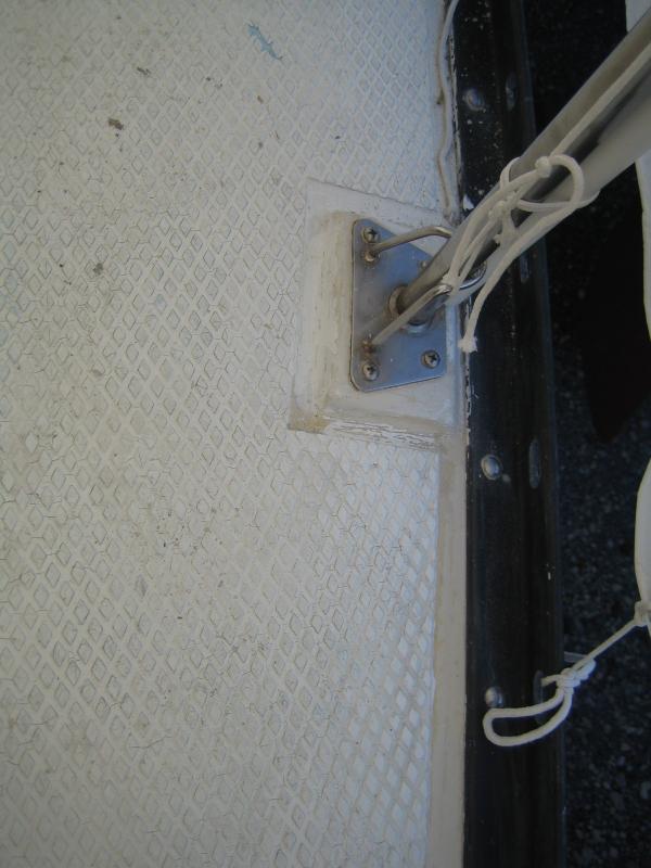

Here's a pic of the bottom of one of my eight stanchions on my 1980 Hunter 36. Looks like a dead ringer for the Rigrite toe rail mount type base (their part number SB36-H1-T90) that will accept any straight piece of 1" SS tube. (Of course I would would take some measurements and call them to verify before ordering.)
Also, as mentioned by another respondent, I am confused about your observation about needing to cut your lifelines off in order to replace a stanchion. I have never seen anything else but lifelines that are swagged into a terminal with diameter small enough to pass through the stanchion life line "holes". Just a matter of unscrewing the terminal ends from the pelican hook fittings. You can see how narrow the swage terminal is in the second attached pic from my boat. (Its the section the hanging water droplets.)

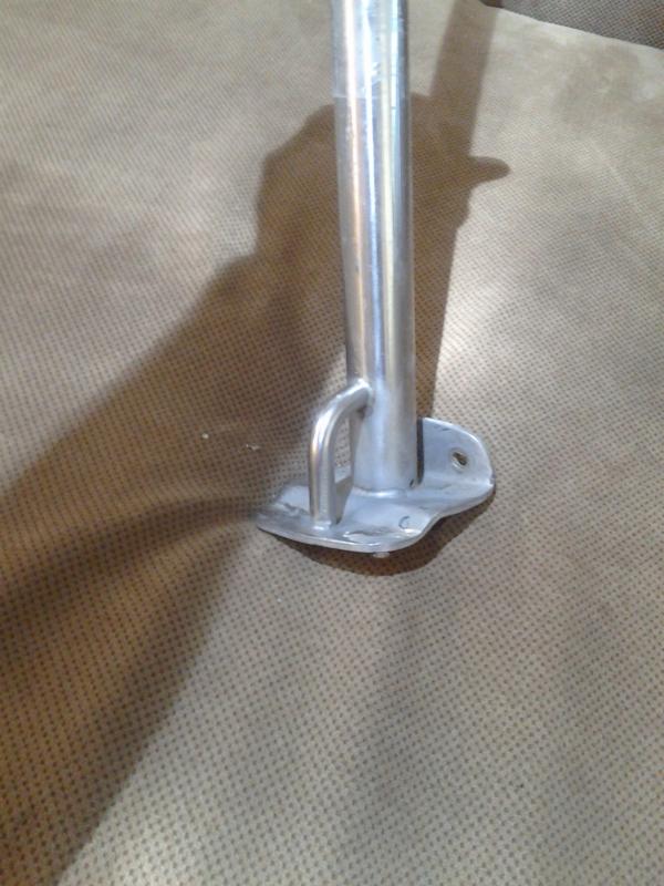

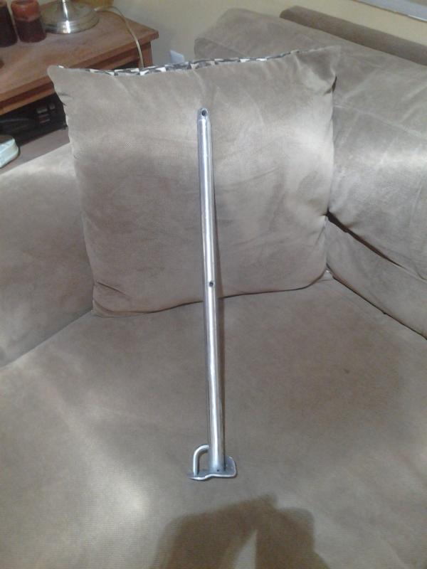

heres a few pics, looks about right just don't know if the deck angle is the same, I imagine hunter would make it so to get a larger discount for quantity. Your more than welcome to it, as i am planning on wooden bulwark spaced off the deck in lieu of the aluminum toe-rail and will have combination bulwark/stantion brackets welded. I'll be around wednesday afternoon (off generals highway) or i can send it down to the races with my dad (he races on "gratitude" out of AYC). I'll PM you my phone # you can let me know what works for you. I'm planning on rewiring this winter, when the time comes I'd love help designing a system, in particular calculating wire loads and voltage drops (I'm used to A/C house wiring).
