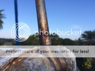

I guess I'm way over my head in this boat purchase (1986 Hunter 34), perhaps I should have heeded the warnings about buying a sailboat. It's now too late. Let me start by saying we had a survey - a very bad one. We've been dealing with many issues since buying the boat this July - most of those issues are manageable (we knew we had virtually no electronics, sails in so-so shape, cosmetic issues, etc). However, today I hired a guy to climb the mast to install a new windex, some bird spikes and take a look at my non working anometer. He very quickly came down and showed me this photo:
He said he's really surprised our mast didn't come down. The plan is to replace all the standing rigging. So a few questions:

Hi Amy, I was wondering if you have made any progress with your rigging project. Typically a standard boat survey excludes standing rigging so the fact it was not noted is not surprising. I was worried about my 30 year old rigging so I got a rigging specific survey and was told mine is still OK. I also go a quote from Seco South for $2077 plus shipping but based on the survey I will put it off for a while. Your photo appears to be a fitting at the spreader which often show problems first b/c people tend to cover them with guards that trap moisture. That is to say your problem may be limited to a couple fittings but all things considered it's probably best to replace everything while you are in the mode. Be sure anyone you hire to do the work is familiar with B&R rigs since all the diagonal cross bracing has to be tensioned on the ground to create the mast bend.
