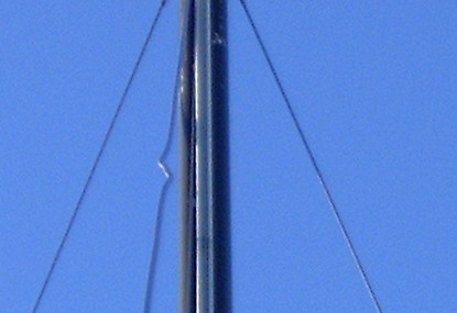

Finally. Made it out to the boat. Nice and dry, but I did have to shovel snow off my cover.
Here is the back stay bend I've been posting about.

Bob, why are you agonizing over this? Put it in the water, change out the backstay and go sailing. Maybe you lose a day. And if you are like me it will be a perfect day and all the guys will wave as you are up the mast and they are headed to open water.
You can have the wire ready for the top. Come down and put a Norseman on the bottom after you get the length right. In the fall pull the stick and you will have all winter to get the mast and boat and rigging(if needed) right for 2010(when the markets will be great after all the bailouts).

At the moment, I am just waiting for warmer weather to get the free rigging inspection. The other thing is that it is a real waste, if I do drop the mast, to not address a number of other issues...moisture in the deck near the mast...touch up / paint the mast...fix the steaming light....the usual stuff. I'd really rather sail this season.
Worst case we will put her in the water, go up the mast and do just the back-stay and perhaps replace all the closed-body turn-buckles. I have a volunteer to go up the mast.
I am thinking that the bend might just have been imparted by the marina workers loosening the turnbuckle. If they couldn't get it to spin in both directions and were too stupid to realize what was happening above it would perhaps explain the damage to the stay.
