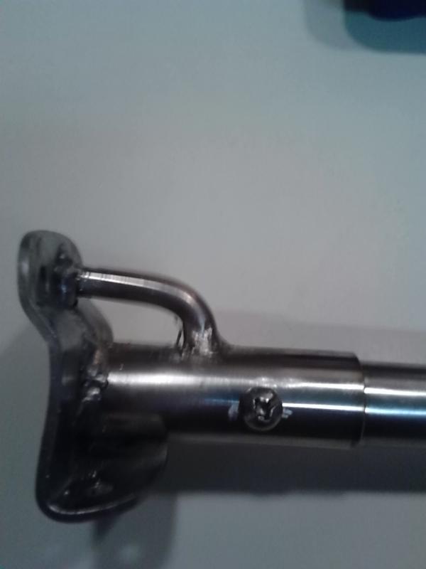

I started a thread a few years back (4 to be exact) about repairing my stanchions. When I purchased my boat, the stanchions were in pretty rough shape. The boat had some damage from hurricane Fran ( I think) and the stanchions were never fixed or replaced. I removed them from the boat which wasn't as bad as I thought it was going to be. My biggest problem was the corrosion between the aluminum caps and the stainless tubes, but I made it through that and got them all drilled out and removed. They were pretty much falling apart and needed to be replaced. Now on to the fun part. I either want to straighten them, or replace the tubes, but both are looking like a pretty big chunk of change. To straighten 4 stanchions would be $170 to replace the tubes would be $340 so I set out on a new mission. I found a set of used stanchions that are straight, and was going to try to get someone to weld a short tube to the base. I figure that if I cut off the old tubes and grind the bases down, it can't cost all that much to have someone cut the short tubes and have them welded. I've drawn a rough picture of what I'm looking for and attached it. I'm thinking that the short tube that I need welded to the base would only have to be 2.5" long. Am I way off base here, or will this work? My thought is that If they ever get bent again, it will be as simple as removing the tube and replacing it instead of having to replace the whole thing.

The only place I found a base that are the same as the ones on my boat is Tops in Quality and they wan't around $120 each for one complete new stanchion. The older H30's have a funky base that isn't like most. If you open the PDF file that I attached you will see what the base looks like. They're not a basic flat base and moving the stanchions inside of the toerail to accomodate the flat bases would be a real PIA not to mention the loss of deck space which is already limited. I picked up the tubes from ebay for $75 for 8 of them so I'm not real worried about the tubes. What I want to do is make it so that I can easily replace them if they ever get bent again. Right now, I'm having a hard time finding a 316 stainless tube that I can slide a 1" OD tube into and have it fit snug. I've found one that's 1.01"ID but I'm not sure if that will be too snug. The next size up is 1.12"ID. Both of them are 304 stainless.

After getting ridiculus quotes for my stanchion bases, I decided to do some fab work myself and have someone weld them. Even Garhauer's prices were higher than I wanted to pay. Rig-rite was the highest at $99 each. I set out to find some 316 stainless tubing slightly bigger than the stanchion tube. I found some at a local boat shop in Ft. Pierce, FL just down the road. $10 for 2 ft. I cut off my old stanchion tubes and the support loops at the bases. Then I cut 2.5" pieces of the new tubing and cleaned up the ends. I took the support loops off of the old tubes and cleaned them up also. I found a guy that welds stainless, and had him weld everything back together. In the mean time, I had picked up a set of 8 stanchion tubes on ebay for for $75 shipped. They were pretty straight, but someone had straightened them using heat, and they were slightly blued. Removing the blue from the area where they were heated was easier than I thought. I took some 250 grit sand paper and sanded the area, then I moved to 400 grit wet paper. From there I went to 000 steel wool. to polish them back to their original finish. I cleaned up the bases, and polished them up the best I could. The welds aren't pretty, but they have good penetration. The reason for going this route was that if the stanchions ever get bent again, all I have to do is pull out the old one and put in a new one. Sorry the pic isn't better, but my camera on my phone sucks.

Hunter 30 Vero Beach
