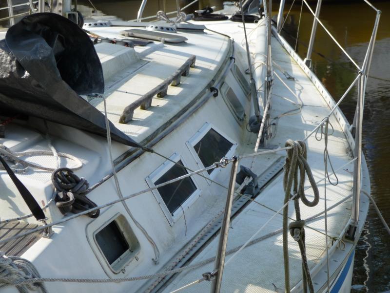

Und So.. the next question is where to get the stanchions for the 34 that don't use the bail? Because of the deck angle on the 34, the stanchions stick out past the rub rail.. especially the ones amidship. If one is sliding along a piling on the rub rail, the stanchion will be bent .. I know a guy who has at least one of those bent looking ones!.. They have a ferrule on top and a hole through the middle, and are tapered. Note the second one forward in this shot.. base is kinked a bit.

That what mine looks like too, the bases look to be in good shape just need the stanchions.
