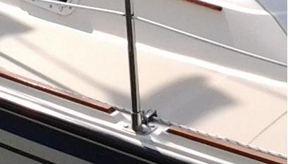

I was just wondering if anybody knows of a good way to polish the stainless steel stanchion pole mounting plates. I was thinking of a round drill attached soft wire brush with some paste polish…..i noticed mine were looking a little dull.
