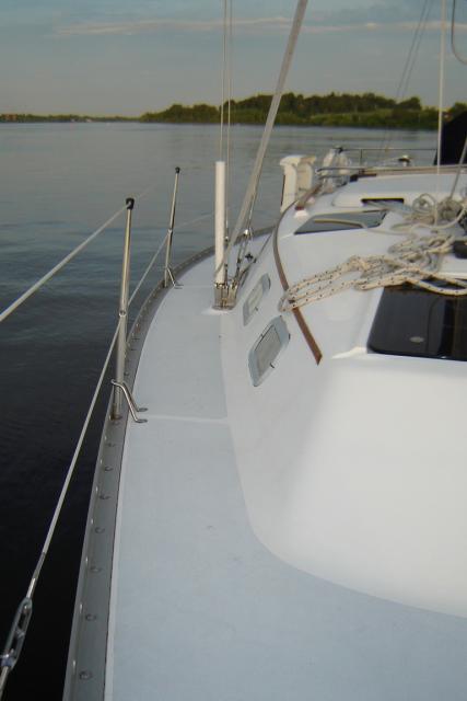

Also while anchoring out last weekend another boat lost power and with the wind and current on the river, hit us and bent the stanchion in this pic. Unfortunately, you can't buy these mounts anywhere. Poles, yes you can. Guess if one breaks, I will have to take to a fabrication shop to make another one. Thanks guys for the input. I follow this forum all the time. A world of information here.

I would suggest that you contact Garhauer Marine and see if they can match what you have. These guys have the ability to make most anything/any style.
You should speak with Mark, he can help you out. You will probably want to ship him a sample.
