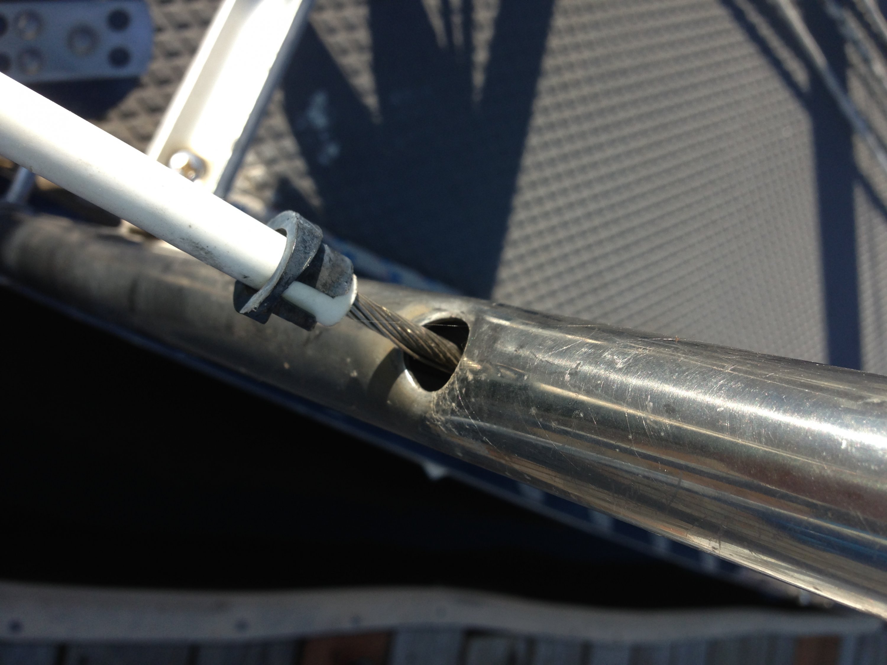

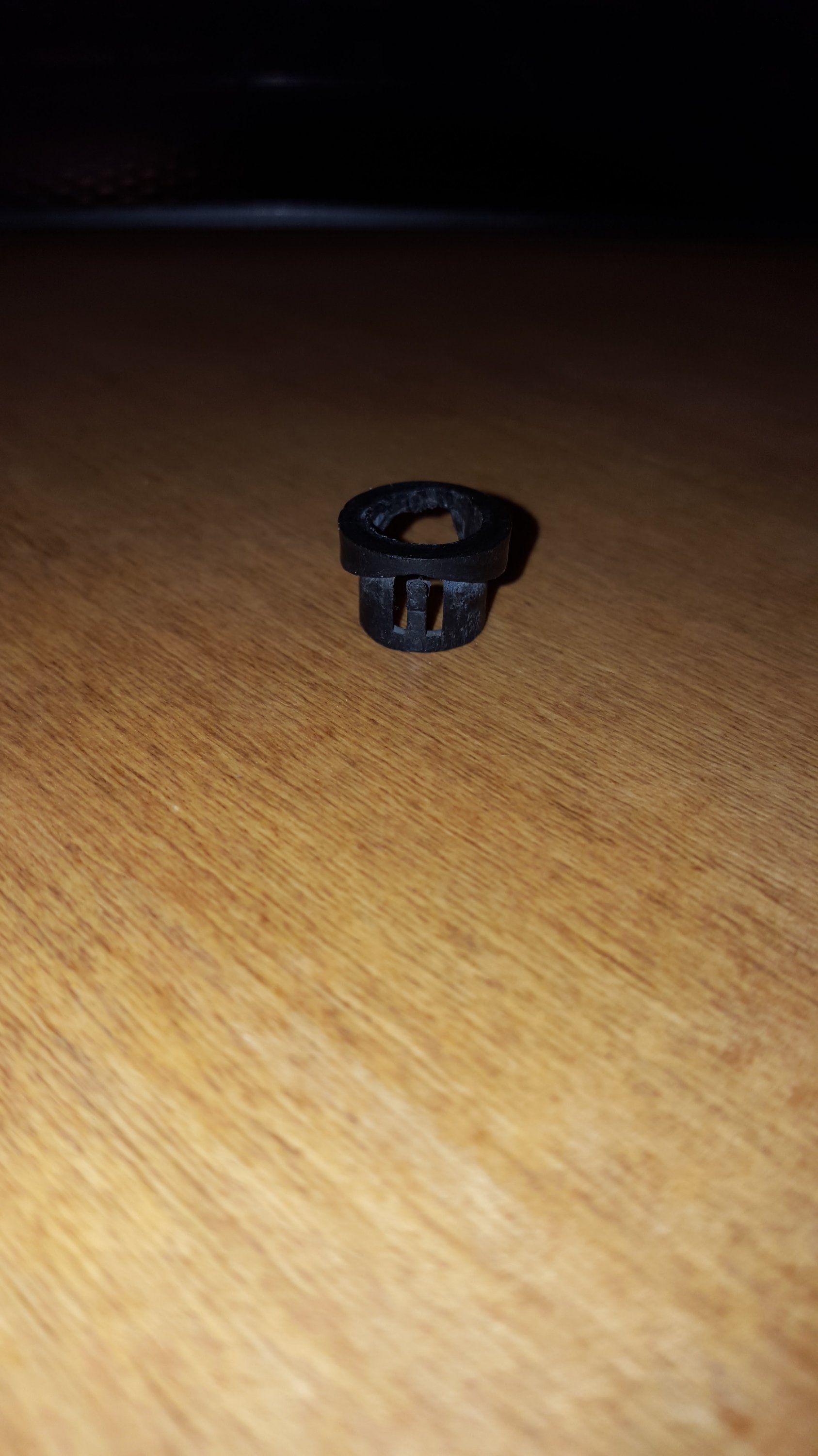

Try Johnson Marine 860 873 8697 for intermediate stanchion bushings or McMaster Carr for locking grommets in their catalog
14,004
A better solution is SS ferrules welded into the stanchion. They are permanent and make the stanchion look more "finished." White Water Marine will do it for a few dollars a stanchion with a quick turn around time. A good winter project.
