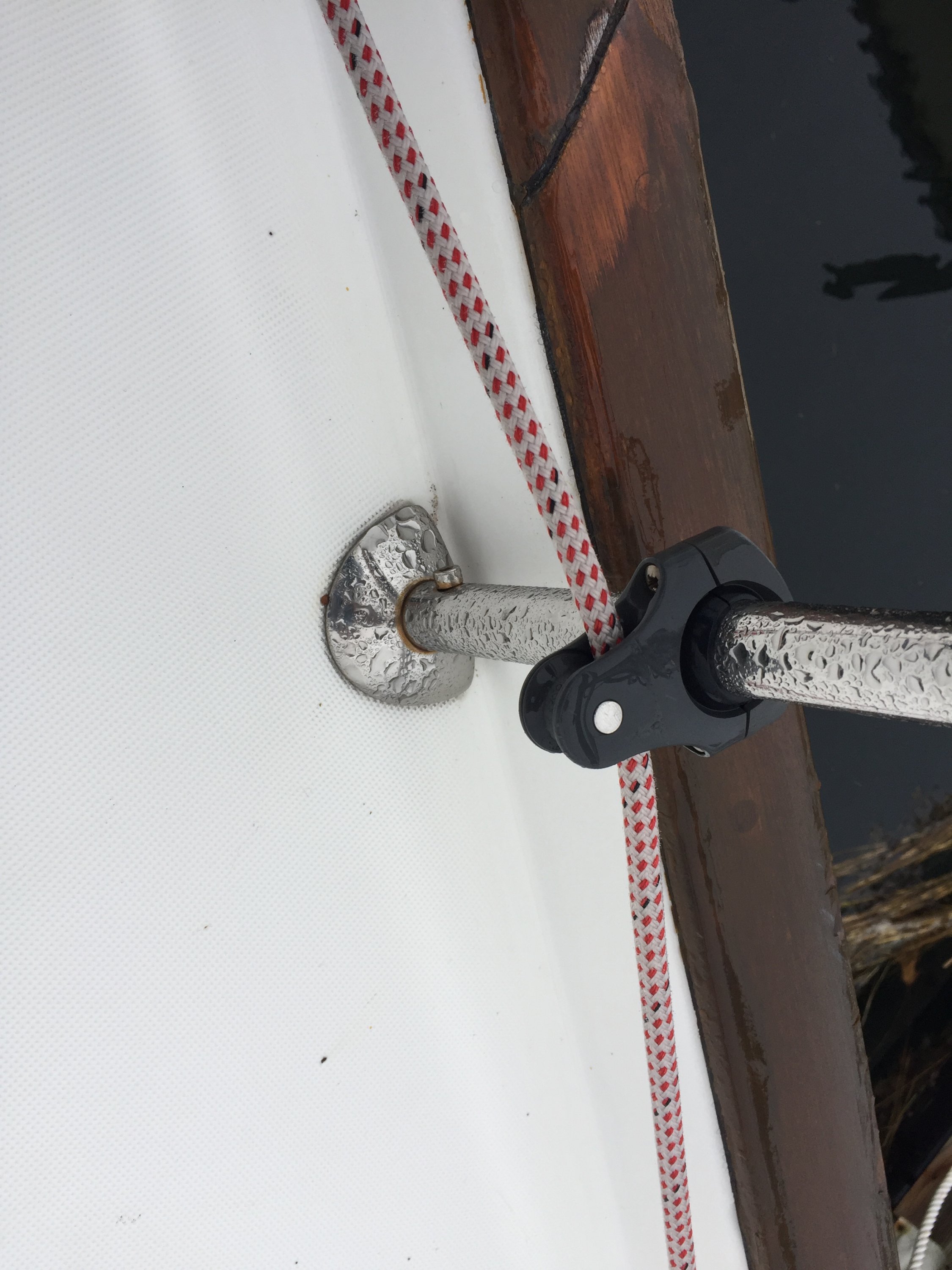

hello all. 423 and found a leaking stanchion. Havent taken apart yet but wondered about the design. Figure it’s a basic stud attached to bolt.......

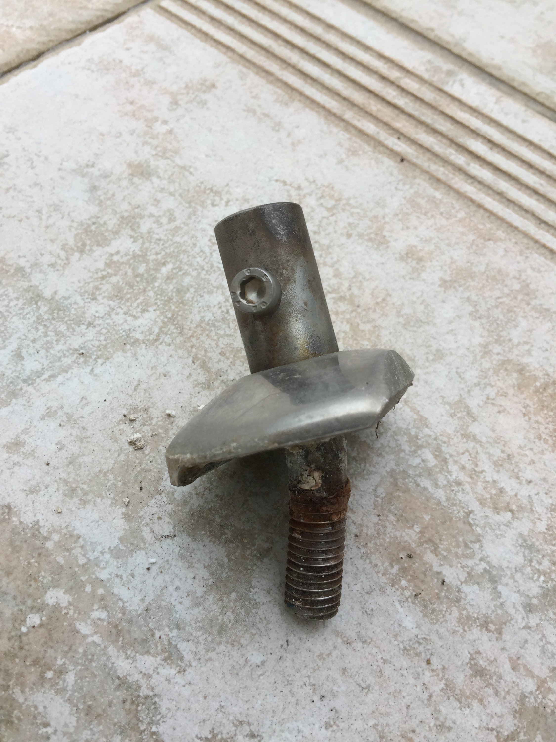

Most probably the stanchion was pushed against the fiberglass and caused some damage. The base goes through the hull and there's a bolt underneath. Mine was even bent but I have never managed to understand how it happened. To get access to the bolt you may have to remove some furniture (so be prepared!).

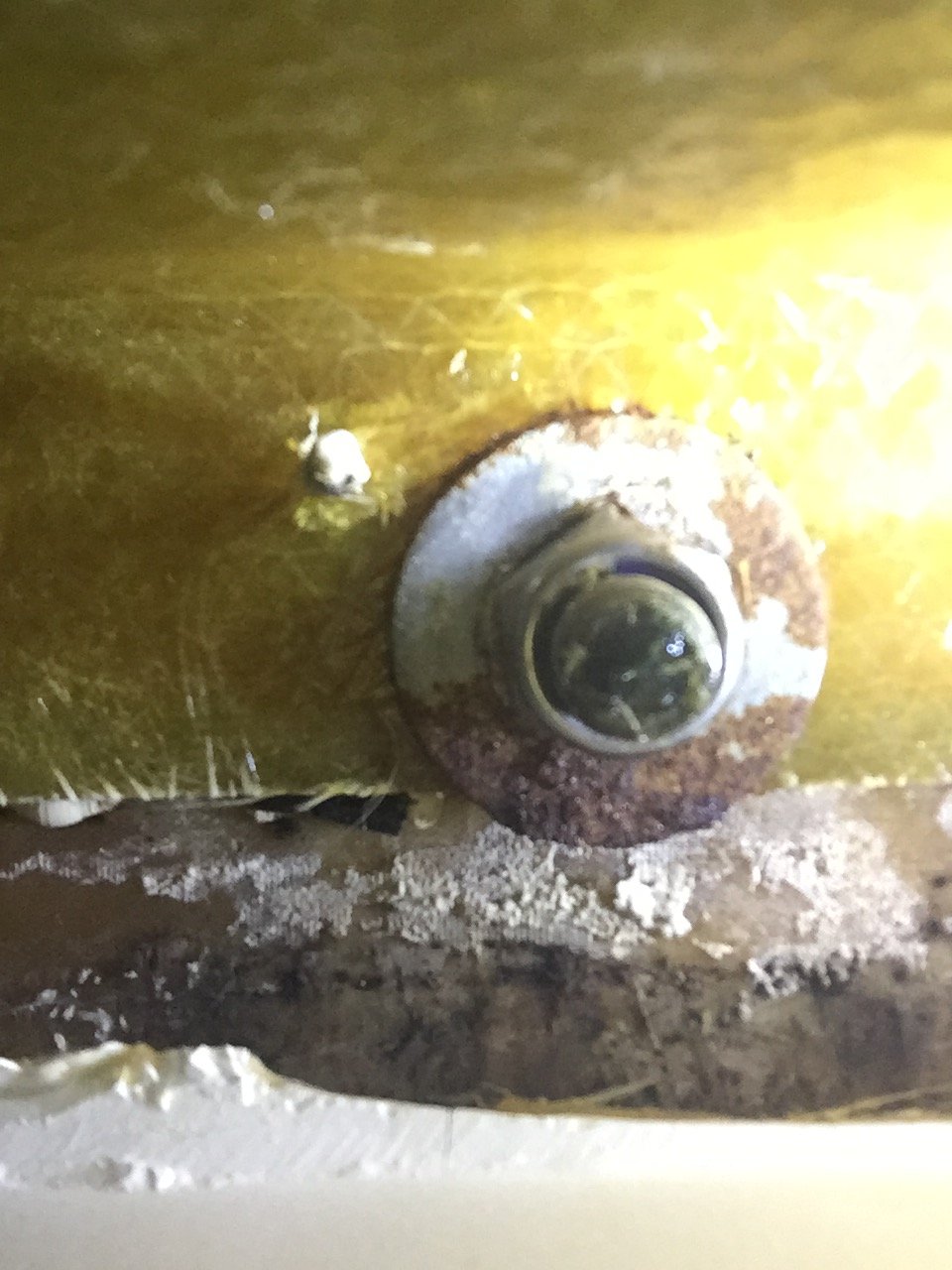

Thanks! I have good access to the bolt inside the boat.... so I assume that price sits flat on the deck or is there another plate??

On the Beneteau 361 the stanchion base sits partly (mainly) on the aluminium rail and a part of it (a little "leg") on the deck. Stupid design if you ask me. On the Beneteau 423 it sits completely on the deck inside the wooden rail and is slightly different (it hasn't got that little leg).

Again thanks! Will pull it off this coming weekend and use some good ol’ butyl tape to seal things up.

I must say, what a joy it was rebedding this stanchion base.... Good Access, nut came right off, clean up, a fat ring of butyl tape, and reset and tighten. A very bad job on the sealant (silicone) that was there.....

Bought mt butyl tape from mainsail..... works great! We used a large wrap of butyl around the bolt so when it drops to deck it is forced into and around deck hole. No other sealant needed.

Did you folks have to break out (drill out or otherwise) some of the fiberglass headliner to get access? I need to rebed at least 1 stanchion on my 2005 373 and there doesn't appear to be any easy access to the underside.

No, I didn't have to break out or drill anything. However, I had to remove (unscrew) the top of a cabinet to gain access at the bolt.
