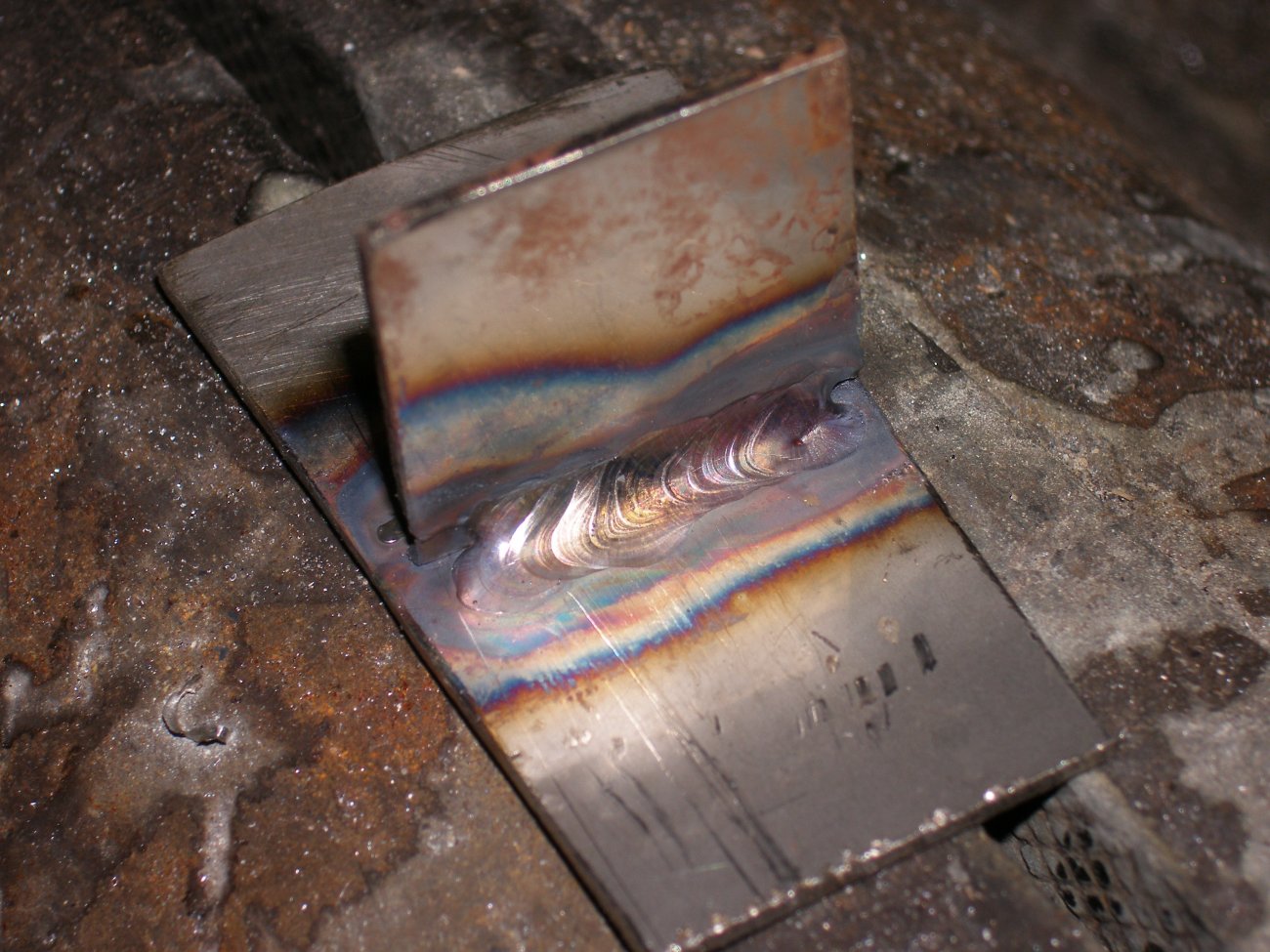

I have made up a brace like used on the gudgeon they sell today.
I have a TIG welder and can put in steel panels almost good enough you would have a hard time finding the seam in bare metal. I have played around with car restoration.
So I got some SS and started looking up on the web what I needed to know. One thing you have to do is passivate the weld area. When you weld you bring the iron to the surface and it can rust. It does not hurt things, but it stains. There are all sorts of acid dips that corrects this, but they require nasty chemicals that are not easy to get. So I am trying some Goof Off Rust Stain Remover which is a weaker version. Put some electricity into the mix and it is supposed to do the job.
Here is a pict of the test weld I did. What you do not see is the heat discoloration. This is after passivation. It seems to have worked. Not sure yet about the black stuff, need to look it up.

In checking some on the net it also looks like do not have enough post time flow. Might have to do smaller areas and let the argon flow while it cools.
Oct 19, 2017
7,941
Nice post. I'm interested in getting into welding so I'm following this thread. Thanks for the pic. There is carbon in ss, so maybe that is the black stuff you mentioned.

Good report on your welding. I appreciate the reporting.. That is the way many of us started experimenting. Will is correct about the carbon. Chinese stainless steel has been known to contain too much carbon which is why some manufacturers stayed with the more costly ss here in the US.

As far as the above weld. The black stuff is likely because I did not have enough Argon flowing around the weld while cooling. Likely because I am used to just pulling away as soon as I release the foot control. I have to change my habits. Also the bottom looks bad because it was exposed to air. Next time I will use some copper underneath to limit air exposure.

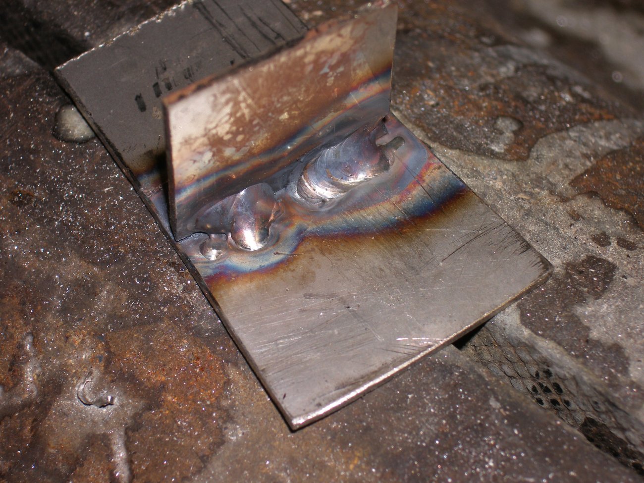

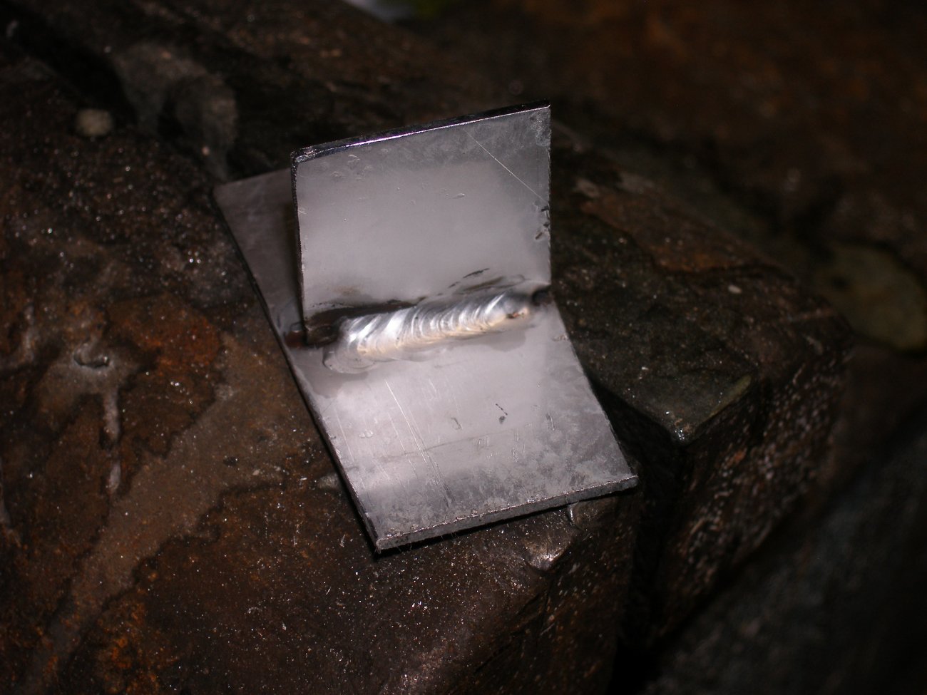

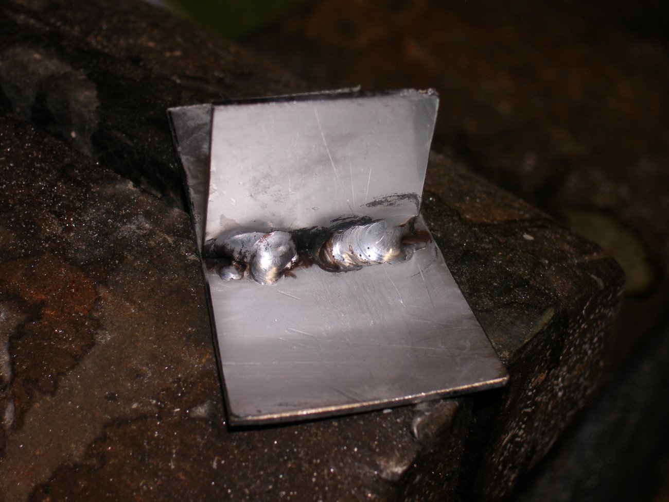

Got a chance to try some test welding again. Made sure I kept the torch on the work for the post flow. That made a difference. First go you can see I have 2 blobs. I was not getting the heat up on the vertical and so it was not doing so well. On the other side I worked at getting the tip up better on the vert and was getting my circle and rod feed better.
The first pair of picts are the two side before passivation.

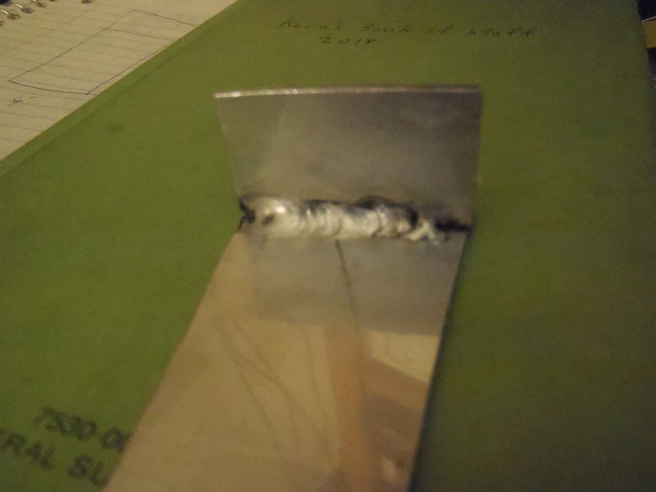

Then you can see what just a little time with 12 volts and the Goof Off rust stain remover can do. I have a glass bead booth and could make the black go away too but it would make a mat finish.

I see a variety of things in those pictures.
The black is contamination. That can be from insufficient shield gas or from foreign material (like oil) in the weld area. Insufficient gas can be from a problem with preflow, postflow, oriface size, or local breeze.
Some bead looks good. Some looks cold. Some looks a bit hot with not enough filler. None show the “fish scale” look that tig beads are supposed to have, but I normally don’t go in for that aesthetic either. I don’t really believe it is necessary. If you ever send in tig specimens to get certified, then you will want proper fish scale beads. That is the only time I bother with them, unless someone asks for them. Most of the time when people ask for them, it's on aluminum, but that can vary.
The discoloration in the heat affected area is normal.
I’m curious what tungsten you are using. Pure (green stripe)? Thoriated (red stripe)? Other? I’m also curious what gas you are using. Straight Argon? I’m curious what grade of stainless your base metal is & what grade of filler rod you are using. I’m curious what polarity you are running. What is your tungsten diameter & is your torch water cooled? Do you have a pedal?

What ever you do, don't use a steel brush on stainless steel, it will leave iron deposits etched into the surface of the stainless and it will start to oxidize.
Incidentally, the "Inside T" connection is one of the most difficult joints to weld and have it look nice, it might be the picture, but it appears like you are not moving fast enough and laying down too much filler, you don't need much of a weld to fuse stainless steel together. The black is carbon precipitated to the surface of the stainless caused by the heat, this is easily removed with passivization paste, your local welding supply store should have this on the shelf.
https://weldingsupply.com/cgi-bin/einstein.pl?PNUM::1:UNDEF:X:ARCP302
Brush it on leave for about and hour and then rinse with water, you should get a SS wire brush as well that will help cleaning the black out of the crevices. The stuff is not to bad just make sure you protect your eyes, yes it is acidic just don't apply it to bare skin it will burn, but it does a nice job or cleaning up a weld performed with the TIG process.
