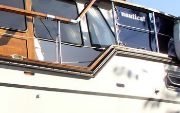

There are some manufacturers that use top rails and lots of stanchions. Nauticat comes to mind. I have also been on a couple of charter snorkel sailboats when on vacation that used them. Both examples of a different class of boat than the Hunters, but it is done.
