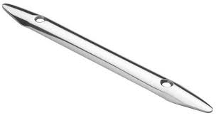

On my First 36.7, I place blocks on amidship pad eyes to lead the fore-guy or sheet to the coach roof winch when running under kite or reaching. The lead isn't completely fair, with the line just barely wearing the coach roof at the transition from vertical to horizontal.
I want to install some stainless rub strakes at this location and am seeking advice if use of screws and adhesive will be strong enough or if pulling the headliner down to bed backing plates and nuts will be necessary for lasting permanent installation.
Sounds like minimal forces at play here.
Best to give it the acid test and you hold the strake in position with your finger tips and have someone work the line back and forth to see how much force is in play. If the forces are light, you've got your answer.

Adhesive and screws will work fine.
A bit like this makes it easy to get the screw holes centered in the rub strake holes.
13,449
No need for baking plates. I have a couple of those strakes on my toe rail to prevent chafe on the wood from dock lines. Held in place by a few #10x5/8" self tapping screws. No problems with them.
