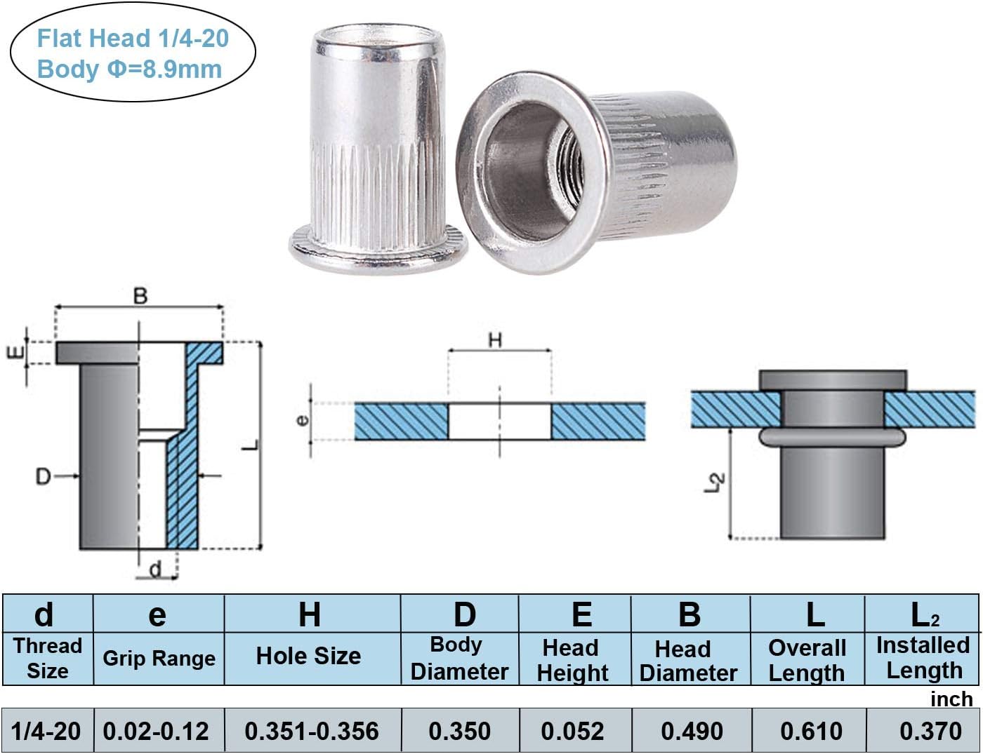

Yes, indeed, I had forgotten. You can get flush stainless steel rivet nuts, like this:
https://www.amazon.com/30PCs-Stainless-Insert-Nutsert-4-20UNC/dp/B077GQLQZ8
I haven't used them, but I imagine I would drill the hole in the aluminum to make a tight, interference fit with the knurl, coat the body with TEF Gel, pound it in with a hard plastic mallet, and tighten a bolt against it to pull the rivet in.
Wow, I have seen similar fixings for house hold fittings through a ceiling board but all plastic or galvanised... this is new to me!
Yawl learn noow thangs evryday! :)
Apr 22, 2011
949
Hunter 27 Pecan Grove, Oriental, NC
I have used the threaded inserts for use in wood, but never these for metal. Looks promising, except that they recommend a special tool to install which is a bit of a turnoff if only installing a few of them. I found this diy method on youtube.
