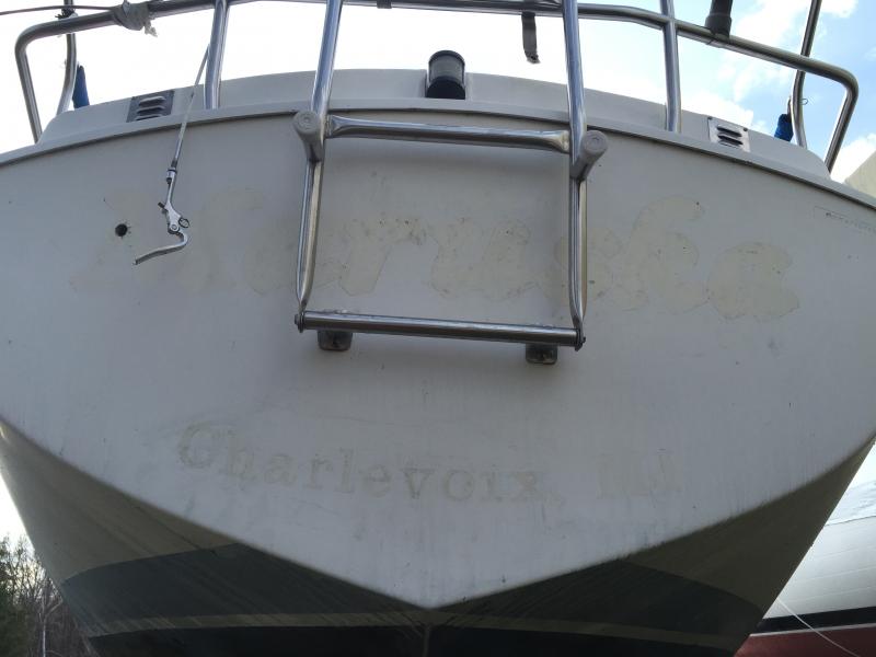

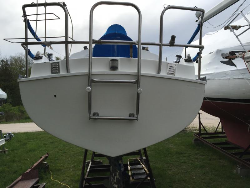

I had this same problem and I followed the suggestions already posted to follow MaineSail's buffing/polishing technique. I will add that after I removed the vinyl that I used 'Goo Gone' with a razor blade to get rid of the sticky residue. I then wet-sanded with 600, 800 and 1000 grit paper before buffing. I can still see a very faint outline of the old letters, which most people say will take lots of UV rays and time to completely fade. The new letters will cover a lot of it so I am cool with it. I have posted a 'before' and a 'halfway done' photo. I don't have an 'after' photo handy but I ended up removing the ladder and buffing twice with Presta gelcoat compound and once with Presta Cutting Creme. Removing the ladder made a big difference as I didn't have to navigate around the area where the ladder was mounted. I will upload some more photos when the new vinyl letters are installed. Hope this helps!
