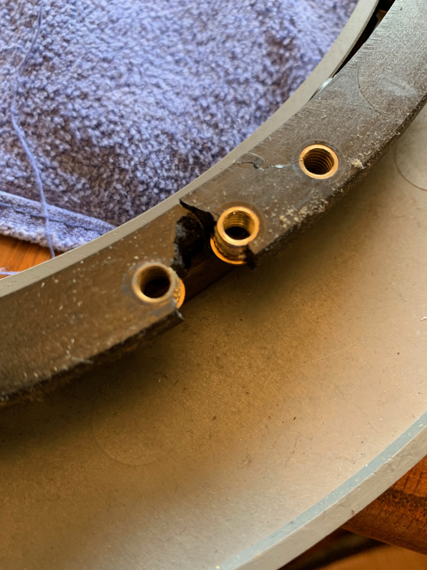

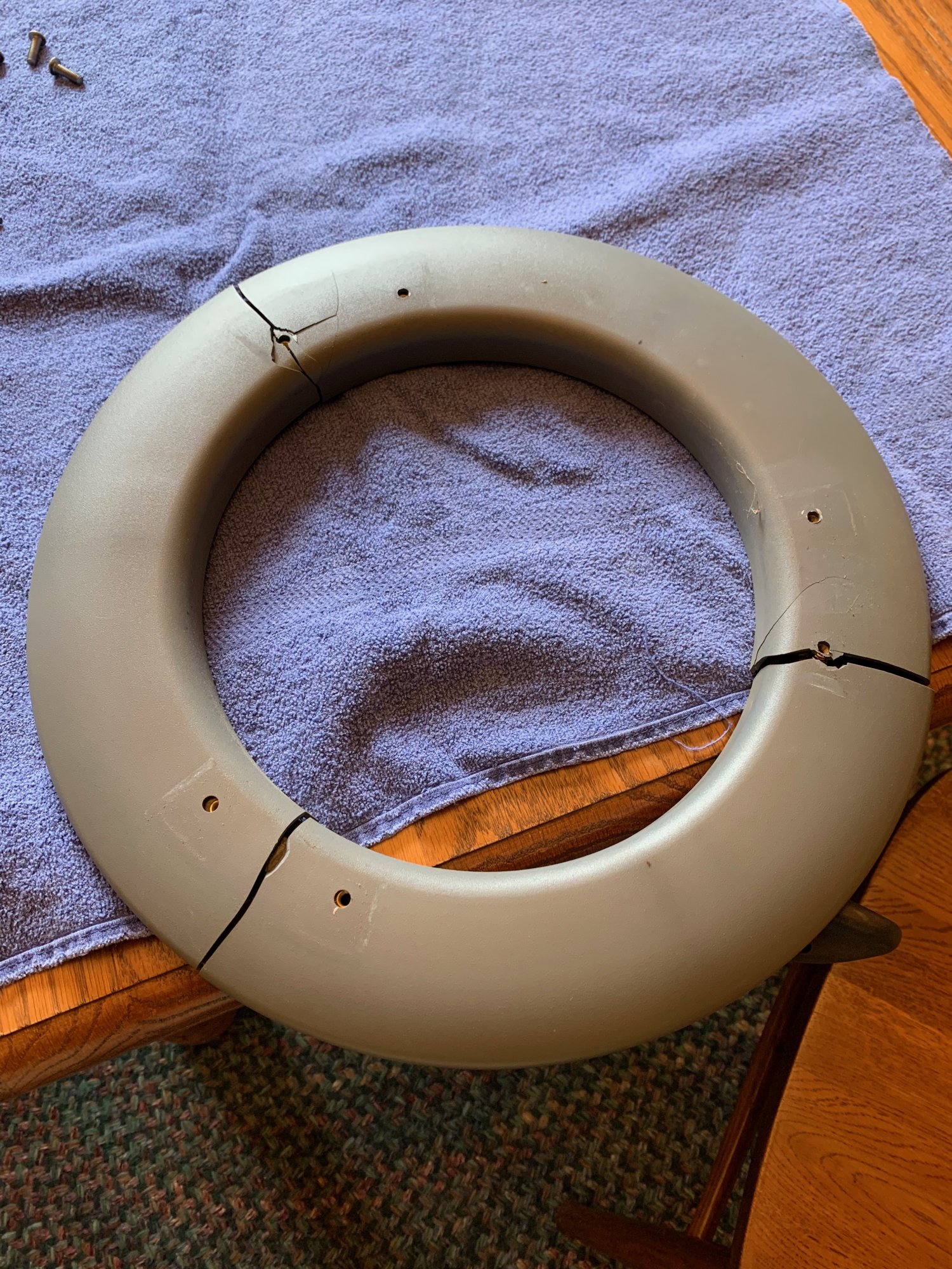

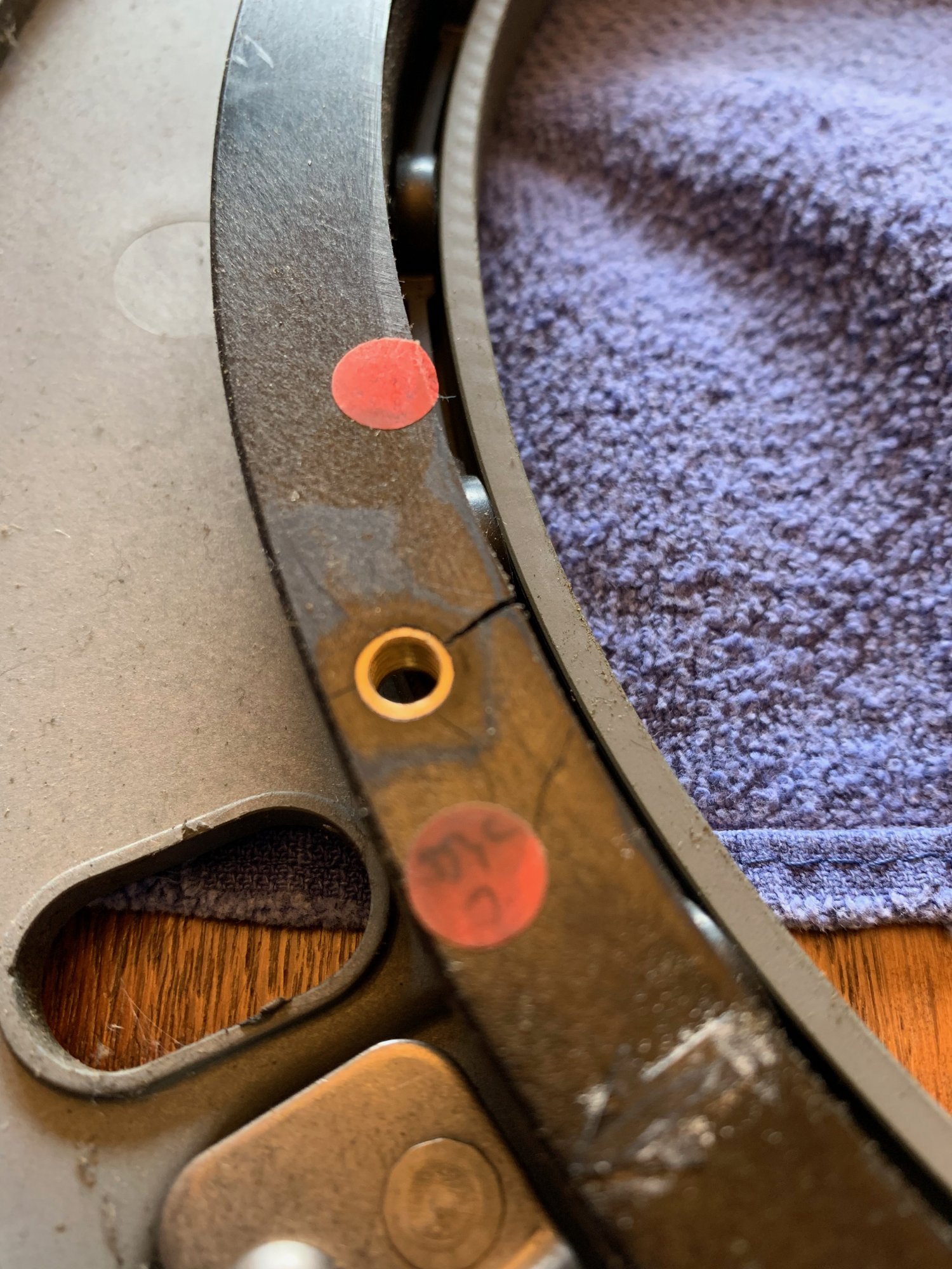

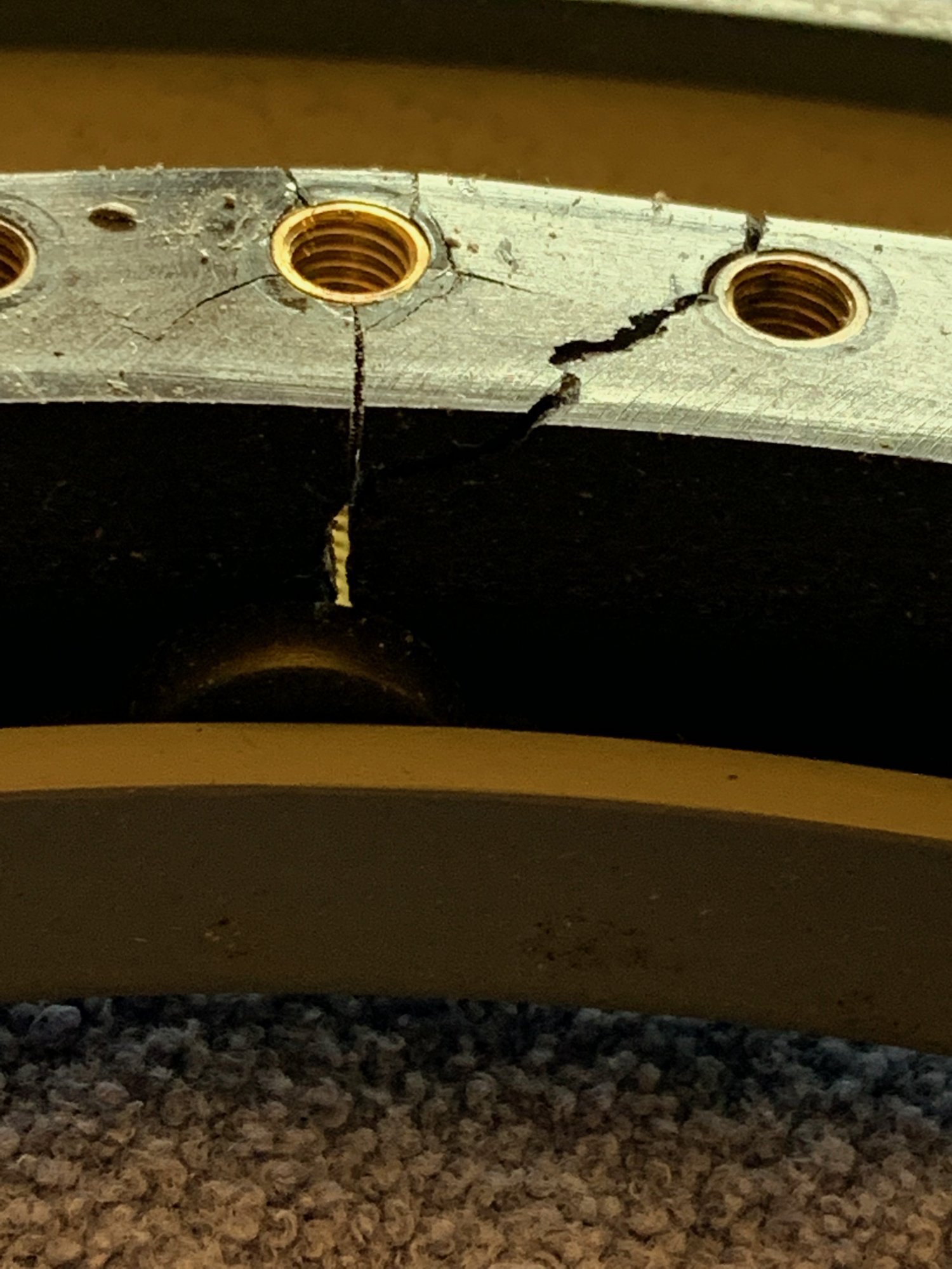

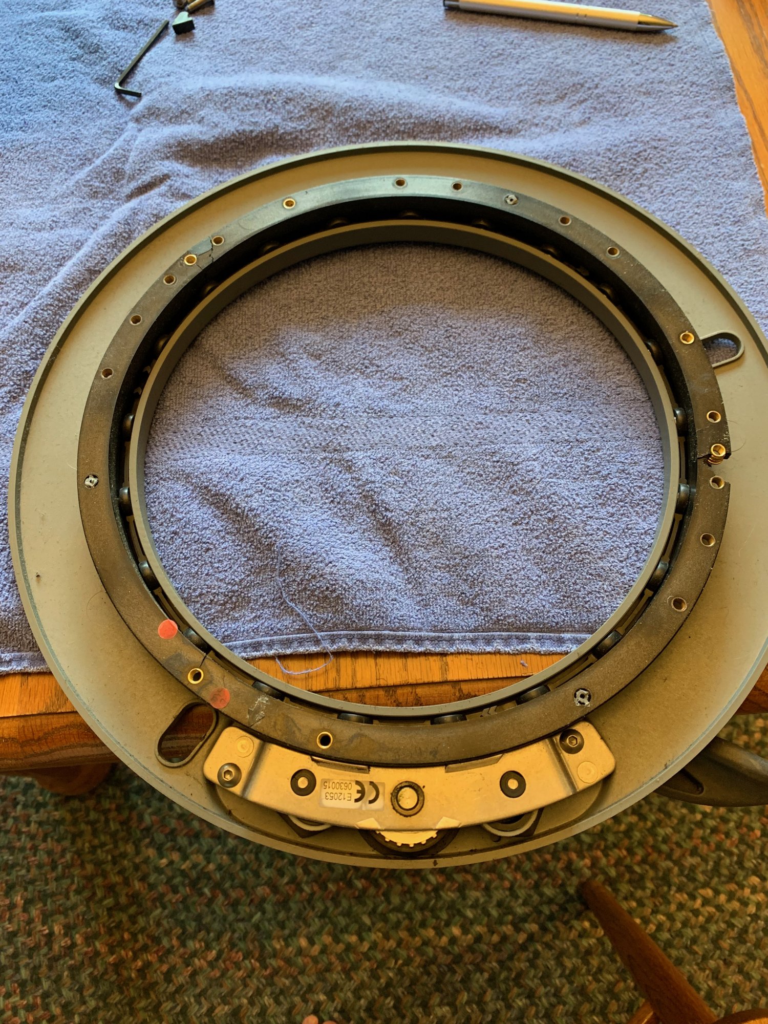

Took my folding wheel (w/autopilot) off and brought it home last weekend. It's a 2004 vintage Raymarine ST4000+ (MK2, I guess: gray) which has worked flawlessly for the past 17 or so years (3 on the hard), although it's always been squeaky from day one. I knew there was a crack in the dust cover (aft-facing gray plastic bit), but I thought I'd check for loose parts and maybe consider some epoxy to fix the crack. After unbolting it from the wheel, here's what I found:
Not only was the rear plastic cover (which seems to be just a dust cover) totally broken into 3 parts, but the thin black plastic ring with all the bolt sockets was broken or cracked at all 3 locations where it bolts to the wheel. Although I'd like to fix it... I think this hardware is trying to tell me something: it's tired and ready to retire. New one is on order. The funny thing is: this thing was working up until the moment I removed the wheel. I guess I can't complain.

There's 2 versions of the wheel drive, the old black ones were the Mk 1 newer gray ones like yours were the MK2 with a slightly larger diameter and motor and are current model available. I'm using a mk1 from 2002 and my back-up is even older from about 1995. Never seen one so completely disintegrate like that, if you keep the motor for a spare it'll probably guarantee you'll never need it, toss it and you'll need one.

Got the new autopilot drive installed on the wheel and back on the boat today, and took it out for a sail. I have to say, almost all the squeakiness is gone, both with the pilot engaged and (even better) when steering manually.This makes me very happy. I guess all the cracked bits weren't helping with the squeaks. Also had a perfect 16 knots of wind, gusting a bit higher, which made for a nice daysail!
Replacing the drive portion was well worth it. Quite an easy install.
