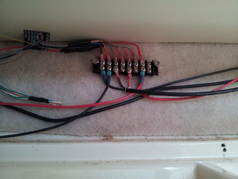

If that's the case it should be simple to fix as I have all of the connectors on a terminal block. Currently I have the pos 6 wired to port 2 NMEA+, and pos 5 wired to port 1 NMEA+ since it wouldn't work at all on the NMEA- connectors (unclear how it could even partially work wired like this, but it does). I'll move the pos 5 wire to the ground post and see how that works.

Swapped the wires around yesterday and everything works great now. Why the NMEA- wire on the tiller pilot connector even exists when it really just needs connected to ground, which could be more easily done internally I don't know, but at least it was an easy fix.
