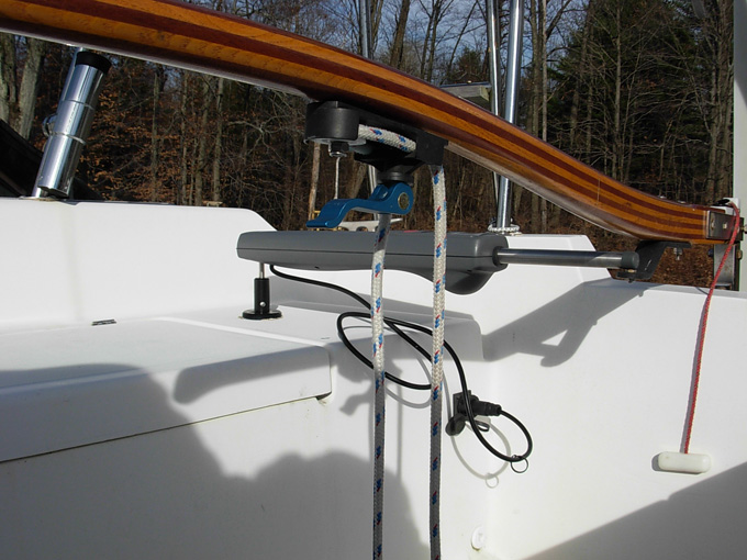

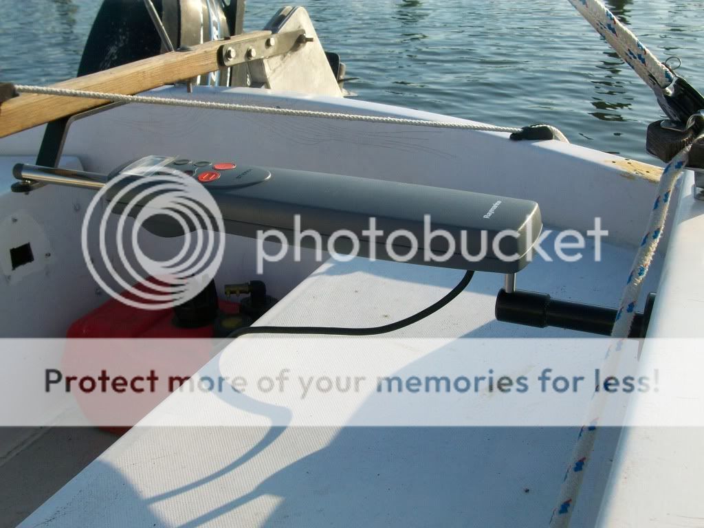

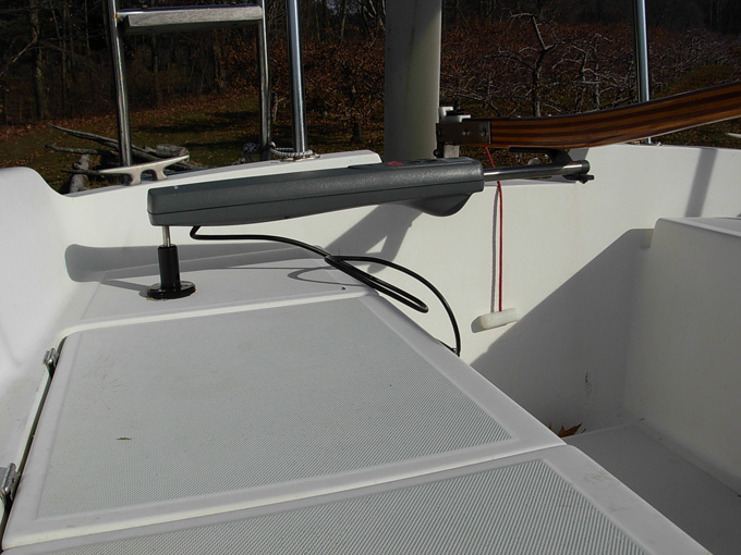

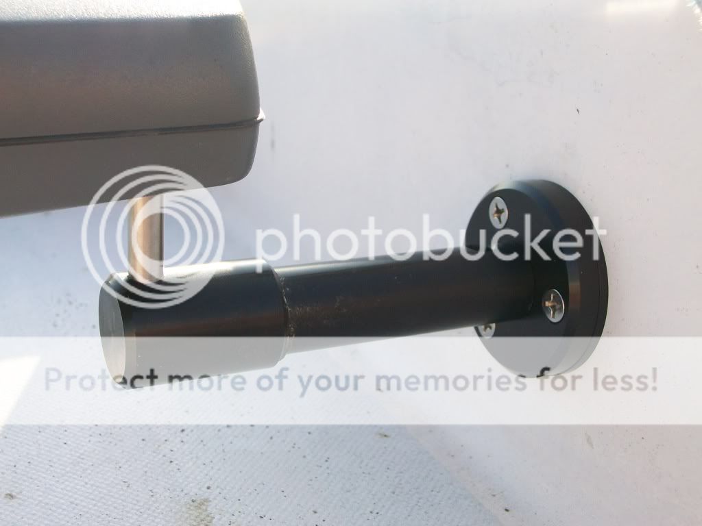

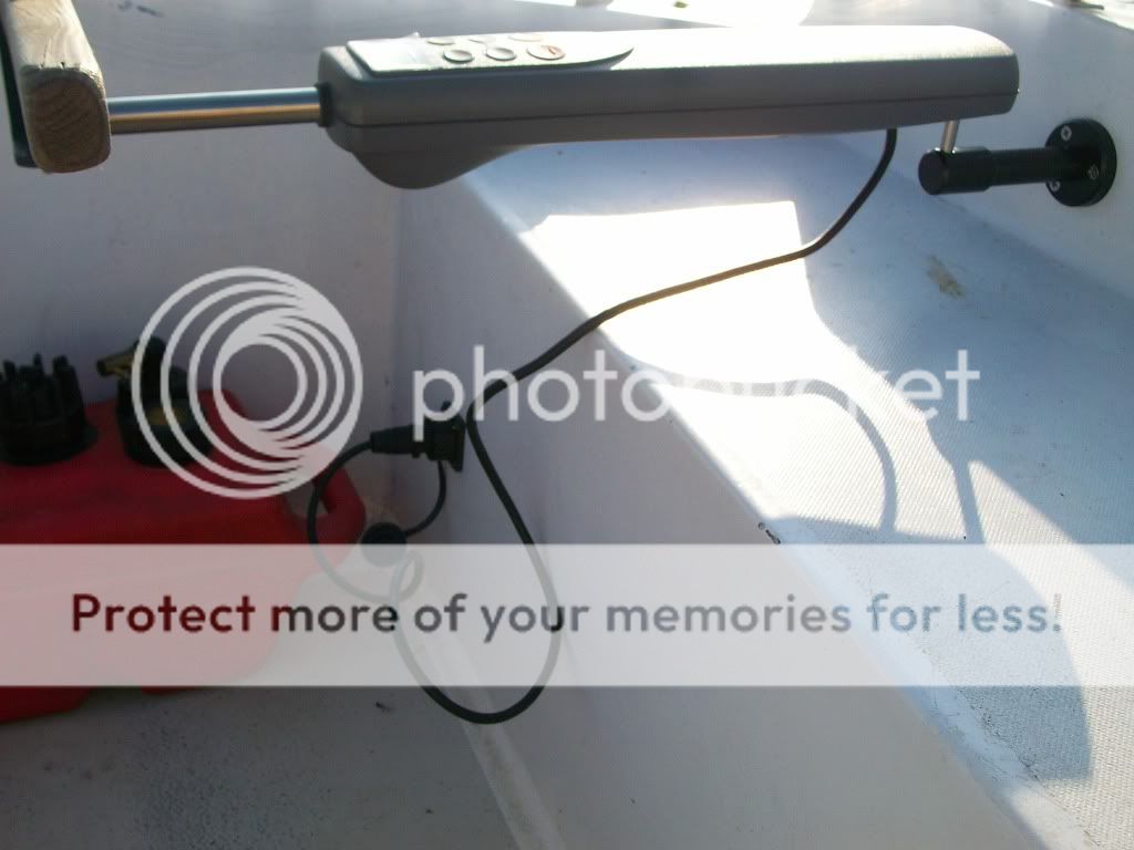

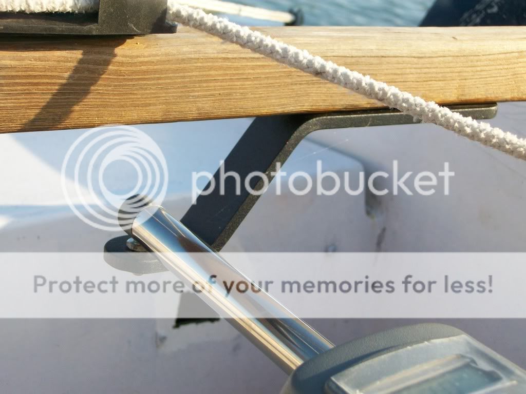

You need to decide where to place it. I have a straight tiller and I was able to install the metal pin on top of the tiller. If you have a curved tiller, you may need to buy the offset bar. When I first bought my original Autohelm AH-800, I had every intension of building my own stand off bracket to mount it on. A friend of mine built his also.

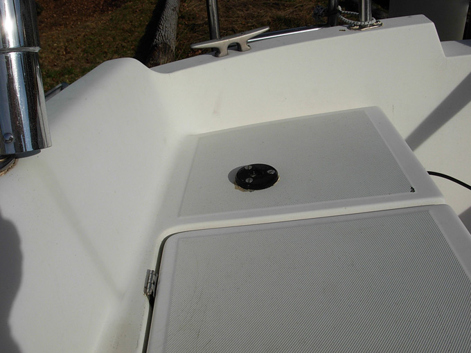

I wanted to place this bracket in a spot that I rarely need to access so I mounted it on the fuel compartment cover on the Starboard side. I'm forever needing to get into my lazarett on the Port side and it was for this reason that I chose the other side to mount this bracket on. Also, I enjoy sprawling out on the Port side while I'm sailing.
I mounted the receptacle on the inside transom. Back then, the Autohelm pilots had a flat plug push in type plug and there was no chance that it could get broken on the transom.
The ST 1000+ has a long screw on type plug and it needs to be placed where someone won't hit it and break it off. The inside transom on my boat is still the best spot for my receptacle and I stayed with that same spot when I bought my ST 1000+.
I really didn't know what I was going to need when I bought my first autopilot. I bought, read the directions, and just took it from there. The extras were expensive back then so I decided to build my own and try to get away cheap, but I took my time a thought everything through before I started the installation. Once you get an autopilot and start using it, you'll never want to sail without one.
