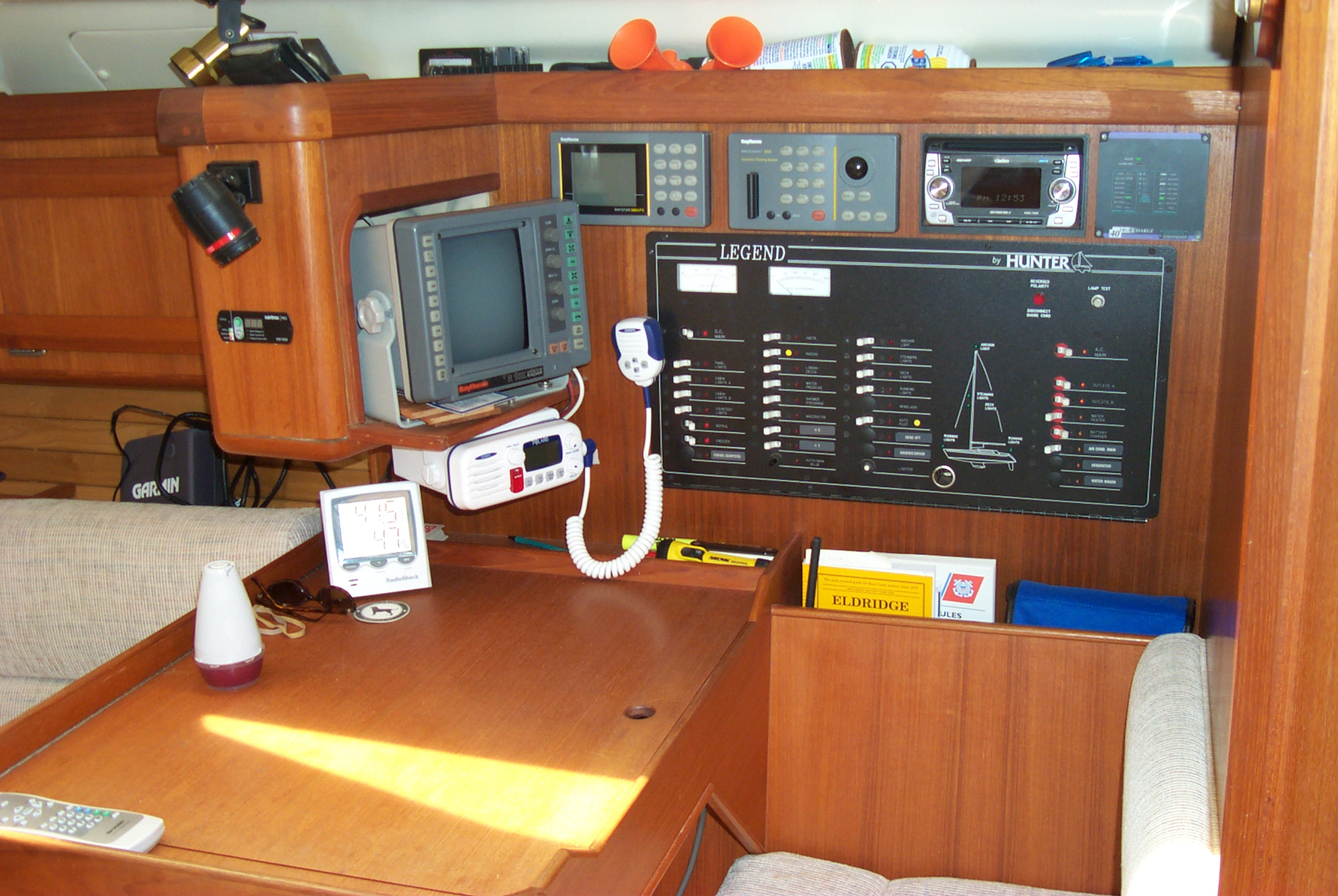

Where did you install it?
I'm at a loss trying to find a good place - do you have a picture you can share?

Wow Don, you sure have a full nav station. Here is what I did:
When I installed my C-80 radar/chartplotter, I located that unit in a Navpod at the wheel. I'm at the wheel 90% of the time I want to look at it anyway. Where you have your radar screen is where I have my communications center. I have a Standard Horizon Matrix VHF, the control head for the ICOM M802 and the external speaker all mounted on that "wall". The transceiver unit for the SSB is mounted inside the nav station seat, out of the way, but convienient enough that I can get to it if I need to for servicing. And it made running the cables and the copper foil to the ground VERY easy.
One of the reasons I liked the ICOM M802 was the separate control head from the transceiver. The footprint of the control head is about the same as a VHF radio, just not as deep. Makes for very easy and clean installations and the bulky transceiver can be stowed out of the way. Let me know if you want a picture, and I'll take my camera out this weekend and snap a photo for you.

Sent you a pm Karl - the 802 is definitely the way to go.
