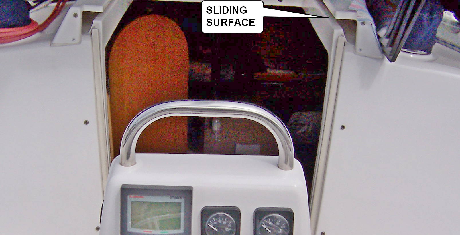

Take a pic as says @Project_Mayhem . Show the inside of slide mechanism under the companionway cover.
I can't see them going cheap on the slide. Mine has two 1/4" Starboard sliding runners on a FG rail. Nothing could be slicker or quieter.

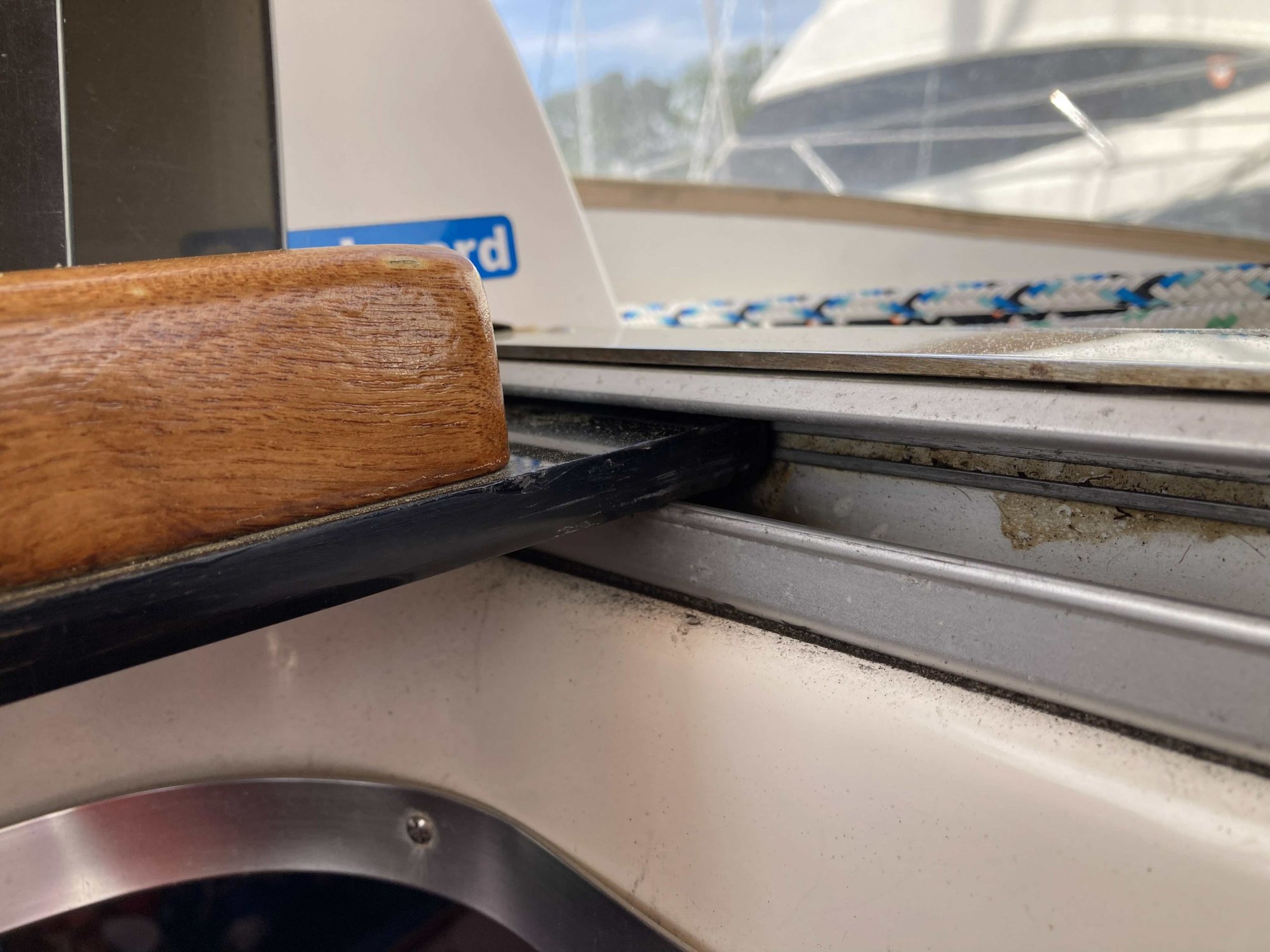

Thanks for the replies. Only the front of the slides are accessible - the part that squeaks seems (can't be sure) to be under a large cover that I'm hoping I don't have to remove. But maybe that's the only option.
The slide mechanism is simple - it just slides against a metal rail. The dirt is dried lubricant that someone thought would solve the problem (and didn't).

Certainly quite different from my 1999 H-310 :
Sorry I don't have a pic with the cover in the closed position. As mentioned, the cover has a Starboard runner screwed to the underside on each side. So the Starboard on FG is as slick as they come.
I would imagine that each of your aluminum slides is grinding a groove into the acrylic and as the groove becomes deeper, the noise becomes louder.
If you are after a permanent solution, you may have to go that route. Once the cover is off, your options become much greater. Maybe a runner of Starboard to run on the aluminum strip ? Although the minimum Stbrd would be 1/4". Grind off the aluminum rail and replace with Stbrd ?

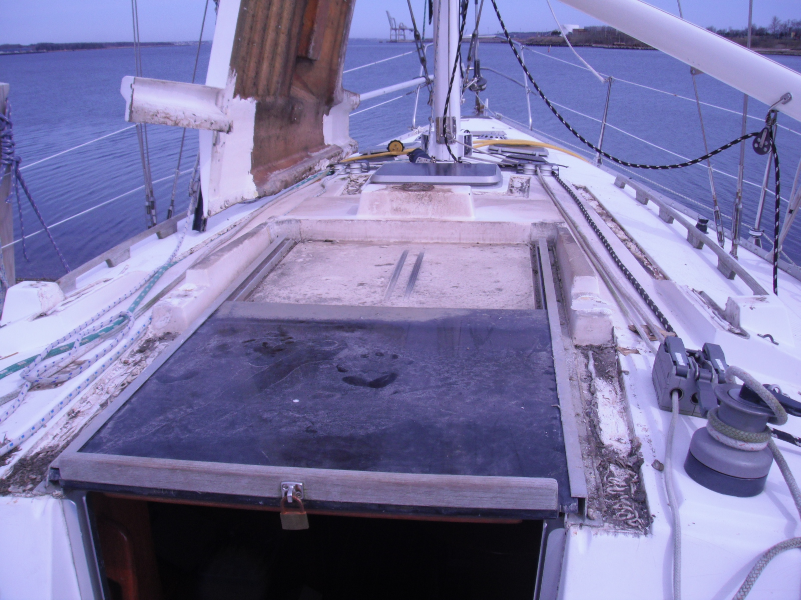

My cover used to squeak but not from the side slides. It was from the "backstop", a piece of teak screwed onto the underside of the front edge of the slider . It keeps the slider from going too far aft ..I had to remove the sea hood to get at it... Attached picture is from a forum member's boat showing the sea hood off and clearly showing the marks of the backstop on the deck. My boat looked exactly like that.. The noise was made worse by the dirt and stuff trapped in the pocket under the backstop. I don't know if your boat has a similar setup, but with a little creative investigation, you should be able to determine exactly what is making the noise.. it may not be the side slides since lube on them doesn't have an effect.
