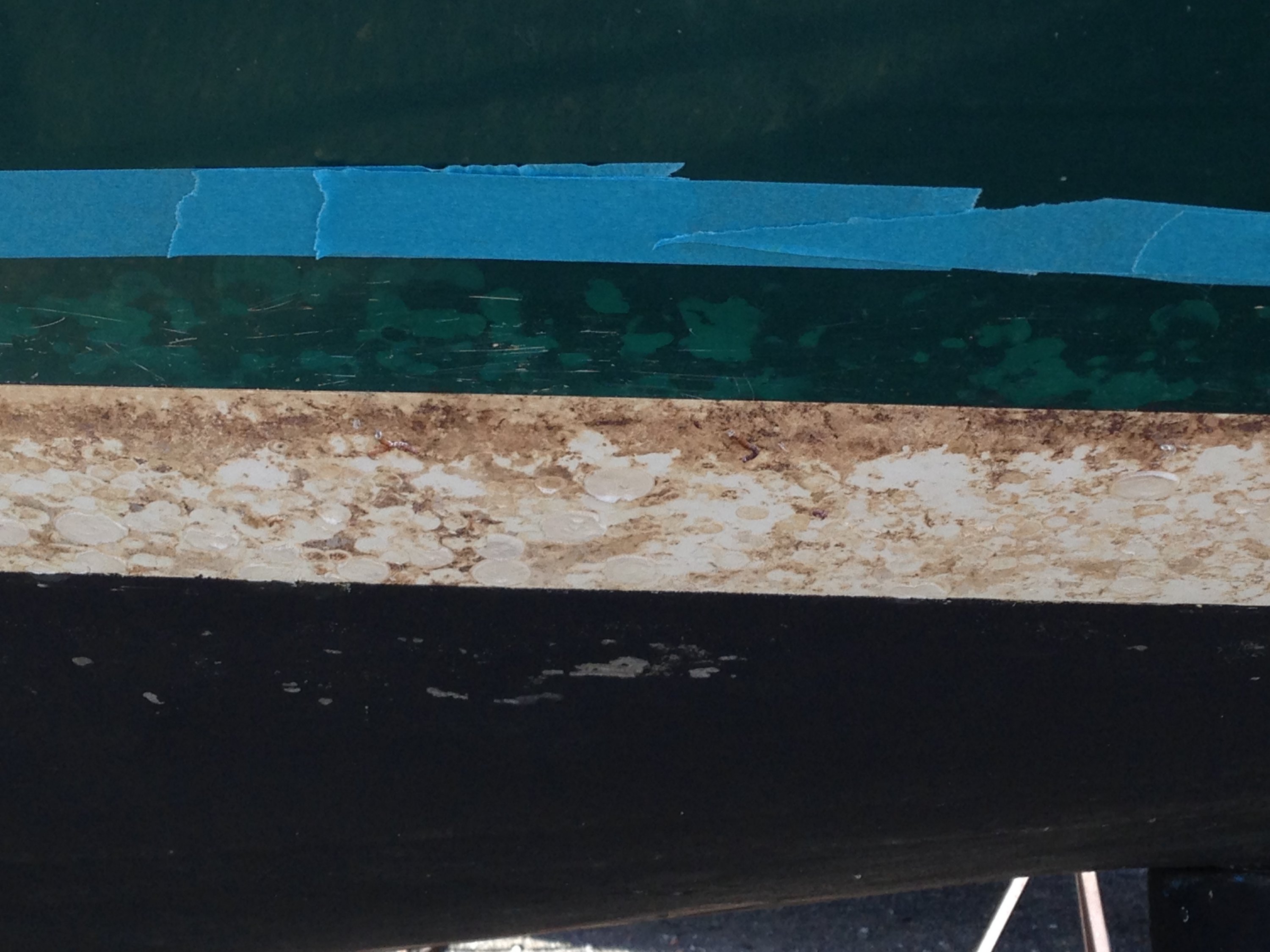

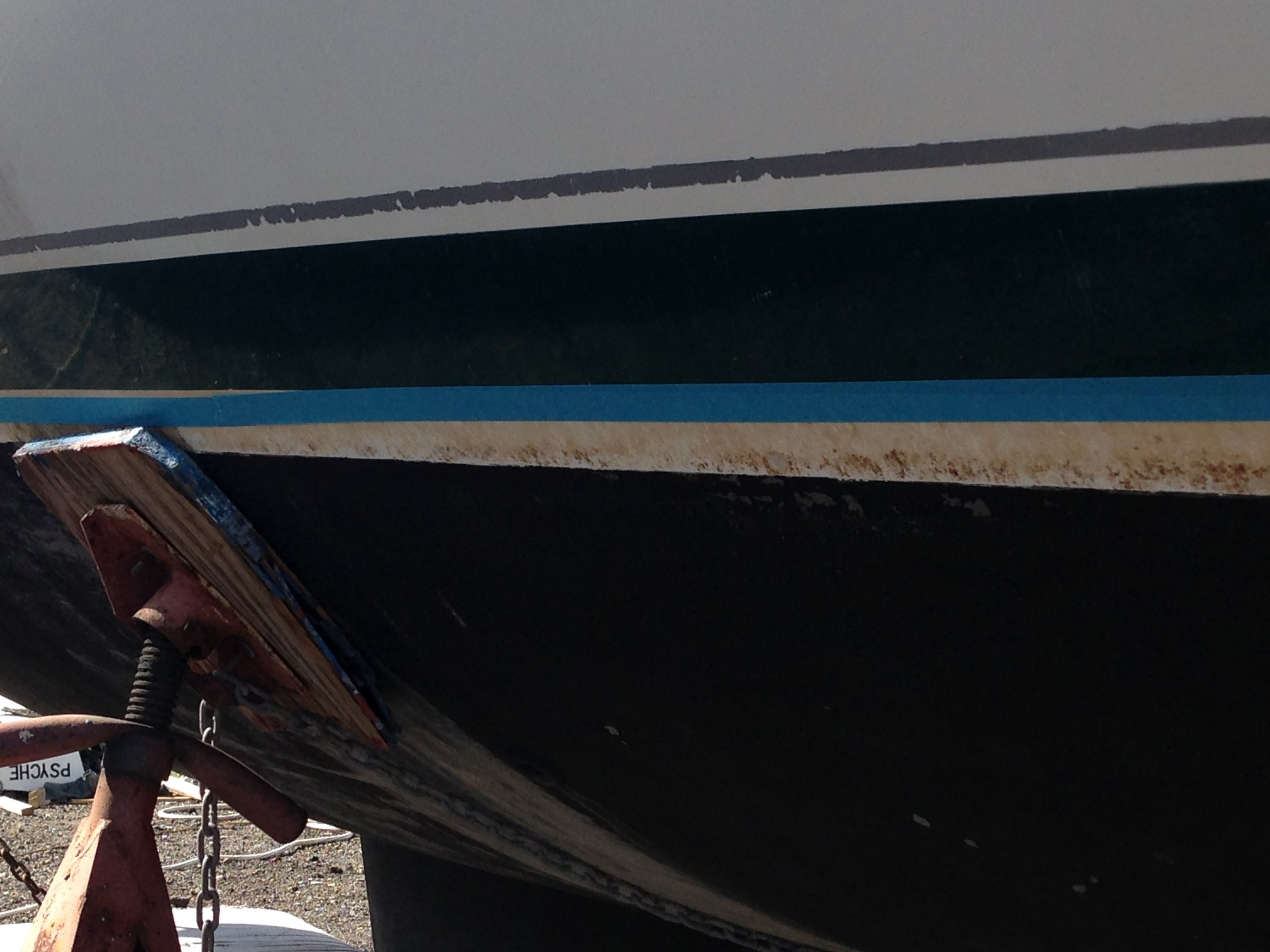

So, I have an issue or at least I think I have one, my boat squats. As in the description it is a 1998 Oceanis 352 and she sits low aft, below the boot stripe. I have 30ft of chain in the anchor locker and 100ft of rode, only use the forward water tank, 1 8d lead acid battery aft (instead of the original 2 8ds) but still the boat sits low aft, above the original painted waterline. My question is what should I do about it, if anything. I do get growth on the bottom, but have no blisters or gelcoat damage. Should I put on a barrier coat and then bottom paint or just clean up the affected area and launch.

To the OP.... assuming a new boat to you? How long has it been like this? It is possible that the stripe was drawn incorrectly from the get-go and its sitting correctly. Do you have any other evidence (visual or otherwise) that the boat is really off her lines?

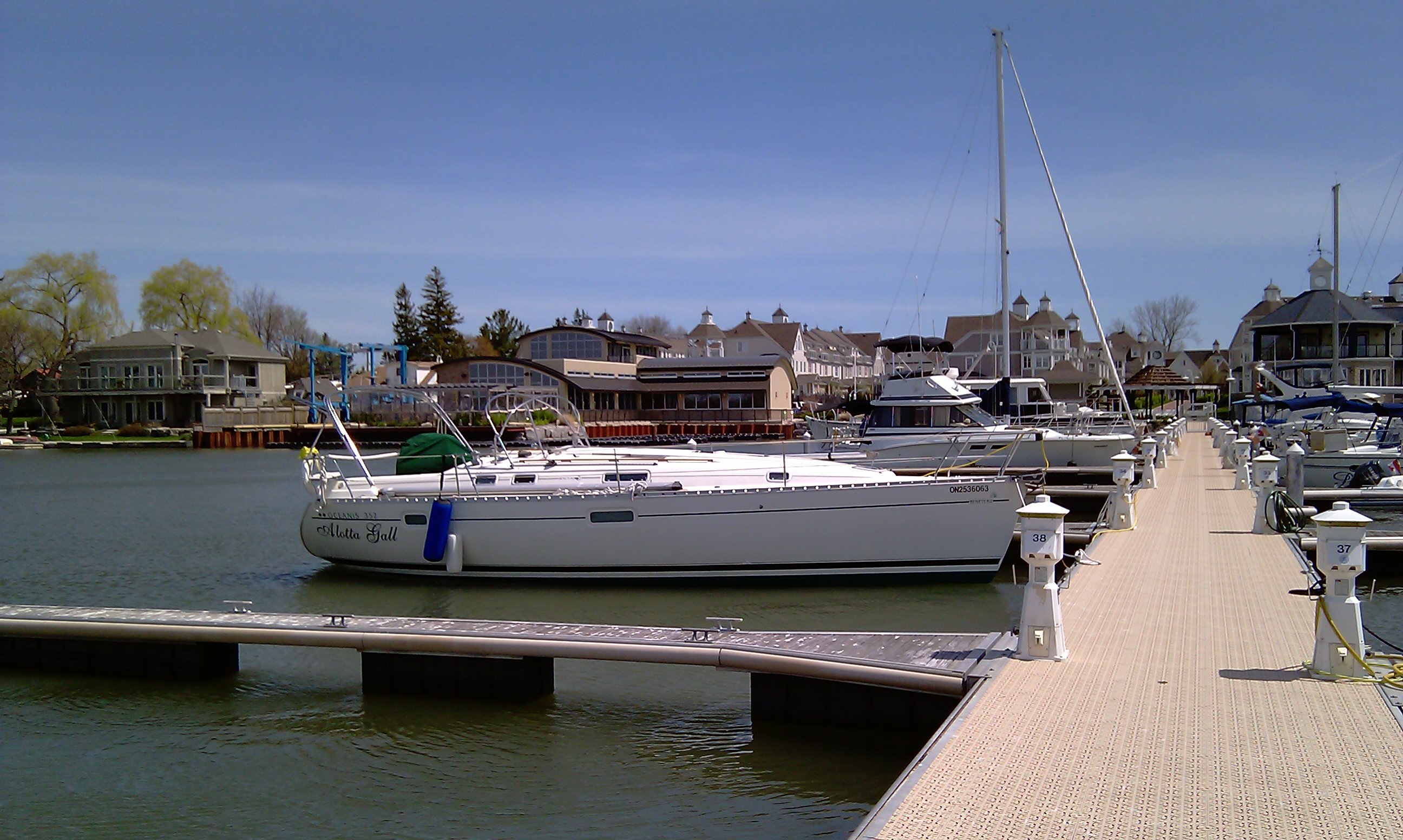

For reference this is how my 352 sits in the water with no mast. No water in the forward tank and water in the port aft tank (50 Gallons) that balances out the 2x 4D batteries on the starboard side.

OK rudder is bone dry, material removed was bone dry. I am thinking the lines are wrong, it looks nice in a showroom but not actually the way the boat sits in the water.
