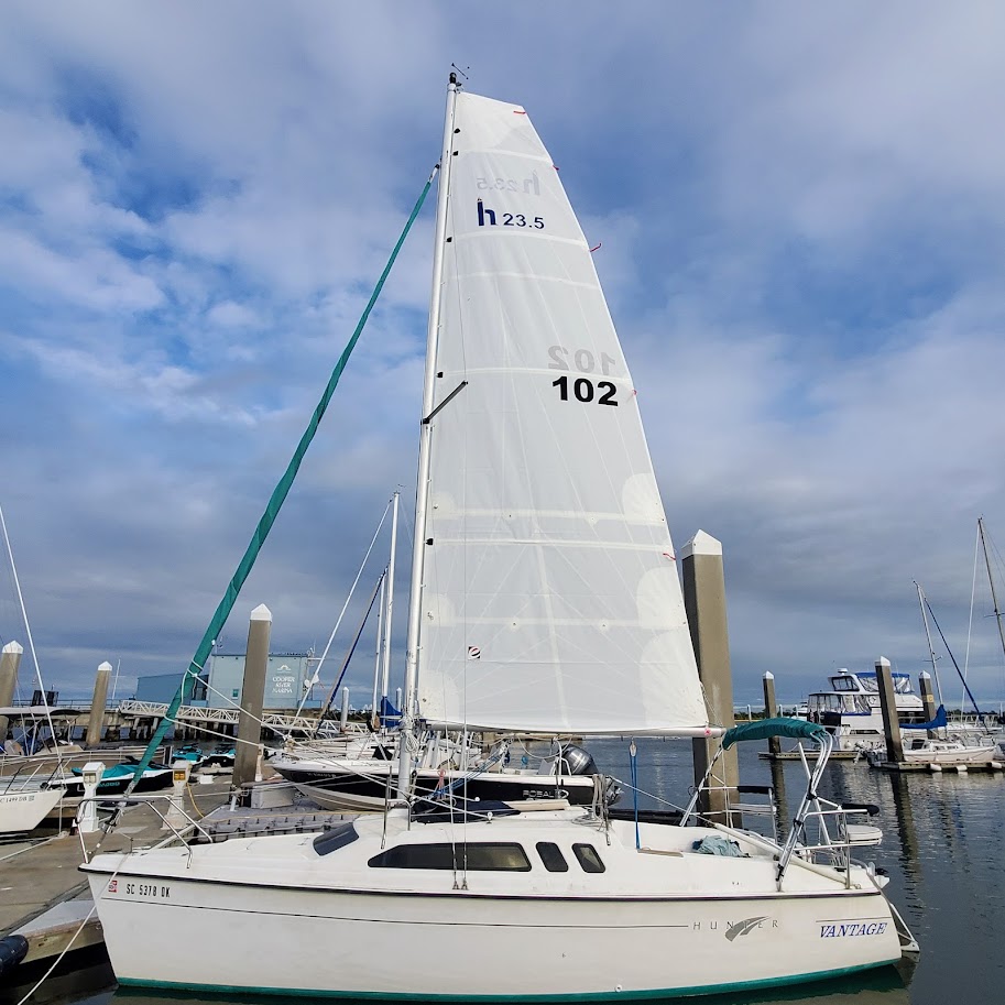

I have one on order :cool:
I discussed square top vs roachy main with my sailmaker. He suggested that the square top will spill excess wind automatically, allowing you to pull the vang down tight and manage heeling with the mainsheet. I'm also adding a cunningham and switching to loose foot, which will give better options for tuning sail shape.

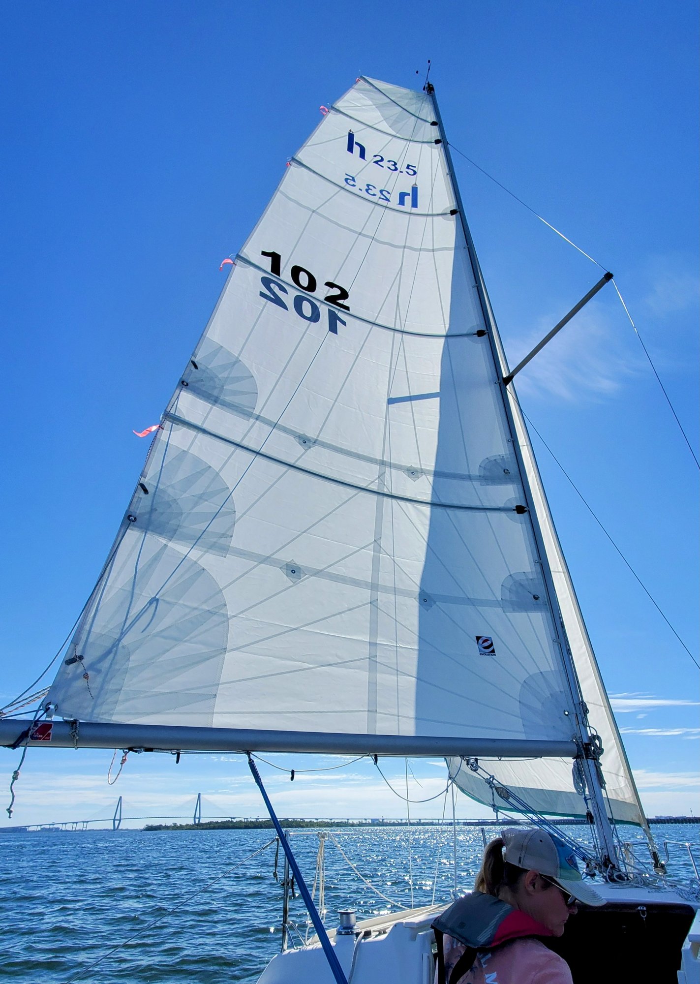

Who built the sail? I can’t make out that insignia.
Looks good to me. Nice tri-radial design, reinforced attachment points and a very nice draft forward shape.

I am fortunate to have an Evolution loft right here in Charleston. They did the measurements and design and even showed me how to install the battens. The top "Gaff" batten has to be removed to put the boom cover on! Even still it looks like I'm going to need a bigger cover.
I spent some time rearranging things in the boom to rig the 2nd reef but didn't need it in the strong breeze yesterday. The top twists off as advertised and the full length battens keep the luff from flapping when the sheet is eased. I was worried the extra sail area would increase weather helm but the tiller was nicely balanced.
Altogether a happy customer

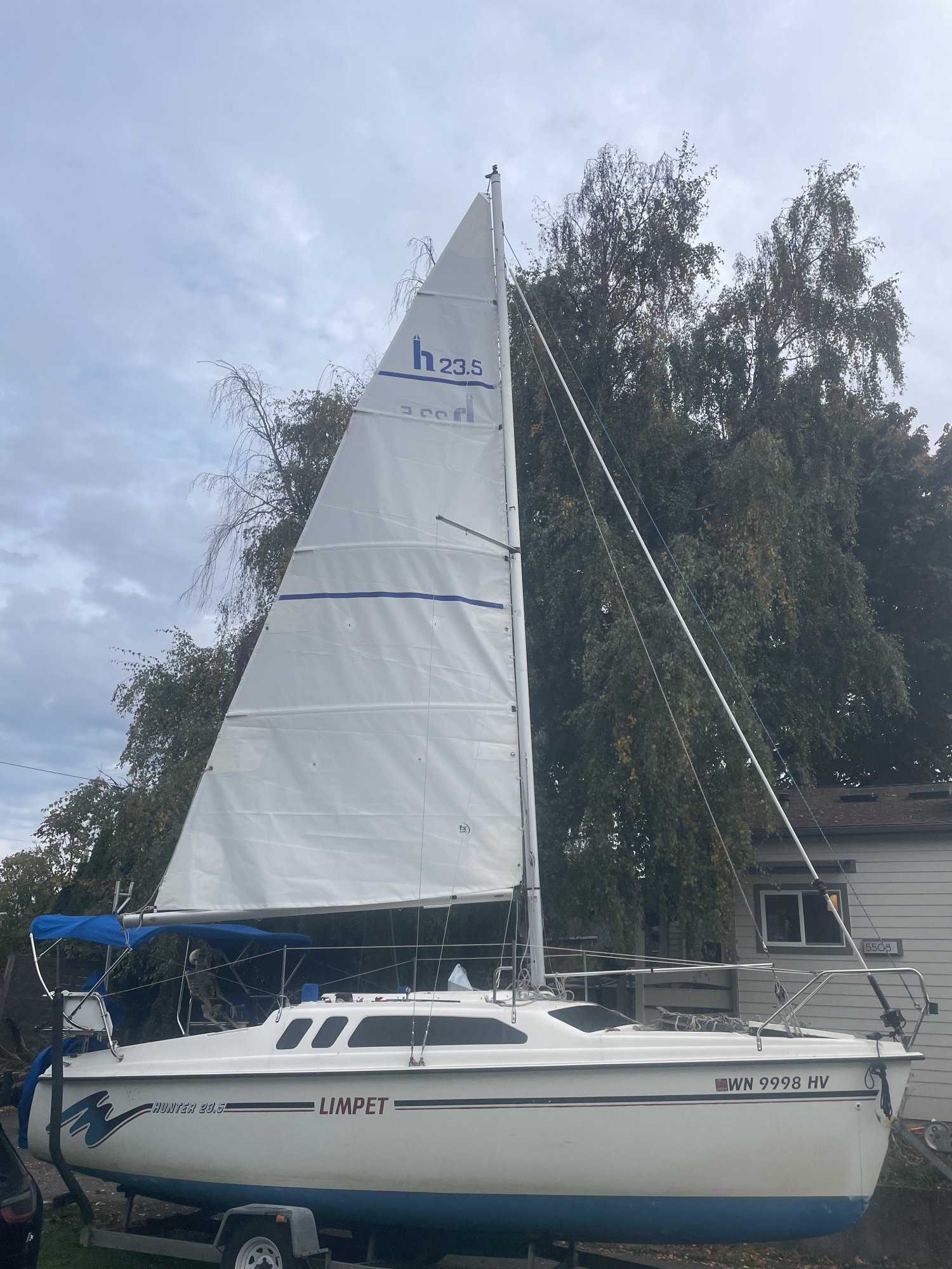

So after starting this thread I ordered a NON square-top main.
The bids I got were more than double the bids for a “normal” sail, so I just went with that. Pic attached.
2 reef points is going to be a big upgrade, as we sail in heavy air quite a bit and adding a BOOMKICKER freed up one of the in-boom lines for the second reef.
The new main must have a slightly longer leech, as it now hits our bimini. I raked the mast forward a bit, and may have to cut down the bimini frame just a bit, but then it will fit.
