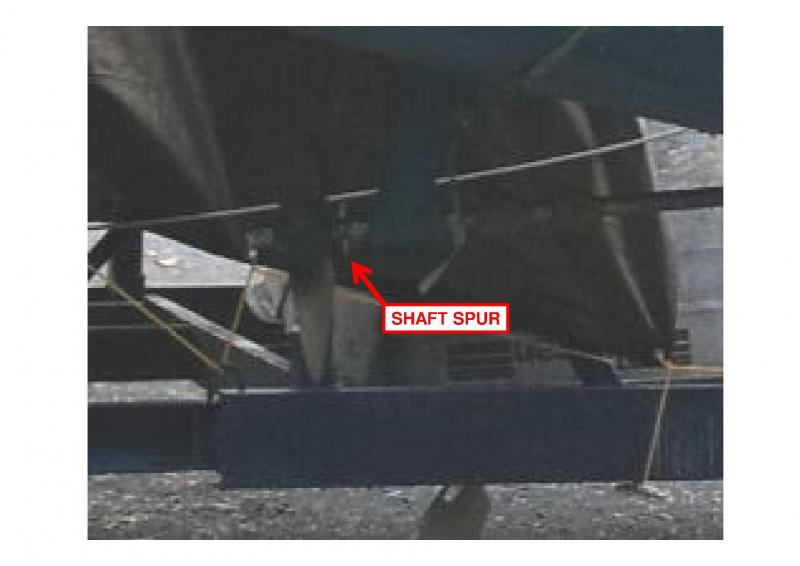

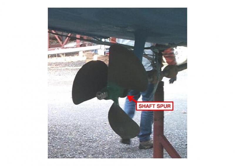

My spur is about 1" thick (in your description would it be wide?). The distance between my prop and the strut is between 1.75" and 2". If the OD of the spur is wider than the hub of the prop it helps cutting the line quicker. Sorry for the quality of the 2 pictures but they should give you an idea.

nice! I measured the width and its 1inch and 2/16
