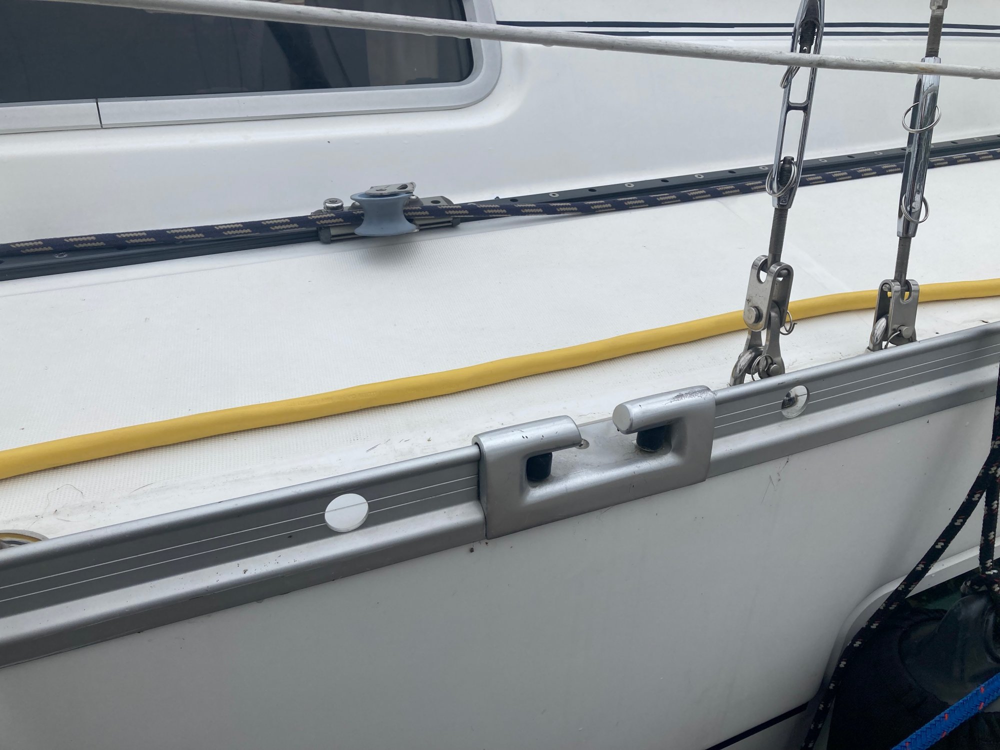

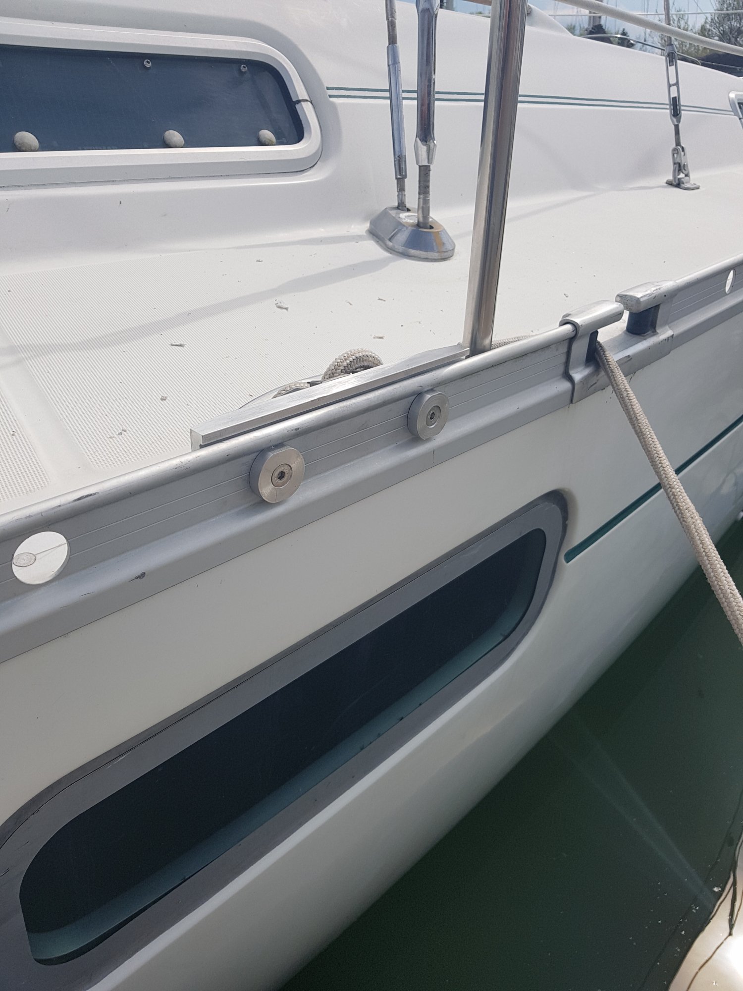

Jul 19, 2013
388
Pearson 31-2 Boston
Made my own 6 years ago no issues. Fold in when not in use

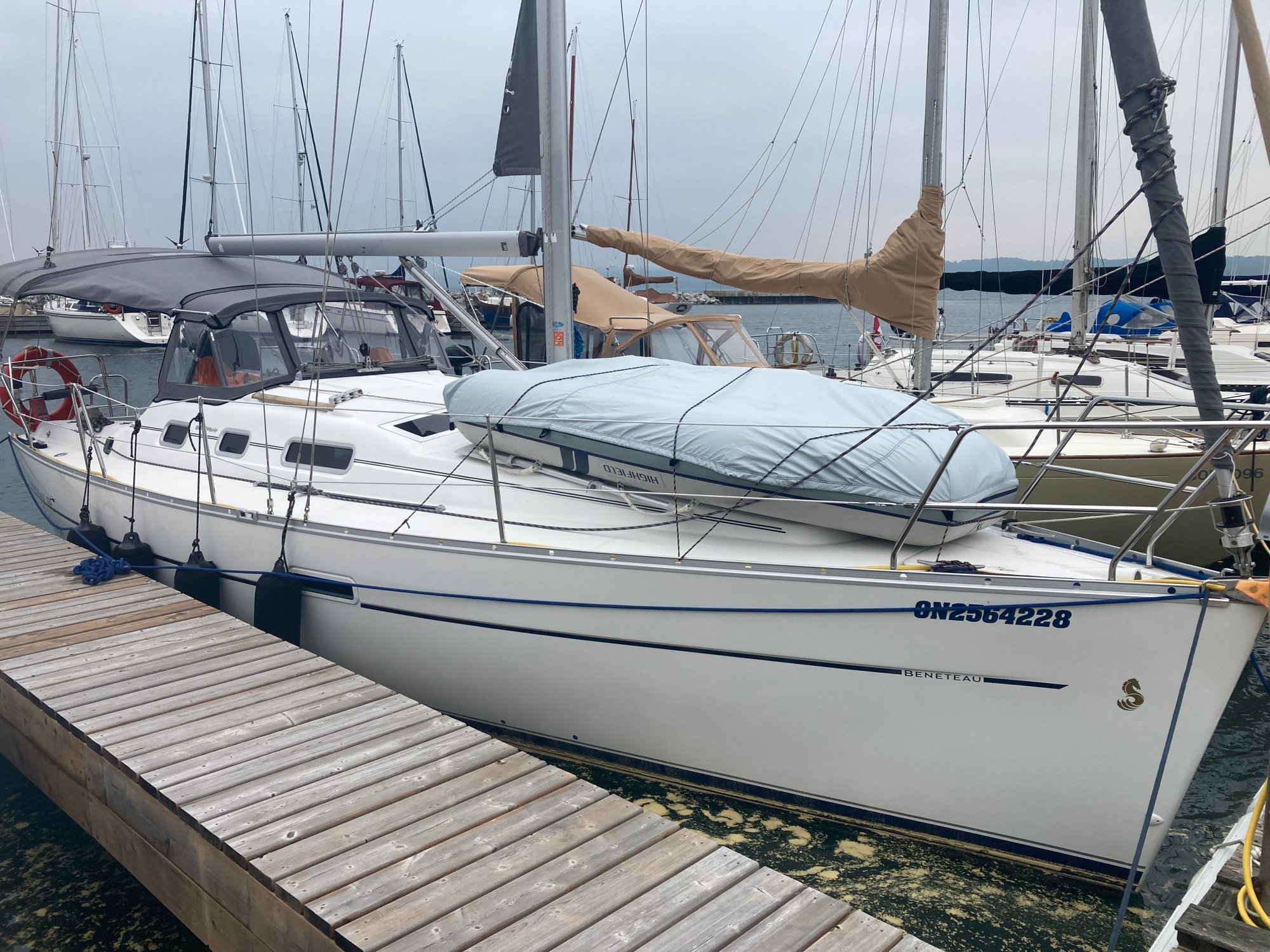

FWIW you should tape up those split rings on your turnbuckles, or a sheet may snag one and remove it, leading to an unpleasant result.

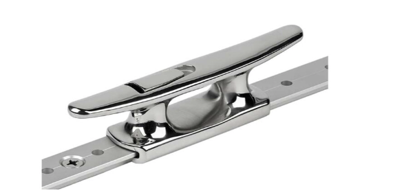

As to the midships cleat, the OP can buy an adjustable cleat to fit on the jib track if the OP doesn't want to do the popup install.

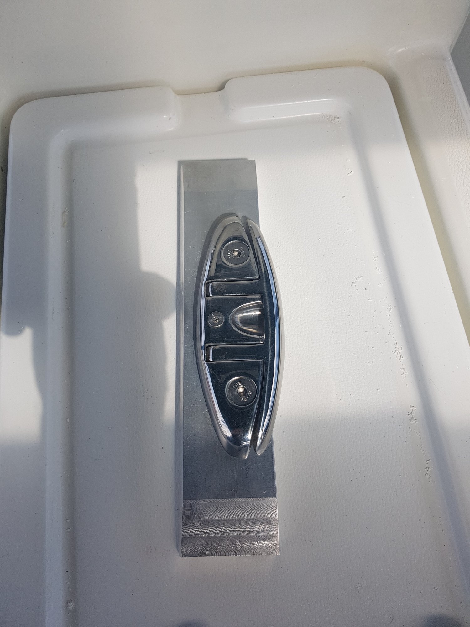

23,782
There are several designs for the folding cleat.
Here is one I recently discovered.
I put a pair on my boat similar to @Mechone. They were rated at 4,000lbs. Lived through a 60 knot wind storm without any wear apparent wear.
I used a 1/4” thick aluminum backing plate beneath the deck.
Love the versatility they give me for docking or tying up in my slip.

The whole point of my design is there was no drilling or modification of the boat , and yes its been through 60knot winds and the rings not in place on turnbuckles the mast was just stepped and being tuned as I unstep and restep every year and that pic is 6 years old ,but thanks for the comment
