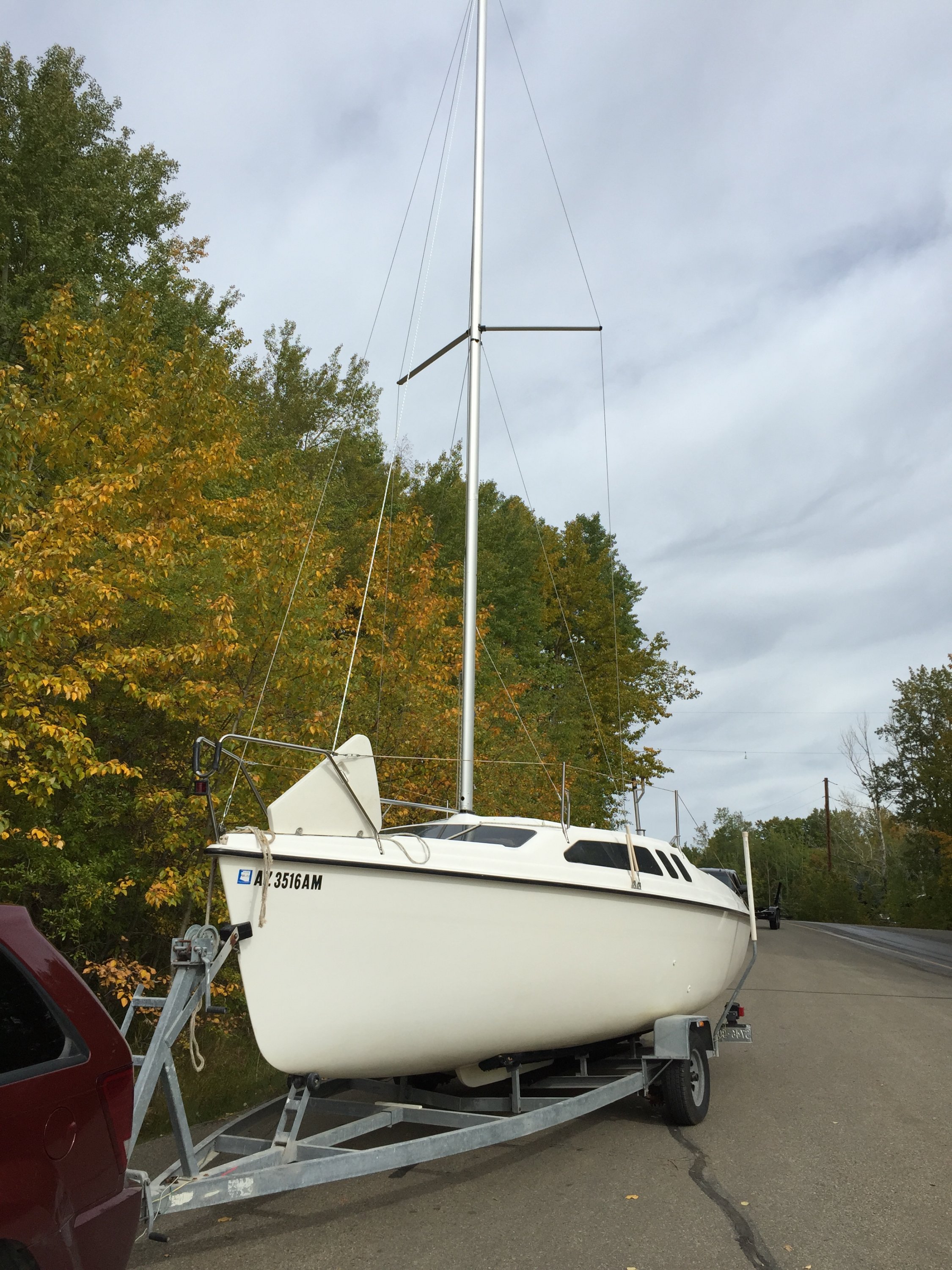

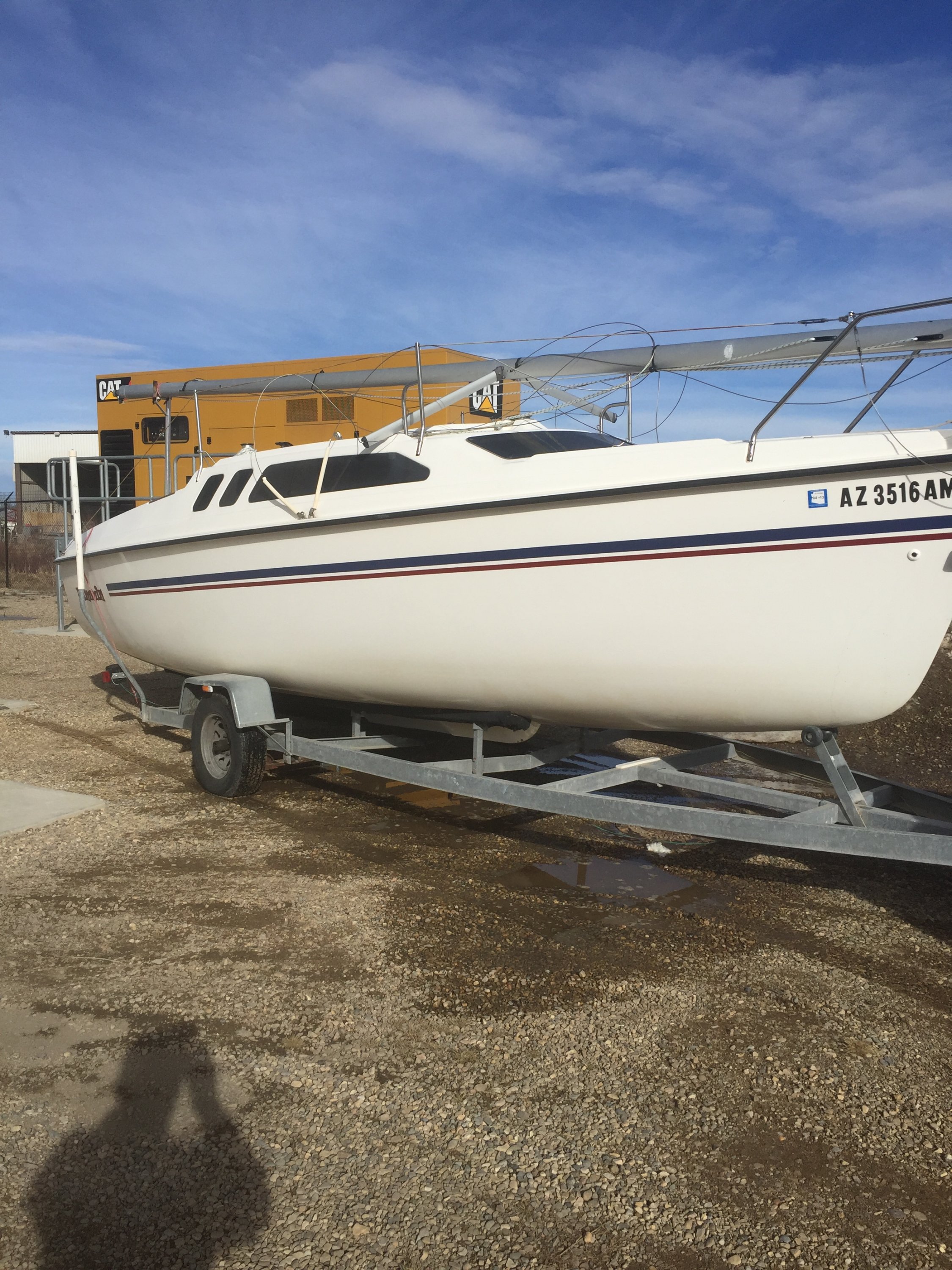

Well spring has arrived in Alberta, snow has melted, so it is time to start tinkering with the boat, instead of web sailing through out the winter months.
I bought our Hunter late last summer and the former owner removed all the striping and decals, so I had a nice clean slate.
I dressed our boat up with a few new stripes, and I'm pleased how it looks.

Good looking boat. Your trailer fenders are really close. I would put carpet on those fender edges.

+1 on those fenders, but I wouldn't depend on carpet to prevent the boat from bouncing on them. Raise the boat or get fenders with a radiused corner. I always thought if I owned a Hunter, I'd duplicate that "Flying Tiger" mouth, put it properly on the bow, and call it "Horizon Hunter". But, I discovered Beneteaus first.

FWIW, we used to have a hunter 23.5, and the fenders on the trailer were never an issue, though it looks it from his pic.

The fenders on my V-222 were about that close to the hull. After one or two trips to the ocean I noticed quite a gouge on the side. I added 2x6s to the bunks to raise it 1-5/8". One of the best trailer mods for that boat.

Don't have any issues with the fenders being close, this is a factory trailer, the fenders were bend a bit but easy to straighten out.
I will have to repack the bearings or replace them and re do the wireing on the trailer as it looks like a rats nest.

Nice job. The trailer was built by Hunter after many issues with a local vendor that built the earlier trailers whose fenders use to fall off. The support was a major issue with KWS which is why you saw them on your trailer. As for bearings, I always suggested that yiou constantly check them to see if overheating by simply touching. Some warmth is natural but hot to the touch, you got problems.

Thanks CD,
Just repacked the bearings the other day, so I'm thinking I'm good to hit the road.
Hoping to take her to Flathead lake Montana a 360mile trip oneway.
