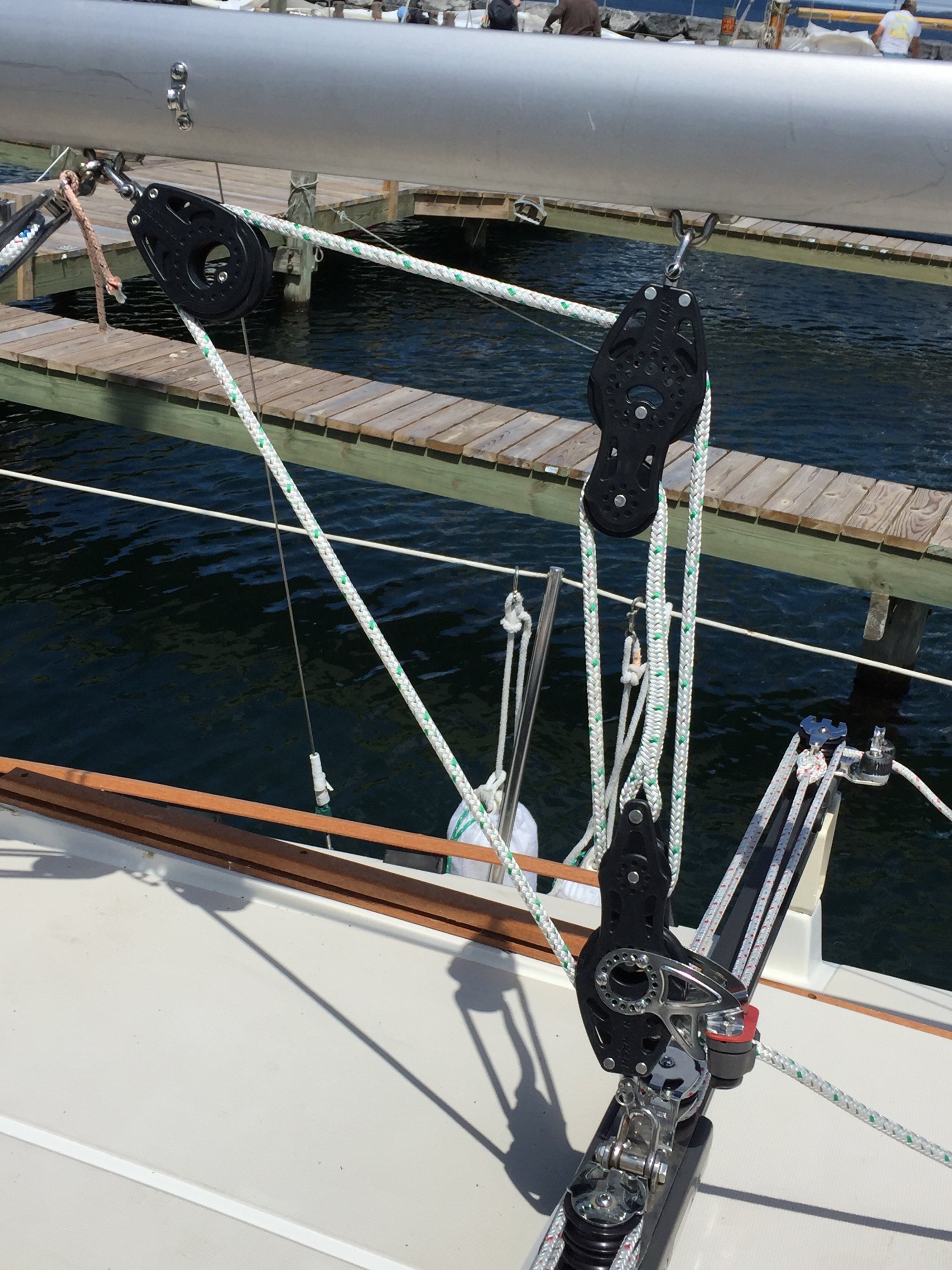

Garhauer Flat Traveler with controls
Custom SS traveler Risers
4-1 mainsheet block

4-1 outhaul led aft

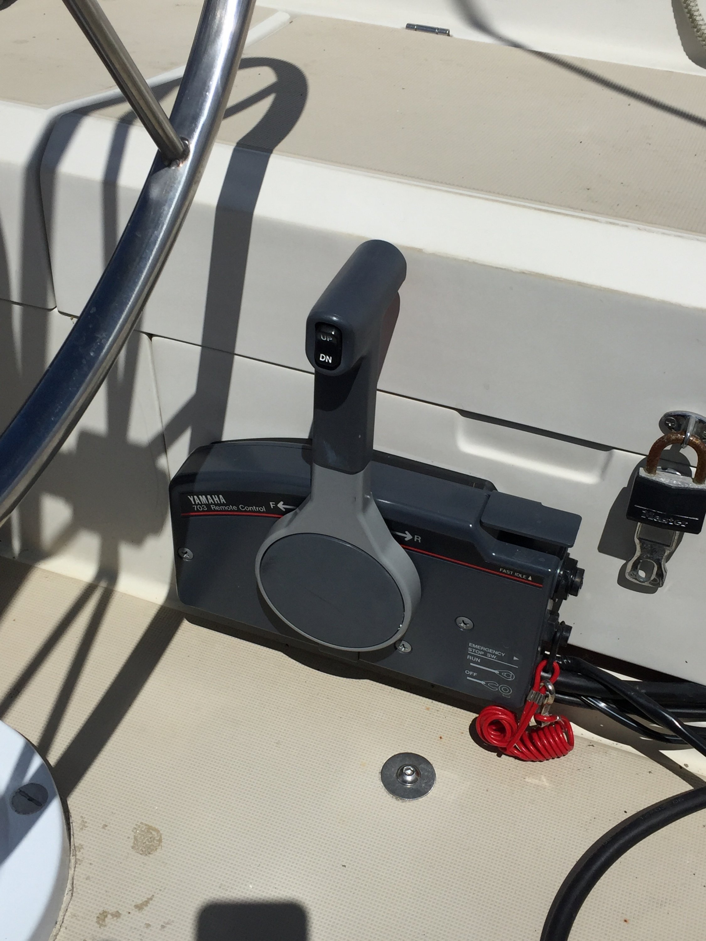

Remote throttle for cockpit

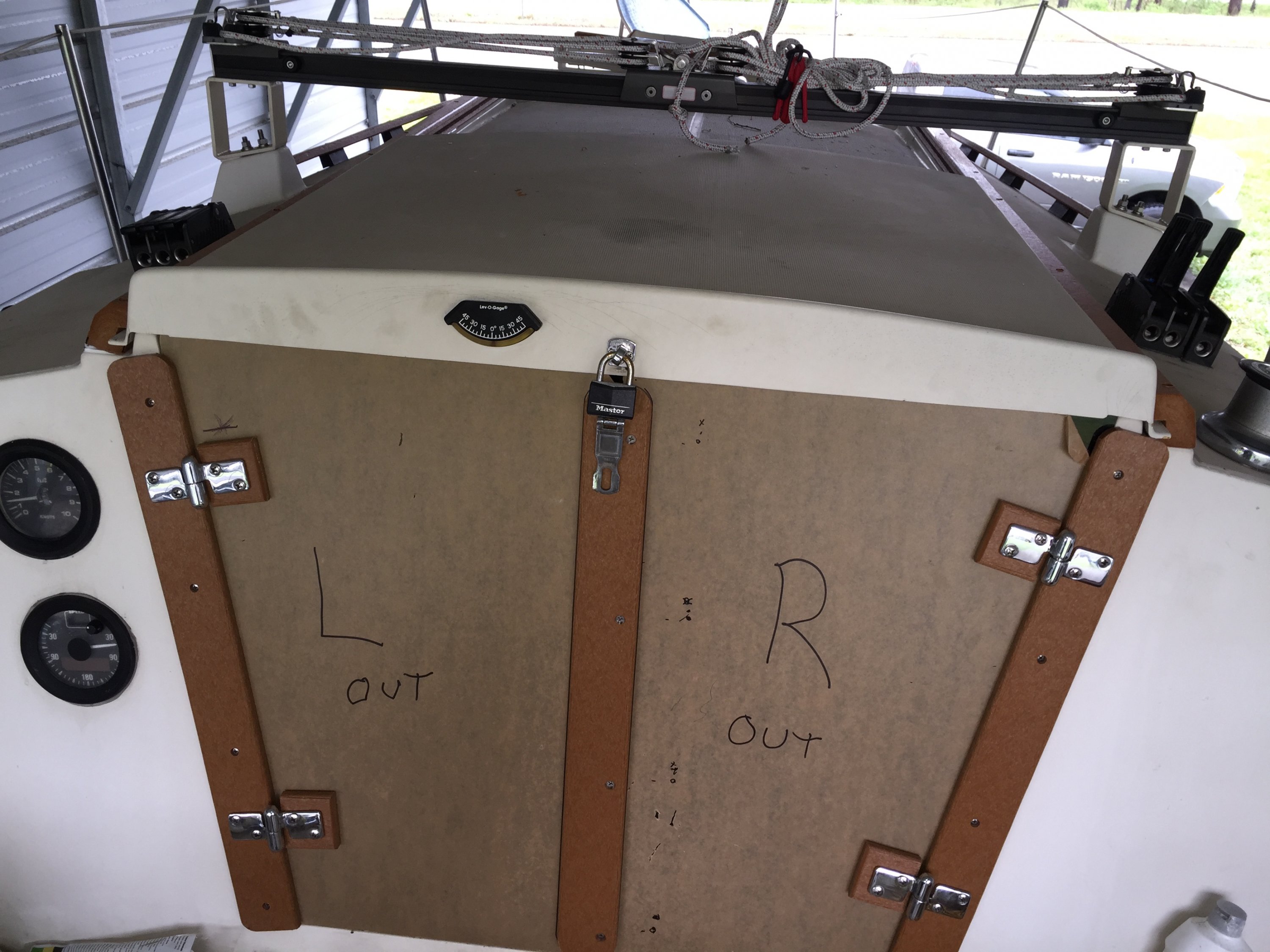

1/2" plexi swinging hatches with liftout hinges
1/2" plexi forward hatch
1/2" plexi skylight
1/2" plexi cockpit deadlight

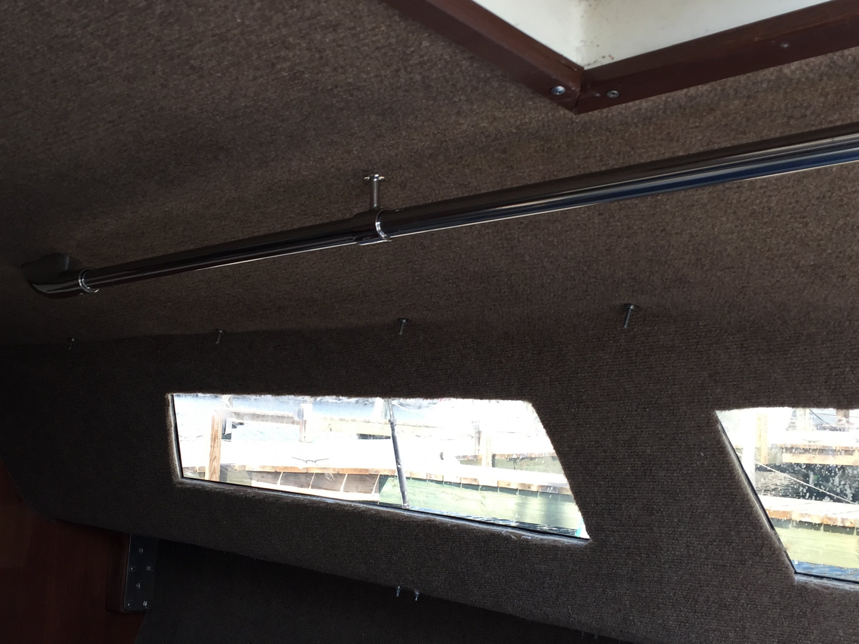

Carpet hull-liner
SS Saloon Handrails

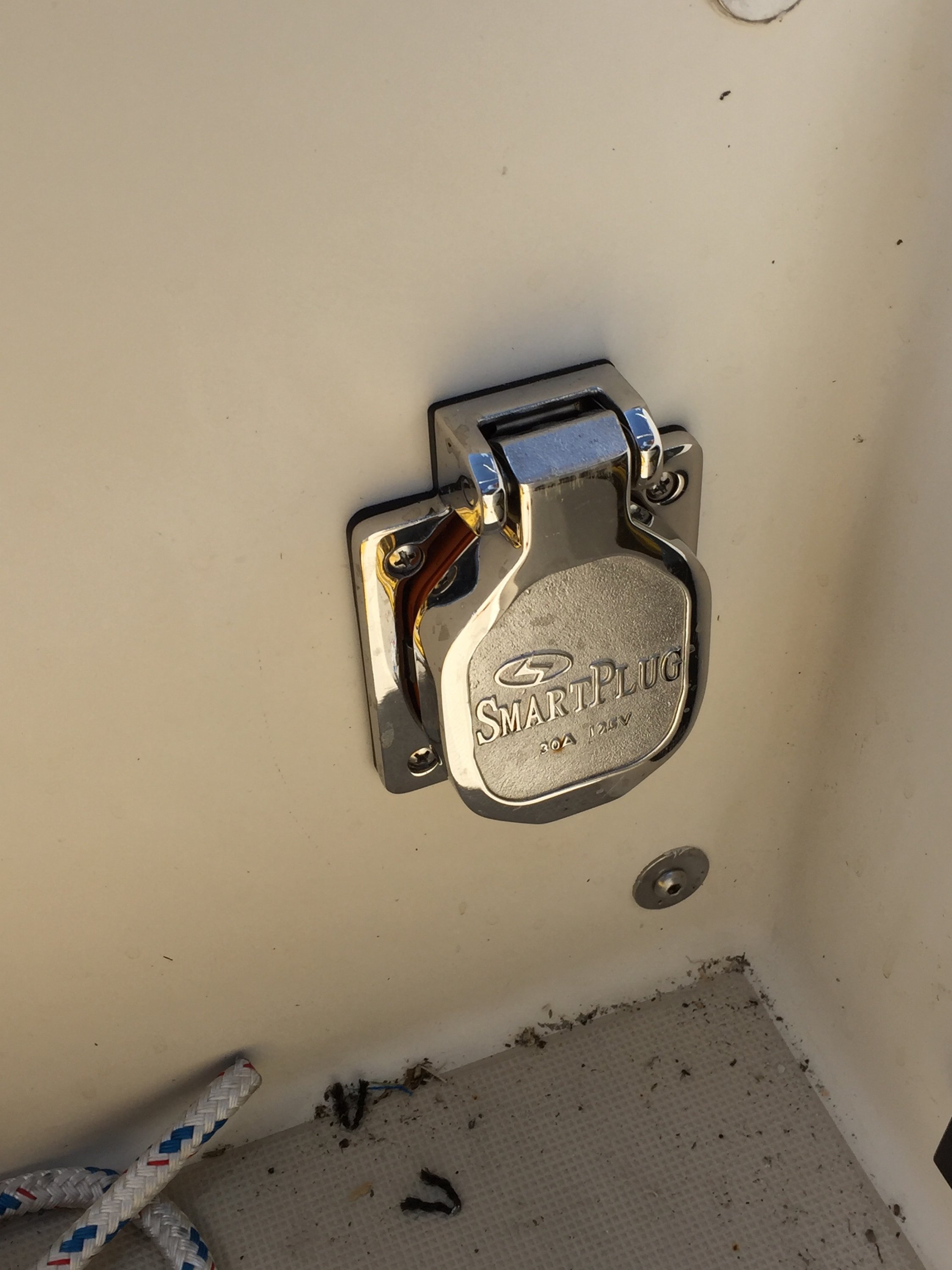

SmartPlug Shorepower inlet and cable

We are working hard to meet the launch date. The boat looks ransacked! The weather is too cool and rainy. Oddly, I don't want to powerwash, scrub, and wetsand the boat in the rain. Luckily, we have a shed for the boat. Tonight, I finished rebedding the bolts and pushing them though the carpet hull liner.

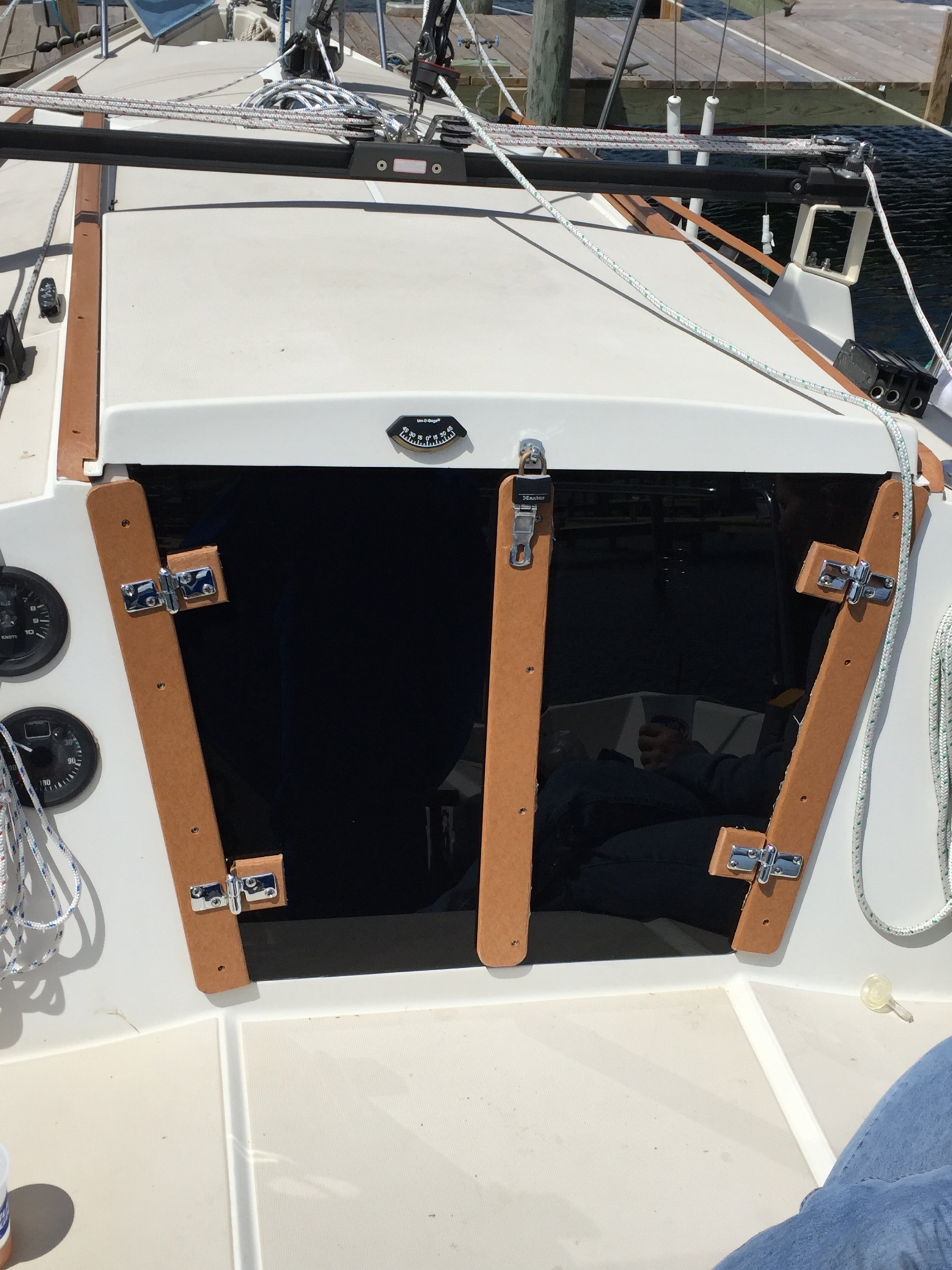

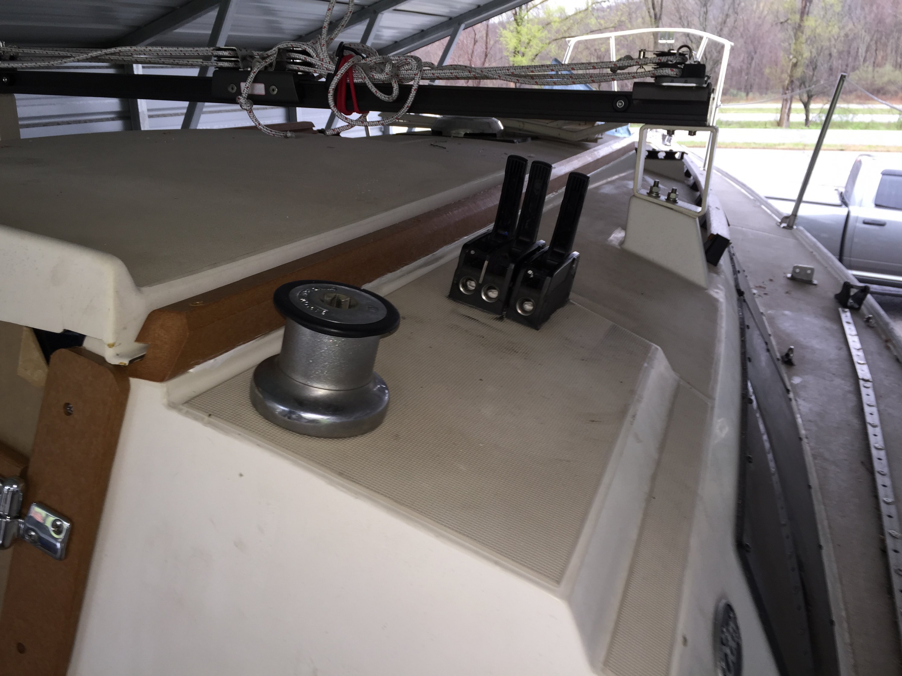

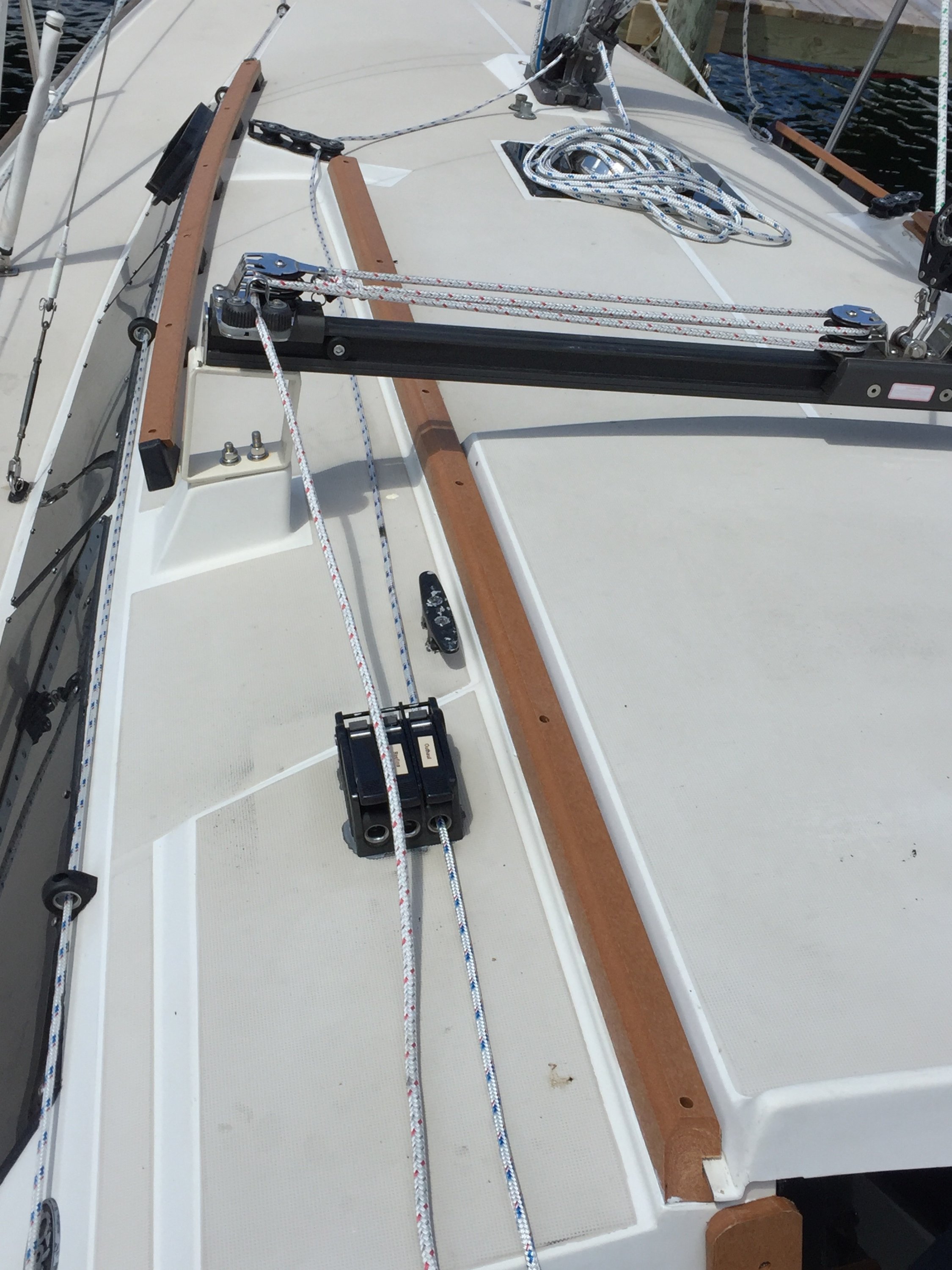

These are the hatch doors I made. That is the plasteak framing them. The sliders are plasteak now too

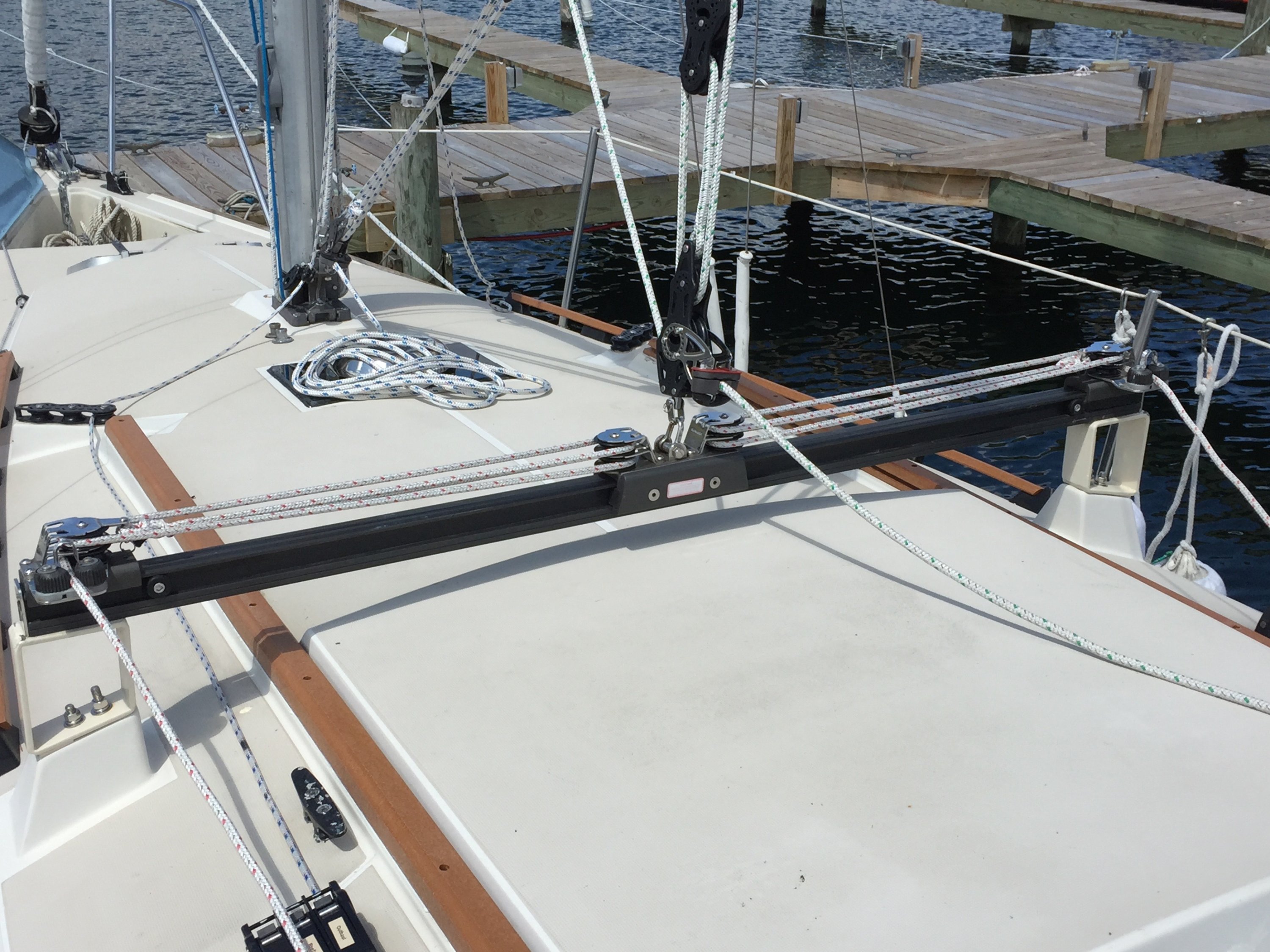

The flat traveler and risers can be seen too.
